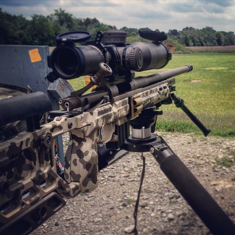

I have had the opportunity to shoot both the 50/50 and the 108/-8. I prefer the 108/-8. I personally felt that the 50/50 had a pressure spike in the bolt down movement, about mid-stroke. The 108/-8 is smooth the whole way, both on bolt open & bolt down. Bolt lift is a little bit stiffer than the 50/50, but at least 1/2 the effort is required to open the 108/-8 vs. a standard Remington 700. Bolt down, as the OP stated, literally almost pulls itself closed. With the action in a stock, and actually shooting the Mausingfield, the bolt lift is not even noticed.
Here are some pics for the enjoyment of the crowd..
[IMG2=JSON]{"alt":" photo IMG_3063_zpsf62718f9.jpg","data-align":"none","data-size":"full","src":"http:\/\/i864.photobucket.com\/albums\/ab203\/mmedearis509\/IMG_3063_zpsf62718f9.jpg"}[/IMG2] [IMG2=JSON]{"alt":" photo IMG_3066_zpscd3ecf47.jpg","data-align":"none","data-size":"full","src":"http:\/\/i864.photobucket.com\/albums\/ab203\/mmedearis509\/IMG_3066_zpscd3ecf47.jpg"}[/IMG2] [IMG2=JSON]{"alt":" photo IMG_3067_zpsc696986d.jpg","data-align":"none","data-size":"full","src":"http:\/\/i864.photobucket.com\/albums\/ab203\/mmedearis509\/IMG_3067_zpsc696986d.jpg"}[/IMG2] [IMG2=JSON]{"alt":" photo IMG_3182_zps0a404287.jpg","data-align":"none","data-size":"full","src":"http:\/\/i864.photobucket.com\/albums\/ab203\/mmedearis509\/IMG_3182_zps0a404287.jpg"}[/IMG2] [IMG2=JSON]{"alt":" photo IMG_3183a_zps8cd736b5.jpg","data-align":"none","data-size":"full","src":"http:\/\/i864.photobucket.com\/albums\/ab203\/mmedearis509\/IMG_3183a_zps8cd736b5.jpg"}[/IMG2]

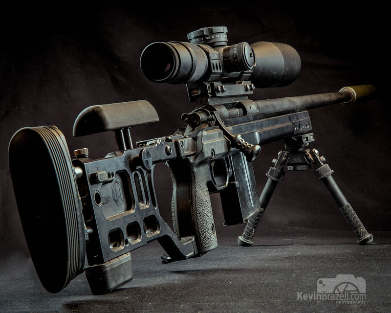

Got a couple teasers from my friends at Long Rifles Inc tonight.....I had to share them!!!! [IMG2=JSON]{"alt":" photo 10904530_772730959488331_1029697382951013141_o_zpsa197d61e.jpg","data-align":"none","data-size":"full","src":"http:\/\/i864.photobucket.com\/albums\/ab203\/mmedearis509\/10904530_772730959488331_1029697382951013141_o_zpsa197d61e.jpg"}[/IMG2] [IMG2=JSON]{"alt":" photo 10830424_772730786155015_6338054278978949390_o_zps6cac7f39.jpg","data-align":"none","data-size":"full","src":"http:\/\/i864.photobucket.com\/albums\/ab203\/mmedearis509\/10830424_772730786155015_6338054278978949390_o_zps6cac7f39.jpg"}[/IMG2] [IMG2=JSON]{"alt":" photo 10922297_772730769488350_3084802046981003756_o_zpsbaeaf449.jpg","data-align":"none","data-size":"full","src":"http:\/\/i864.photobucket.com\/albums\/ab203\/mmedearis509\/10922297_772730769488350_3084802046981003756_o_zpsbaeaf449.jpg"}[/IMG2] [IMG2=JSON]{"alt":" photo 1926017_772730779488349_9219050188913793674_o_zpsd0cc09a9.jpg","data-align":"none","data-size":"full","src":"http:\/\/i864.photobucket.com\/albums\/ab203\/mmedearis509\/1926017_772730779488349_9219050188913793674_o_zpsd0cc09a9.jpg"}[/IMG2] [IMG2=JSON]{"alt":" photo 1501369_772730792821681_9036010087124930523_o_zps663d360e.jpg","data-align":"none","data-size":"full","src":"http:\/\/i864.photobucket.com\/albums\/ab203\/mmedearis509\/1501369_772730792821681_9036010087124930523_o_zps663d360e.jpg"}[/IMG2]

They did an exceptional job on that! I can't wait to see how it turns out!

Mattchoo we are starting the final assembly. We'll post some more photos up here in a bit. She's a brute!

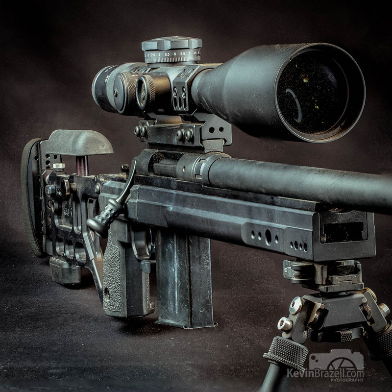

HOLY PHACK!! I really do not know what to say any more!! To say that I am impressed is an under statement......

That paint is next level Chad.

I agree, that paint is freakin awesome.

SHLowlight
X28 MONTHS
Premium Member
HMFIC/Commandant
Rating: 4.0/5 this site
3909 posts this site
Re: The Mausingfield
06/02/2015 Last edited 06/02/2015 by SHLowlight
I believe it will drop into most chassis, the only one that might be an issue that I know of it Cadex
Here is mine in an AT Chassis
I was waiting for a new AX Chassis but the rifle was ready, the AX Chassis were not so I went with an AT Chassis
Rate now:
b2948kevinXSergeant
Rating: 3.1/5 this site
185 posts this site
06/03/2015
Beauty. Very nicely done.
Forgot to mention - Ted at ARC is a standup guy. He took the time to talk to me on the phone for a couple hours before I purchased. Not many people that would do that.

DLC is 96+ Rockwell. It wears very well. It's a slick black finish similar to what graphite black or socom blue looks like. (especially if spiked with a pinch more catalyst). We've had several through the shop. It's really nice stuff.
Photo borrowed from our good friends at Tactical Supply up in Yakima, WA.

DLC'd M5s to me look like super rich black hot blueing. You get some interesting lighting effects on curved surfaces that give a sort of "rainbow" color spectrum. And they feel absolutely incredible.
Whenever I break down and buy another it will be DLC'd for sure.
This picture is a fair representation of what it looks like on the M5s I've handled.

[IMG2=JSON]{"alt":"Image and video hosting by TinyPic","data-align":"none","data-size":"full","src":"http:\/\/i58.tinypic.com\/35a9da1.jpg"}[/IMG2]
[IMG2=JSON]{"alt":"Image and video hosting by TinyPic","data-align":"none","data-size":"full","src":"http:\/\/i61.tinypic.com\/4nzvd.jpg"}[/IMG2]
[IMG2=JSON]{"alt":"Image and video hosting by TinyPic","data-align":"none","data-size":"full","src":"http:\/\/i61.tinypic.com\/4nzvd.jpg"}[/IMG2]​
My SAC 6.5CM DLC Mausingfield works perfect in IMB Sentinel, that action feeds amazing!
Thanks for helping with pics KlownPuncher!

fasteddie2XPrivate
Rating: 0.0/5 this site
6 posts this site
07/04/2015
That is a work of art!
Questions:
  1. What bottom metal is that?
  2. Rings?
  3. Where can I obtain that specific cheek pad?
Sincere thanks!
Questions:
  2. Rings?
Sincere thanks!​
Thanks, I'm very happy with entire rifle.
1: KMW BM that comes with Sentinel Stock
2: NF UL 6screw
3: Weibad cheek pad, just select which stock you have when purchasing

Any pics of the bolt release side?
Coltsters wrote:
Questions:
  2. Rings?
Sincere thanks!​
2: NF UL 6screw
3: Weibad cheek pad, just select which stock you have when purchasing​
2: NF UL 6screw
Rate now:
kissmy300blkbrass
XSergeant
Rating: 2.6/5 this site
234 posts this site
07/04/2015
Sweet thanks looks good
Any pics of the bolt release side?​

Prairie Dog Town in MT couple weeks ago was a TON of fun, shot about 120rds ranges from 300-600+ yds with big wind changes made it pretty challenging on those little buggers but still managed to score quite a few hits. Gun ran like a champ!

Pics of the fantastic Mousingfield action in the new Benchmark Barrels stock manufactured by RTAC Precision

Hey thanks Harry, here are some pics. The two tone cerakot looks great with the AI stock.
[IMG2=JSON]{"alt":" photo FullSizeRender-5_zpsp6jkah2n.jpg","data-align":"none","data-size":"full","src":"http:\/\/i375.photobucket.com\/albums\/oo196\/blbrand16\/FullSizeRender-5_zpsp6jkah2n.jpg"}[/IMG2]
[IMG2=JSON]{"alt":" photo FullSizeRender-6_zpsmdbmemjn.jpg","data-align":"none","data-size":"full","src":"http:\/\/i375.photobucket.com\/albums\/oo196\/blbrand16\/FullSizeRender-6_zpsmdbmemjn.jpg"}[/IMG2]
And guys don't let Harry fool you, that fella knows how to shoot.

This thread needs some new pics. I finally got mine out in the sun for some shooting. Love this action LRI really killed it!!!!
Rate now:
Badger30sXFirst Sergeant
Rating: 3.6/5 this site
2601 posts this site
09/20/2015
Holy high cheek piece! rifle looks good though
Rate now:
JMcE42
XPrivate
Rating: 3.0/5 this site
40 posts this site
09/20/2015
Badger30s wrote:
Holy high cheek piece! rifle looks good though​
Yea i know it looks funny but I lower it at all I feel like I have to hover my head in order to see thru the scope. I have the high rings because I plan on getting a XLR carbon eventually, and didn't want to have to buy rings twice haha.

b2948kevinXSergeant
185 posts this site
10/04/2015
[/img]
Specs:
Action - American Rifle Company Mausingfield Short Action with DLC coating
Barrel - 26" Shilen Select Match 4 groove ratchet rifled, chambered with a custom 6XC reamer designed to shoot the 105gr Berger Hybrid bullet
Stock- KRG Whiskey 3 folding
Scope - US Optics ER-25
Scope Mount - Spuhr ISRM
Suppressor - Thunder Beast 30p-1
Bipod - Atlas
Trigger - Huber 2 Staged Break tuned to 2lbs (still on order, will take another couple weeks)

Some has asked for pics, so here's our latest. We have 3x MF full builds that were wrapping up today. This is the first.
LRI CR Mod-0 Mk-1 in 6.5mm Creedmoor.

Mausingfield short action in .308 with K&P M24 contour barrel, 20" 1/10, cerakoted in graphite black, work done by Chad at Longrifles
Surefire SOCOM MB in 7.62
JAE-700 chassis (fits like a glove)
Jewel trigger
Vortex Razor HD, 5-20x50 MOA, in a Spuhr mount
Atlas bipod with LaRue QD mount
Monopod
AICS mag
I might trade out the Spuhr for some lower Seekins rings

Took a cool pic at the range.

Just bolted together my Mausingfield build after many months of gathering and fitting parts:
-Mausingfield action DLC’d at Club Custom
-Hawk Hill Rem Varmint chambered 6.5 x 47 Lapua/cut to Savage prefit by Matthew Pederson at Pederson Precision
-APA Gen II Lil Bastard
-Mirage ULR chassis
-Timney 2 stage, straight trigger
-Kahles 624i with SKMR3 reticle and LSW
-ARC x-high rings
Threw together some quick rounds with unfired Lapua brass, 130 Berger hybrids, took three shots to sight in and next five rounds went into this group at 100yds. Pretty happy with that start and now ready to develop a load and gather dope!

Nice. Is that adjustable cheek piece pretty solid?
Rate now:
Bigsur1XPrivate
42 posts this site
07/15/2016
Yeah, haven't detected any movement with only a light twist on the locking knob.
The monopod slider thing seems like it will be pretty handy but slides a bit unless you really crank the wheel. Might need to roughen the sliding surface a bit.

Here is a beautiful Mausingfield/ Cadex Defence build, built by Chad Dixon from LRI. This was a prize rifle for the Breakneck PRS shoot. Chad and LRI team do amazing work.

Here is my Mausingfield in 6XC. Awesome product.
