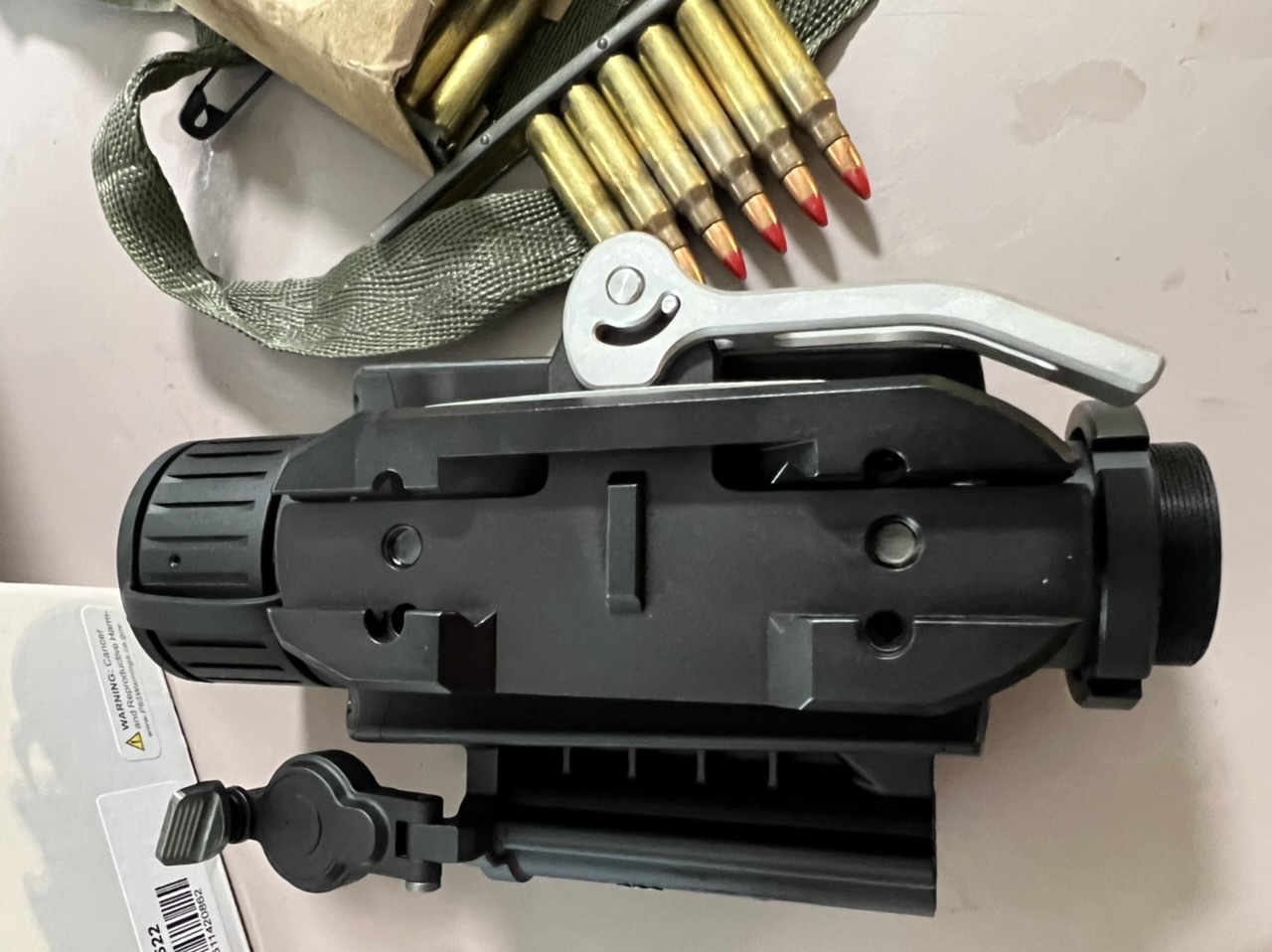

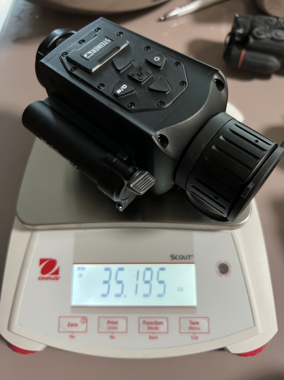

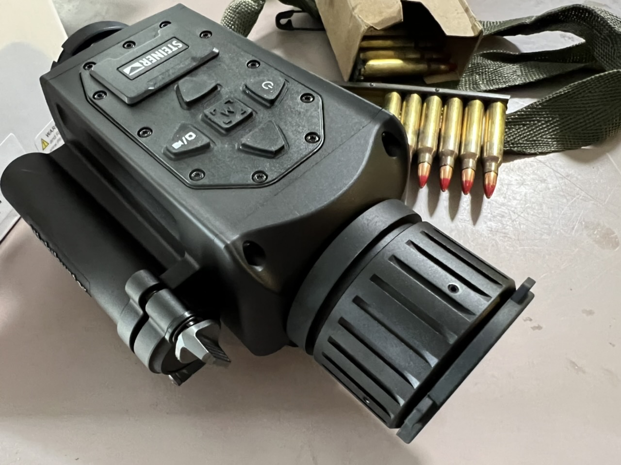

    First, the C35 is a fricking Brick House! At over 35-ounces with battery installed, it’s the heaviest consumer thermal I own. It’s big and bulky compared to its competitors as well. I don’t own any Yoter/Bering stuff, so I can’t compare with their units.
    Second, the battery is a funky 18650 “B”. You can NOT use a standard 18650. It won’t fit. One is included, but you’ll need to get more or — use an external Anker-style USB pack.
    The rail mount is a monster and the QD throw lever is a boat paddle.
    I’ve looked all over the unit itself, the packaging, and the documentation and I can’t, for the life of me, figure out where this thing is made. Someone help me out here… WHERE IS THIS DAMN THING MADE?!

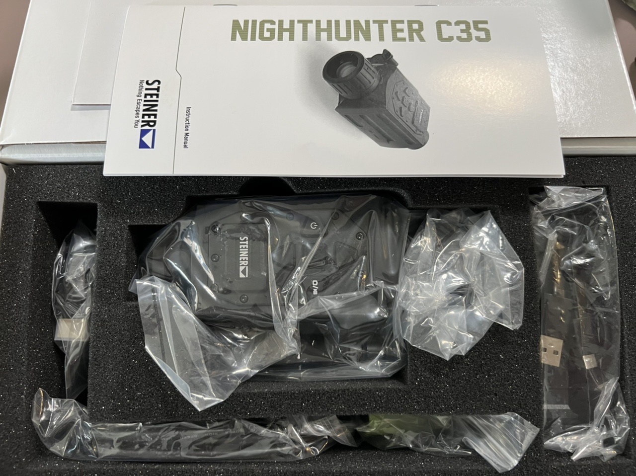

    Initial presentation:

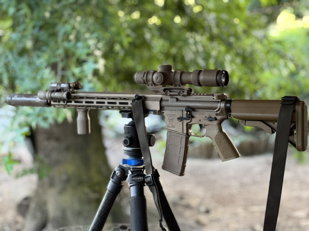

    The Razor 1-10x is in a 1.57” Scalarworks mount, so the C35 looks to be designed for a 1.5” optic.

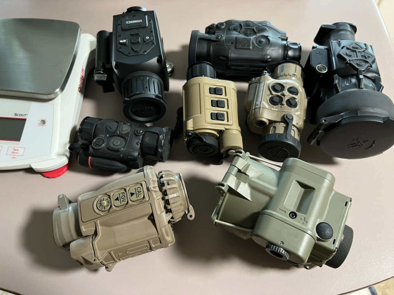

    “The Crew” of comparison thermals:
    The Testbed — Geissele SOCOM SD, Razor G3 1-10x in Scalarworks, other meaningless trinkets. Will be testing the C35 for POI shift on multiple guns/optics pairs.
    Pre-fight contender weigh-in: First, the Heavyweight! Steiner C35:

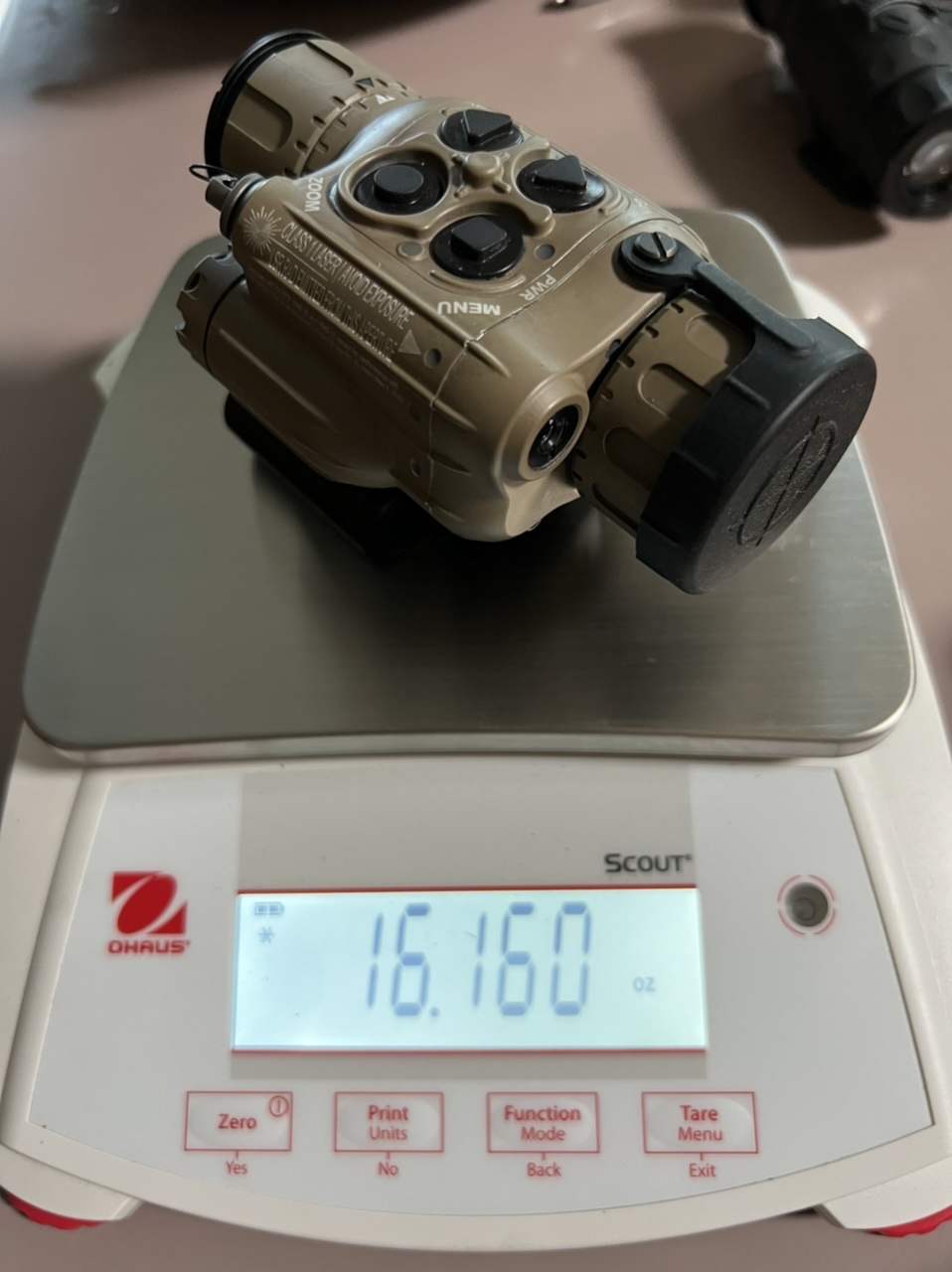

    Next, the longtime Reigning World Clip-on Champion! BAE/Oasys/Trijicon UTC-Xii:
    The reigning Middleweight Champion of the World! BAE/Oasys/Trijicon UTM-x:
    The recently-dethroned lightweight World Champion! BAE/Oasys/Trijicon SkeetIR-x!
    The NEW Lightweight Champion of the World! Pixels on Target (PoT) Voodoo-S!
    The Slant-eyed Lightweight Contender from Chynah! The iRay USA RH-25 Choodoo:
    Ze German contender from ze Fatherland, the Andres Industries TigIR-6M!
    And last but not least, a lightweight contender from Planet Unobtanium! The BAE FWS-i:

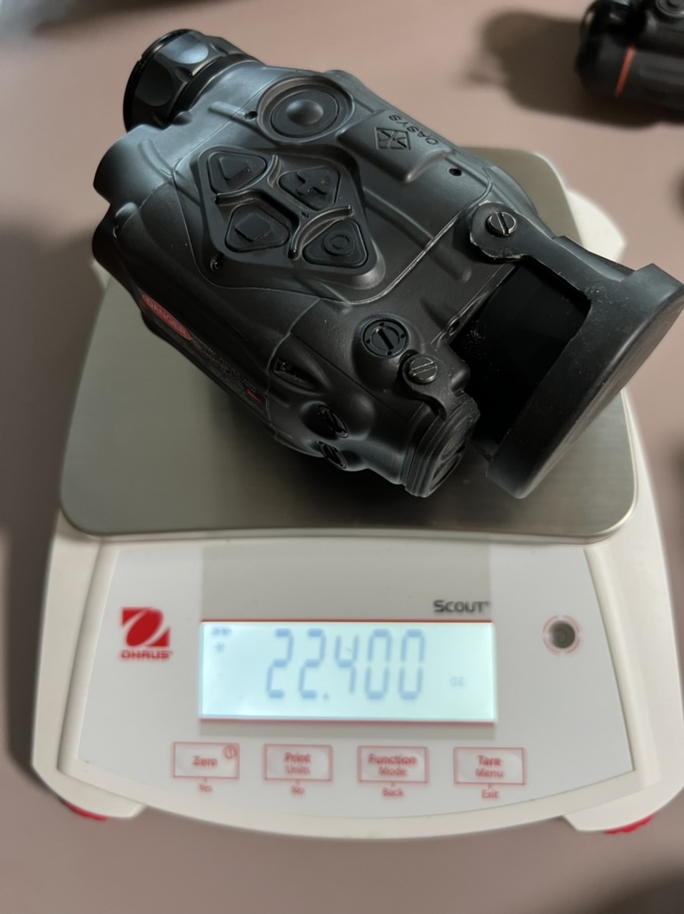

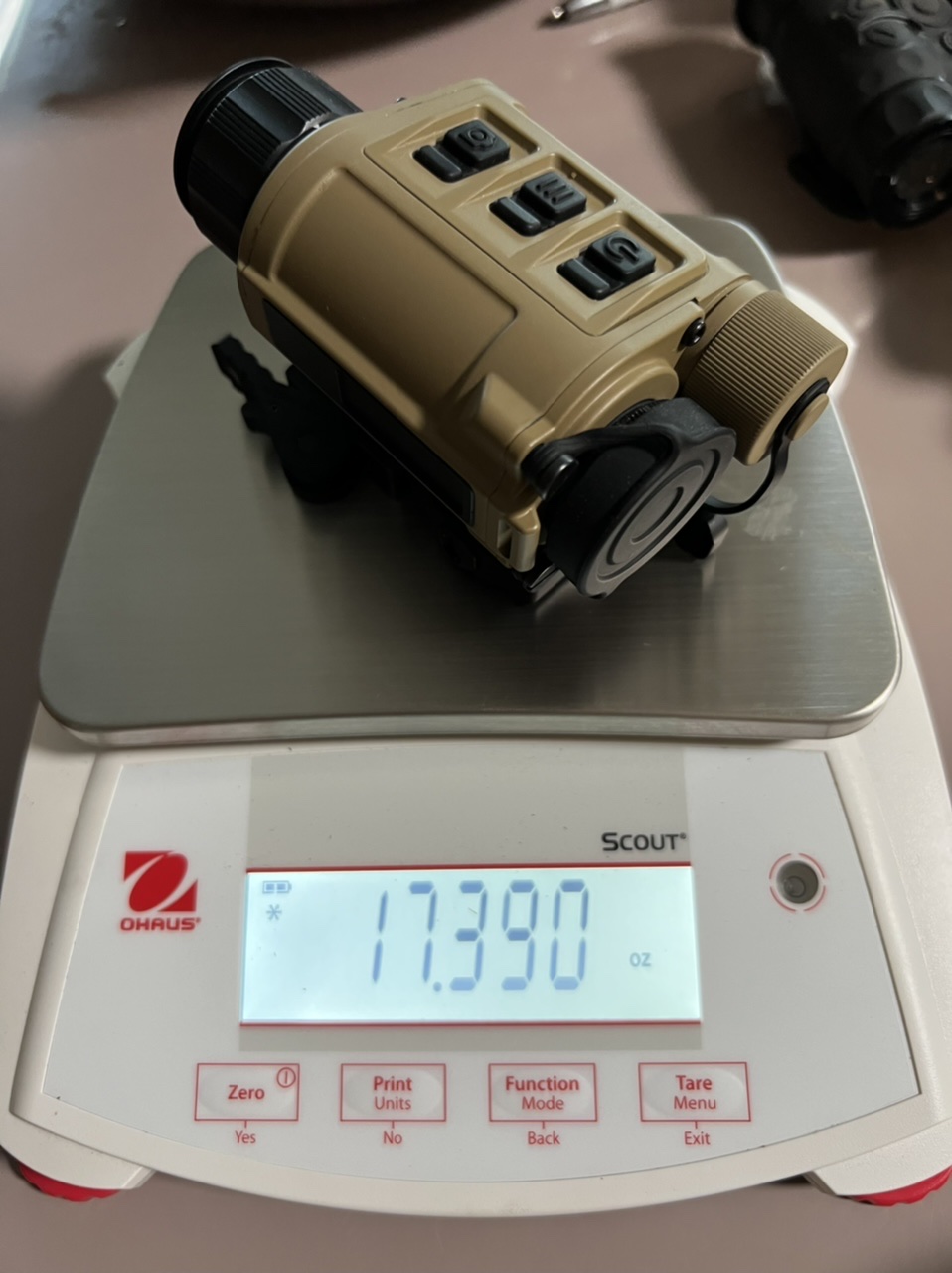

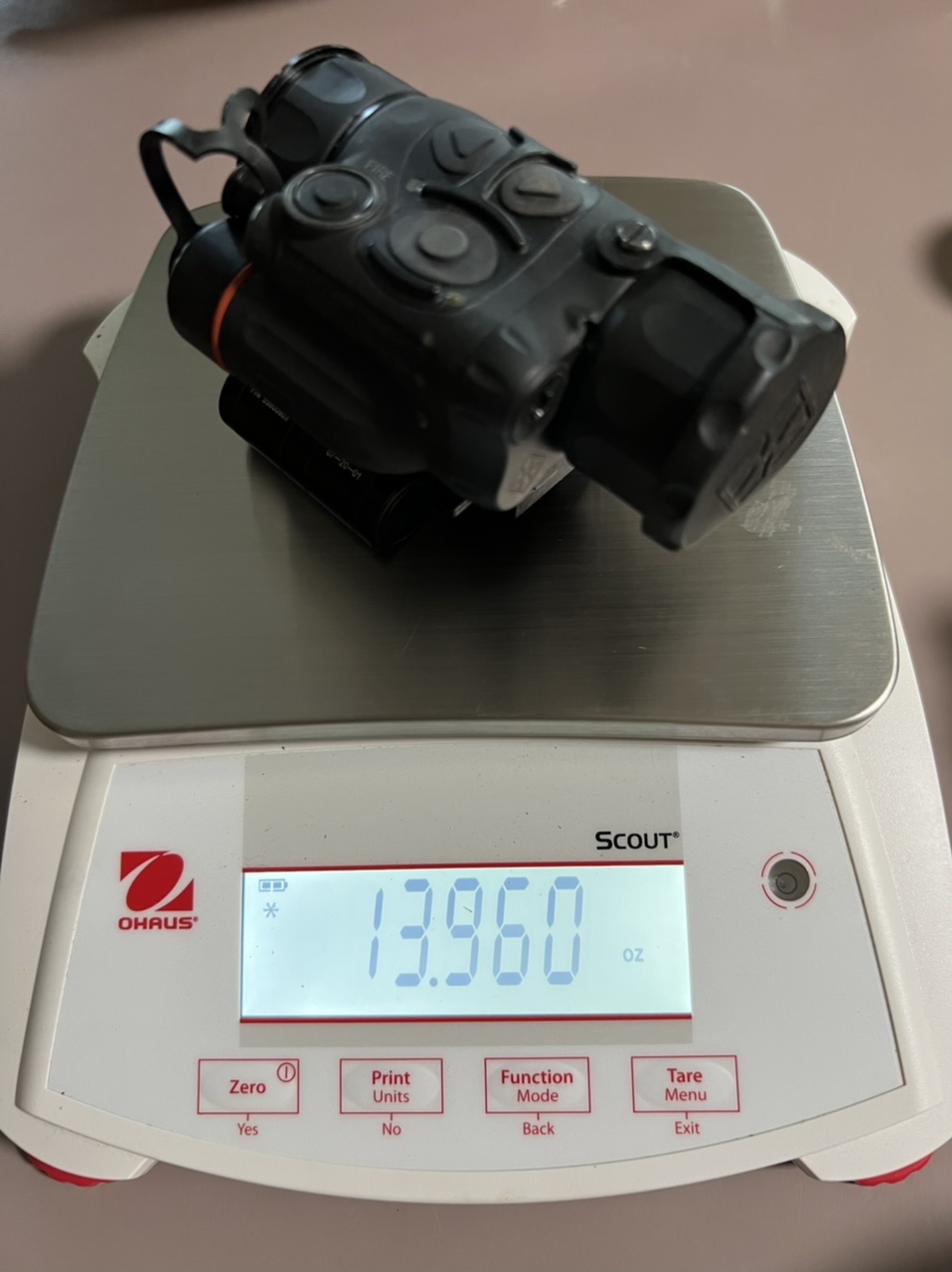

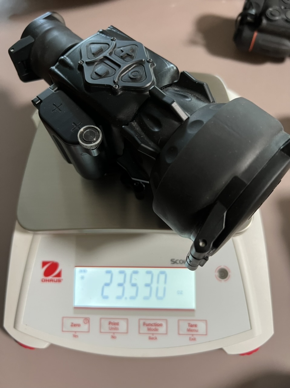

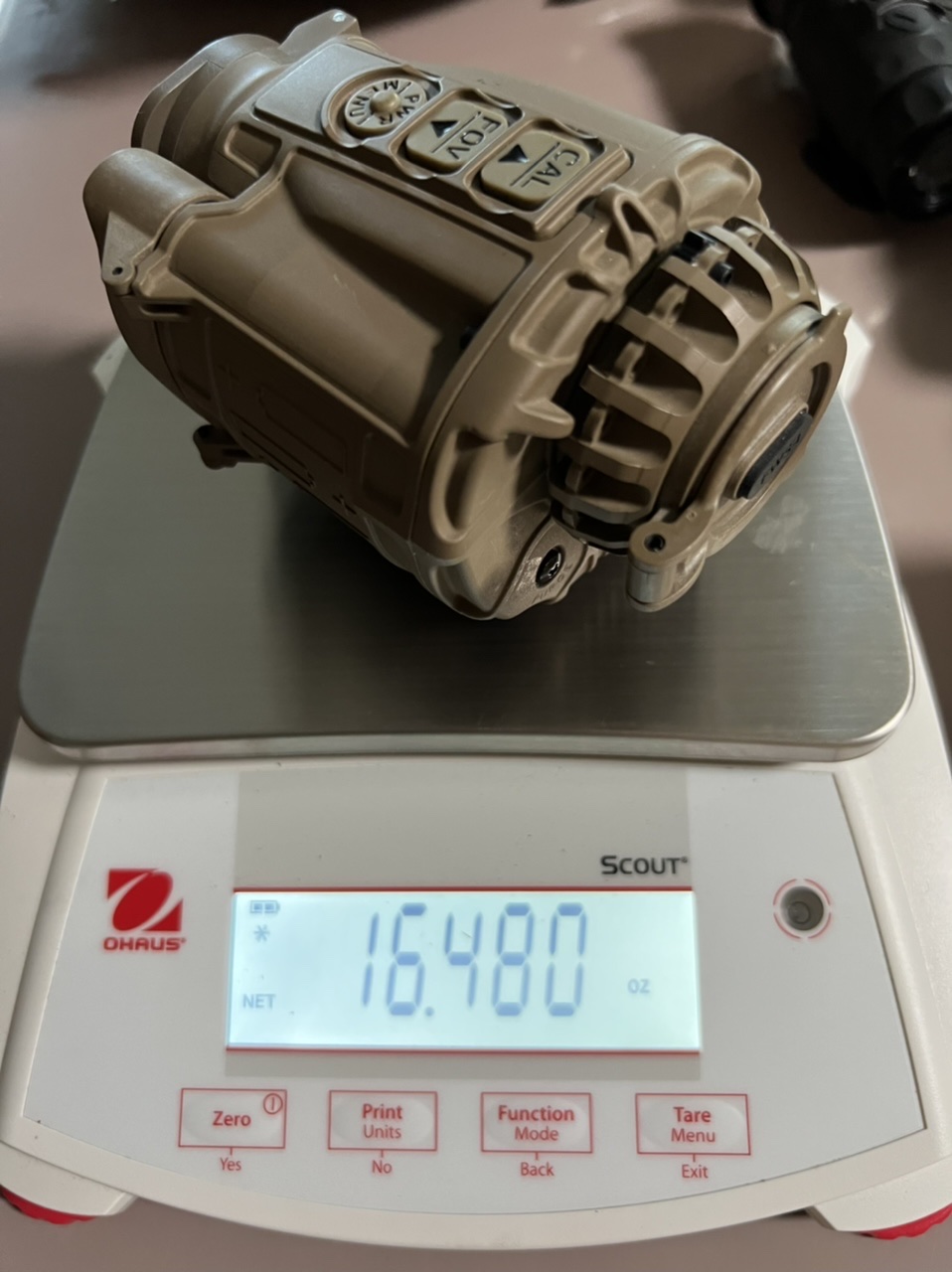

    ALL units were weighed in full USABLE form — meaning batteries were installed and their rail mounts were on.

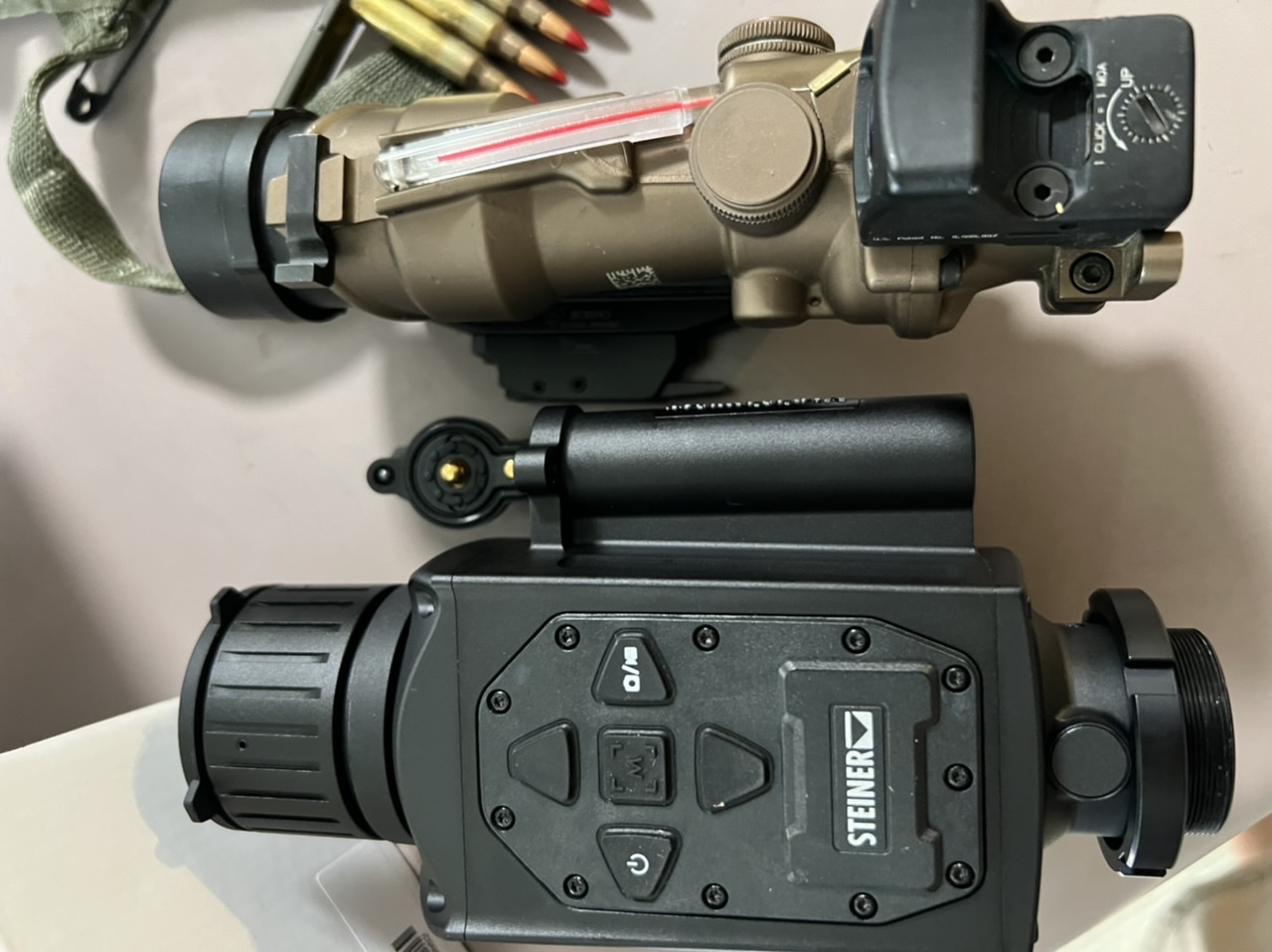

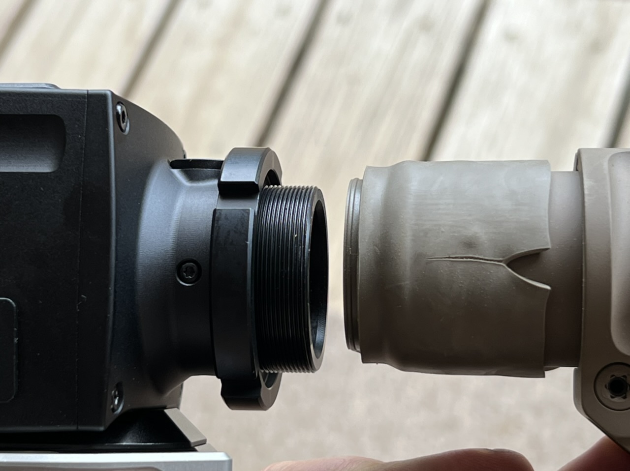

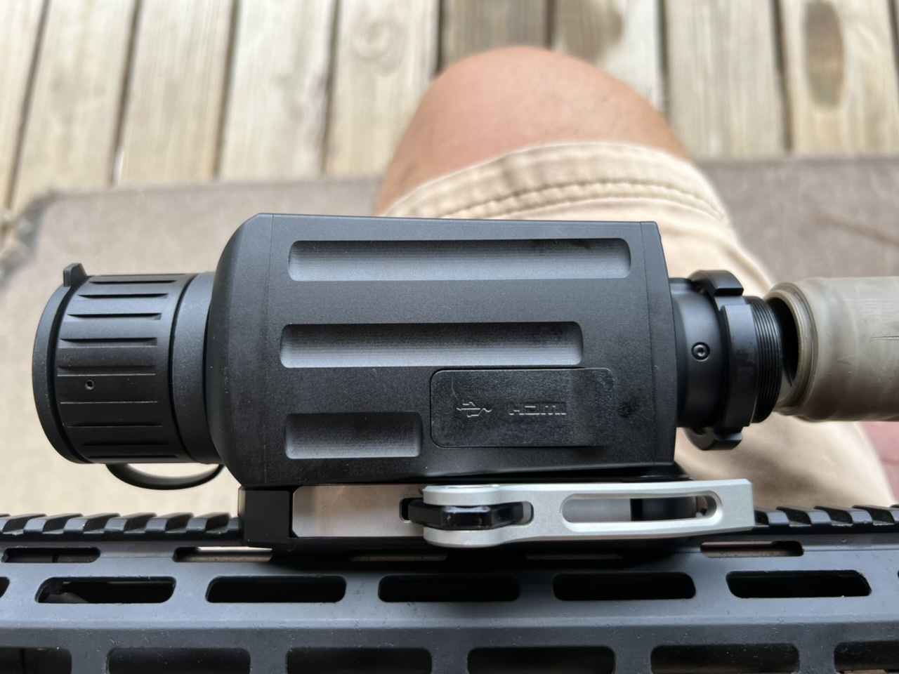

    After just a few minutes of very preliminary comparison, the C35 makes a better clip-on than the RH25 Choodoo. Overall, if I had to choose between the C35 ($4K) and the RH25 ($6K) — forgetting the Chynah DNA for a moment — I’d probably still take the Choodoo, unless I *only* intended to use it as a dedicated clipon, then the C35 performs better at higher optical magnifications.
    The Choodoo dies at 6x. The C35 is fully usable at 10x on the Vortex.
    With that said, I couldn’t help but compare the C35 with the UTC-Xii.
    No comparison. The UTC is still the King.
    Of course… $4K vs. >$20K…

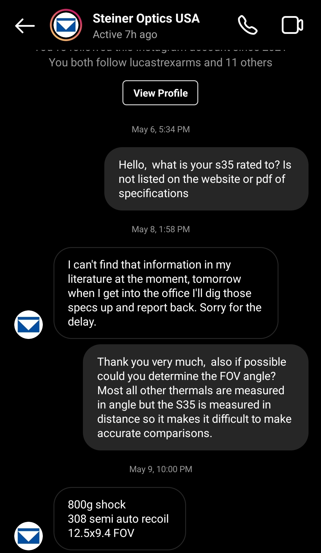

    I was looking at the spec sheets for both the c35 and s35 and they look nearly identical sans the c35 has a slightly lower res screen (800x600), takes only a single battery and s35 has reticles, but they both still has the same sensor, frame rate, 1-8 mag, etc.
    I know this is commonly asked but is there a significant benefit over the s35 vs c35 considering they seem to have the same exact guts? For example in LPVO usage which it seems like the c35 is geared towards is there a big reason why one would want one over the over? I suppose in my mind I see the s35 as almost a replacement for an lpvo since it can be used all weather whereas the c35 is an enhancement to be used on an lpvo. Apologies if this is a dumb question, dipping my feet into thermals and looking for something to stick on my DDC super duty (exactly what you're using as well 🤣). My S35 will be replacing the Delta Stryker in this instance and I'll probably throw some kind of laser (D2 or A3) for use with NV as well.
    It’s been requested by others in a couple threads without an answer so I’ll throw it here…

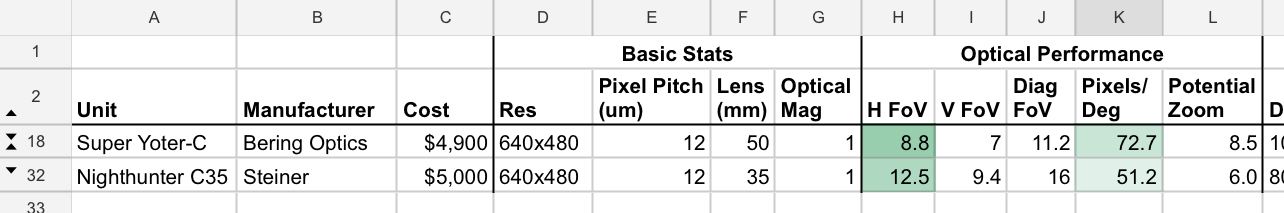

    Anyone have a comparison to the Yoter C?
    What’s advertised: 35 oz vs 20, 2 yr warranty vs 5, has WiFi and video 16GB vs none, FOV 12.5 x 9.4 vs 8.8 x 7.0 degrees, 800 x 600 OLED vs 1024 x 768 OLED, 1-8x vs 1,2,4x digital zoom, 18s vs 5s boot up time to list a few.
    What’s advertised: 35 oz vs 20, 2 yr warranty vs 5, has WiFi and video 16GB vs none, FOV 12.5 x 9.4 m vs 8.8 x 7.0 degrees (would appreciate a conversion to degrees on the C35 if someone knows), 800 x 600 OLED vs 1024 x 768 OLED, 1-8x vs 1,2,4x digital zoom, 18s vs 5s boot up time to list a few.
    A few of your numbers aren’t quite right there, but the 12.5 is a degrees value. Steiner marketing materials are a bit confused on that.

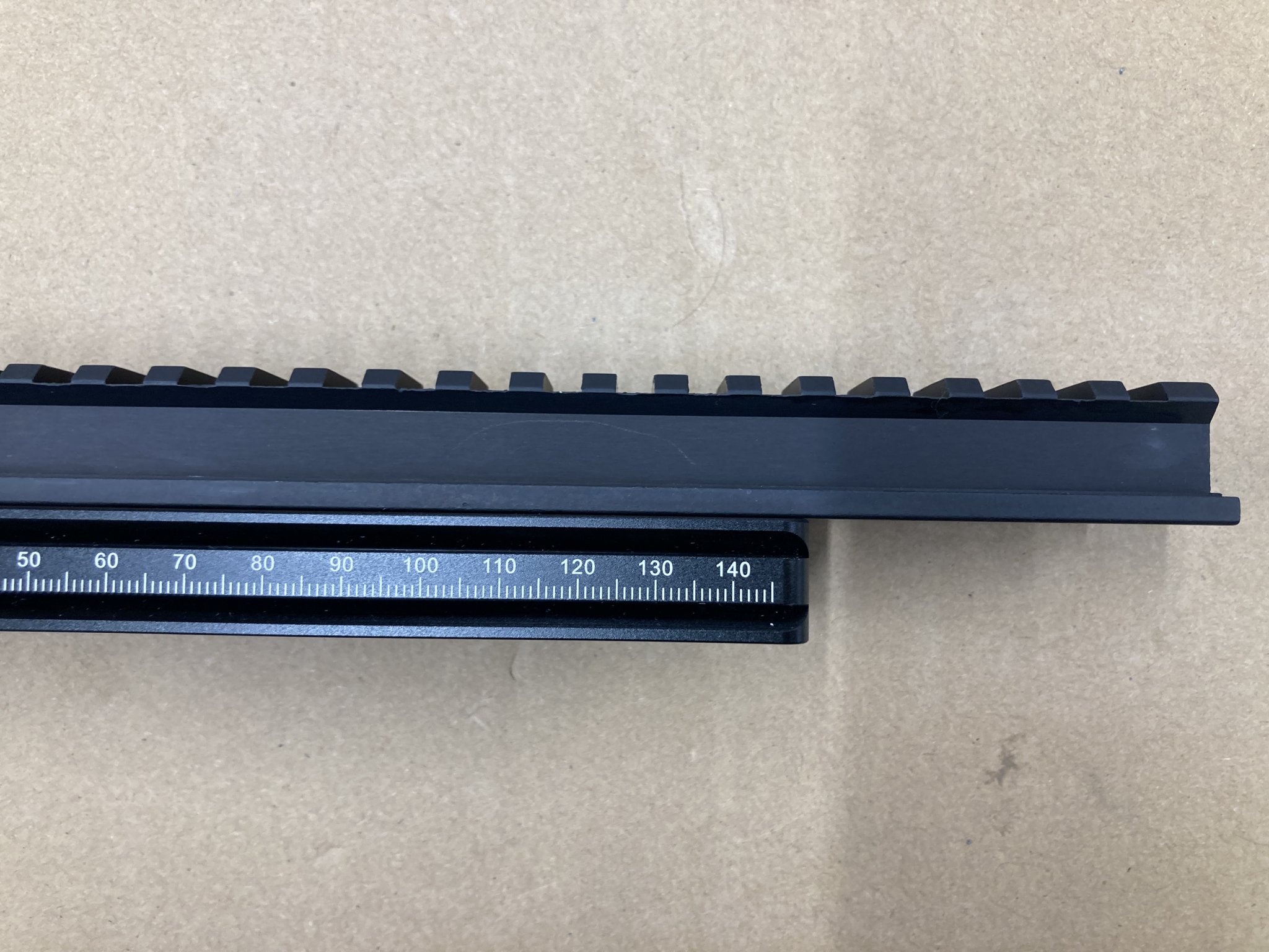

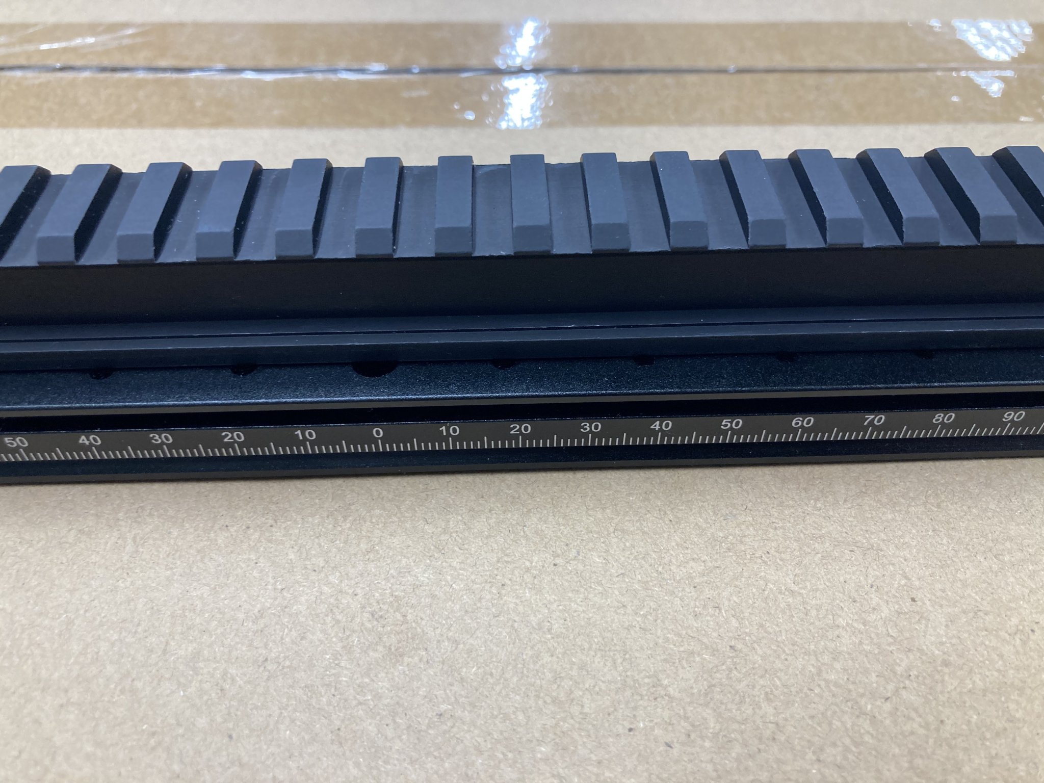

    Anyone know of a good rail system to test clip ons with room for a scope so I don't have to use my rifle, my neighbors don't appreciate me aiming my unloaded AR-10 at my cat in the front yard.
    Big ol lengths of pic rail are pretty easy to find and drill holes for tripod mounts or arca adapters. Or just put a block of metal on the bottom that you can clamp into a vise.

    Mostly just the lens sizes and the FoV. Yoter isn’t a 20mm piece of germanium.
    That unit of measurement after those numbers is oz. It’s definitely a 50mm objective, which I didn’t list.
