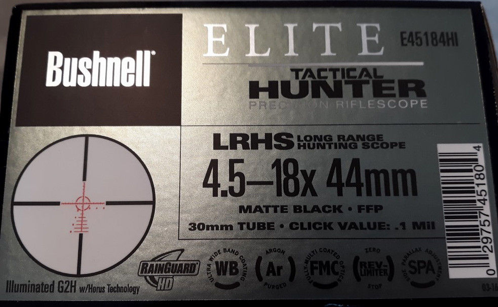

Is this not close enough? 4.5-14x50mm, FFP, MIL, 30mm
Or this:
Or this:
You're right, it does check the majority of the boxes (low mag is too high), but daaang, that thing is ugly!
These are both really good for the price point. I grabbed a few of the LRHS before they sold out.
I just now am putting together a hunting rifle, and really like the LRHS, specifically the G2H reticle. Are these actually unobtanium now?
