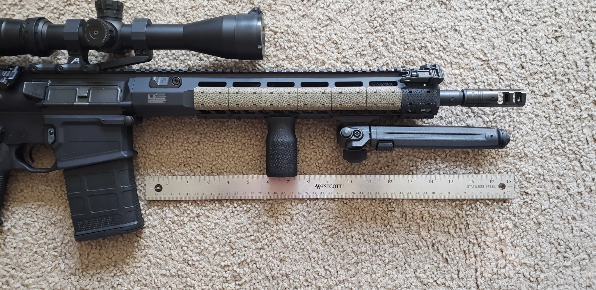

This is my first AR-308/AR-10 type rifle and so far it has been reliable, accurate and fun to shoot. Build quality and finish are top teir. Online reviews and reports have confirmed the 716I is a quality shooter. Some owners and reviewers have suggested it is capable of running with the big names in the AR-308/ AR-10 pack. It is a serious best buy for the amount of features you get for its low price. It is also a frontline battle rifle with over 144,000 units currently issued by India to its Soldiers along the Line of Control with China and Pakistan.
This is definitely not an entry level rifle, but is it a top teir battle rifle?

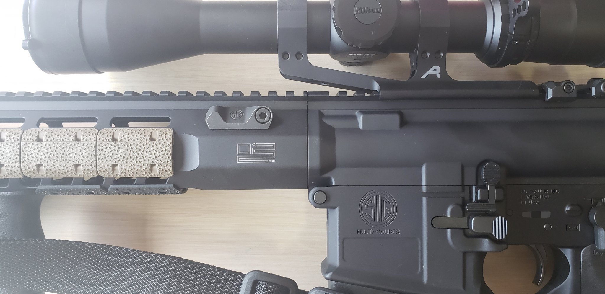

I'd be interested in seeing photos or the handguard removed so that we can see how the handguard and upper receiver interface with each other and the barrel nut design.
Later tonight or tomorrow I'll post some up. Anything else you may want to see?

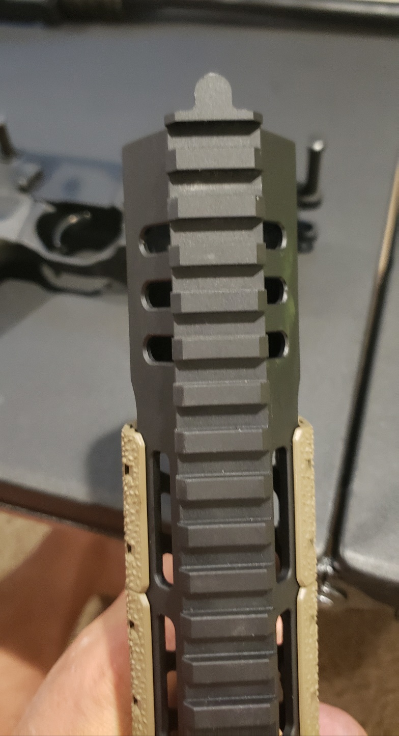

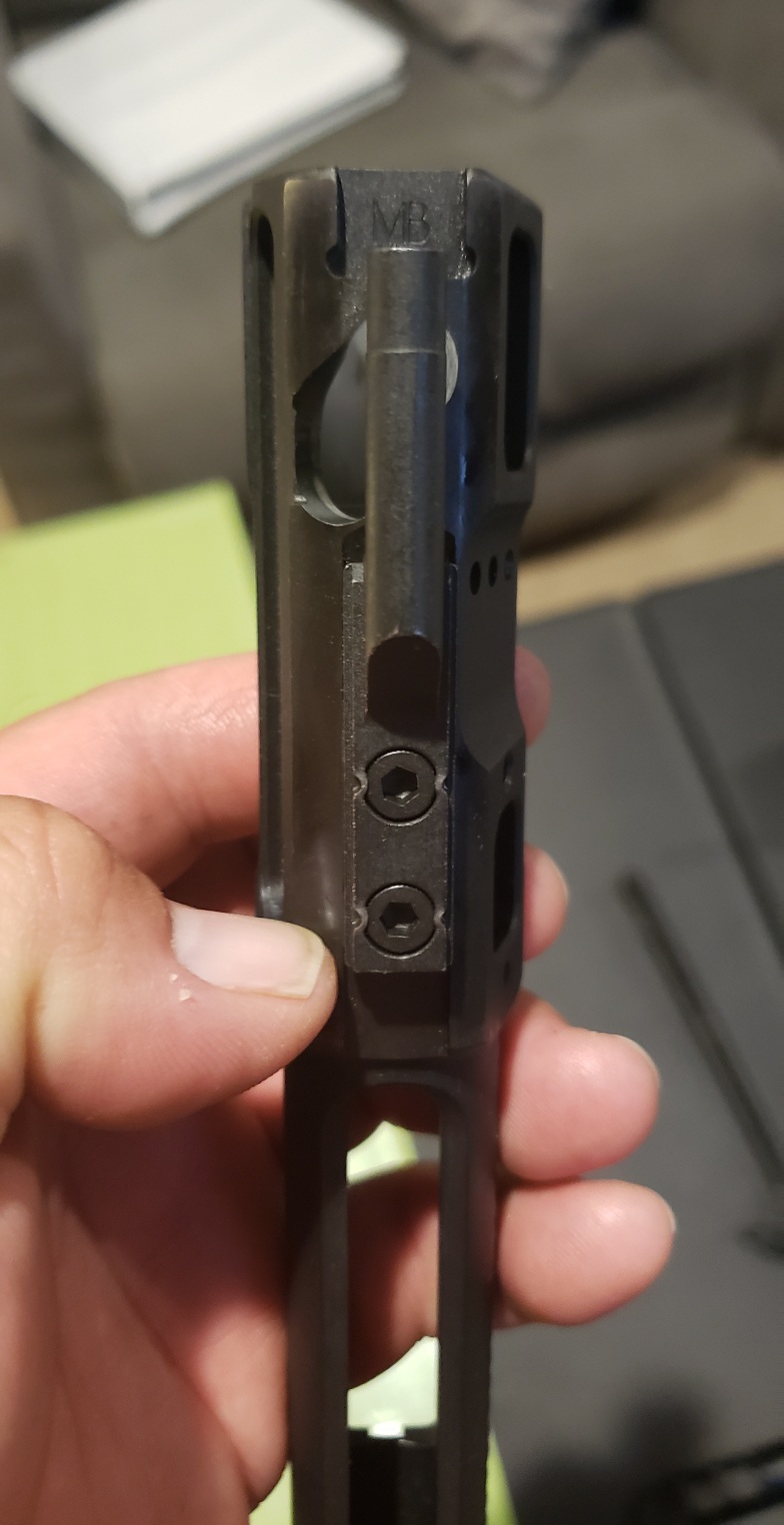

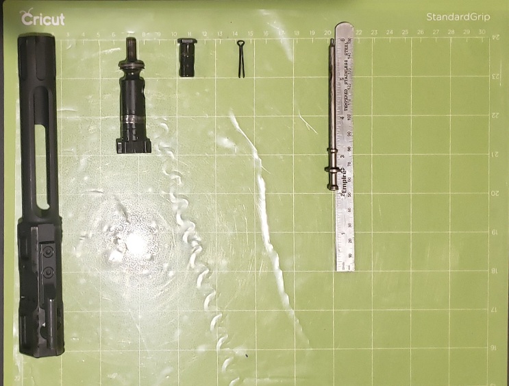

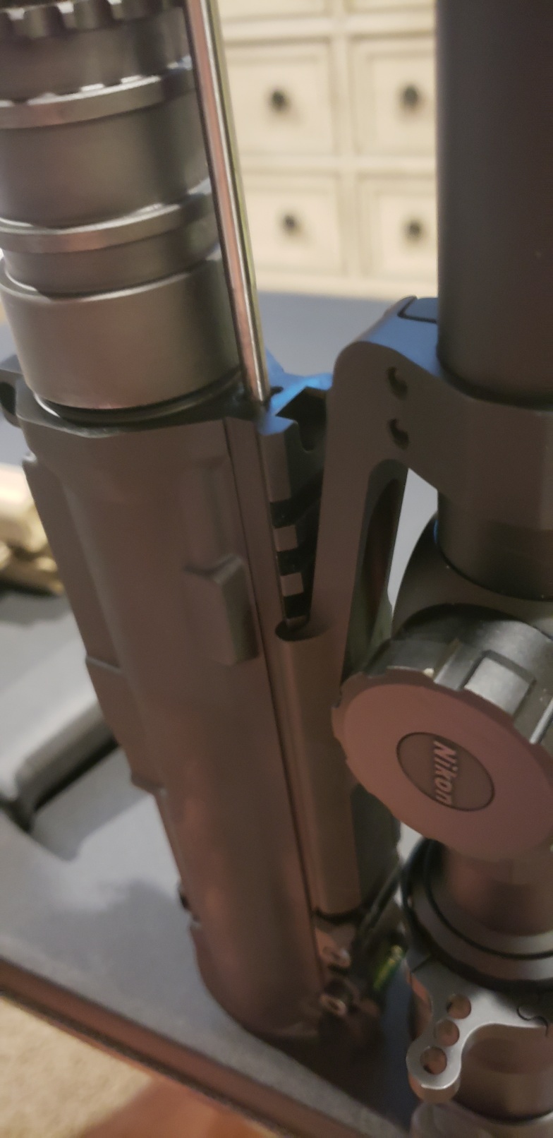

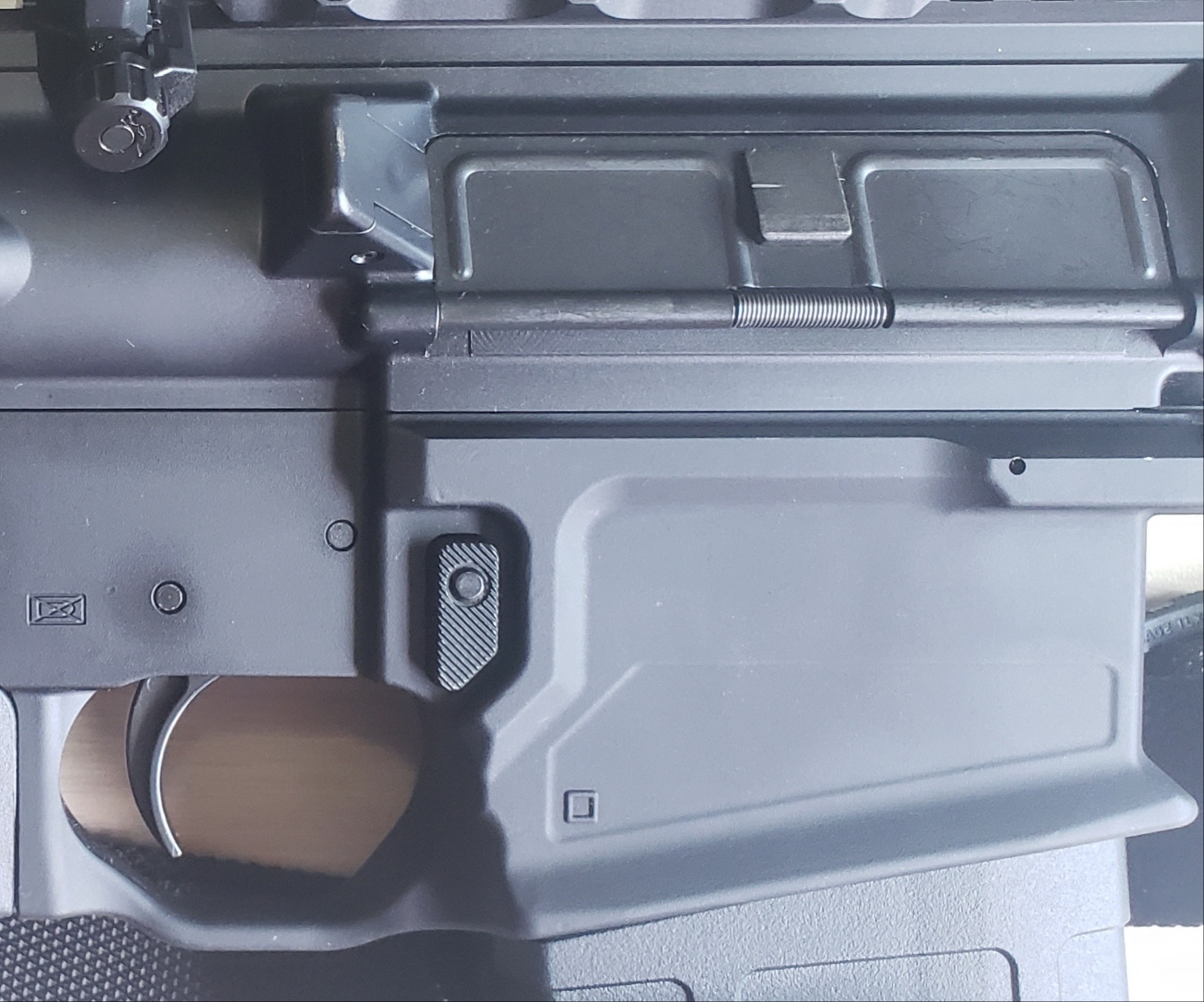

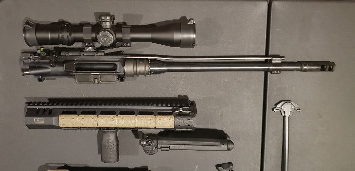

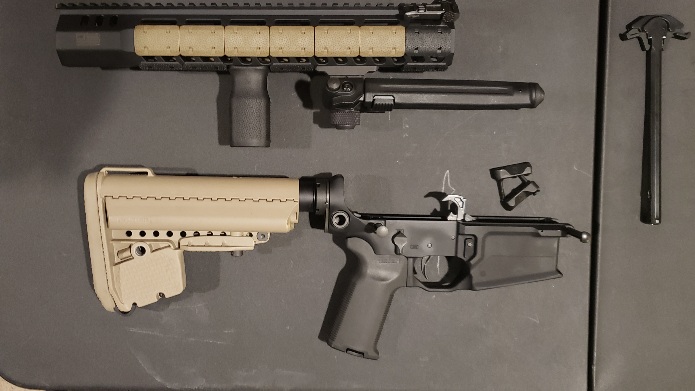

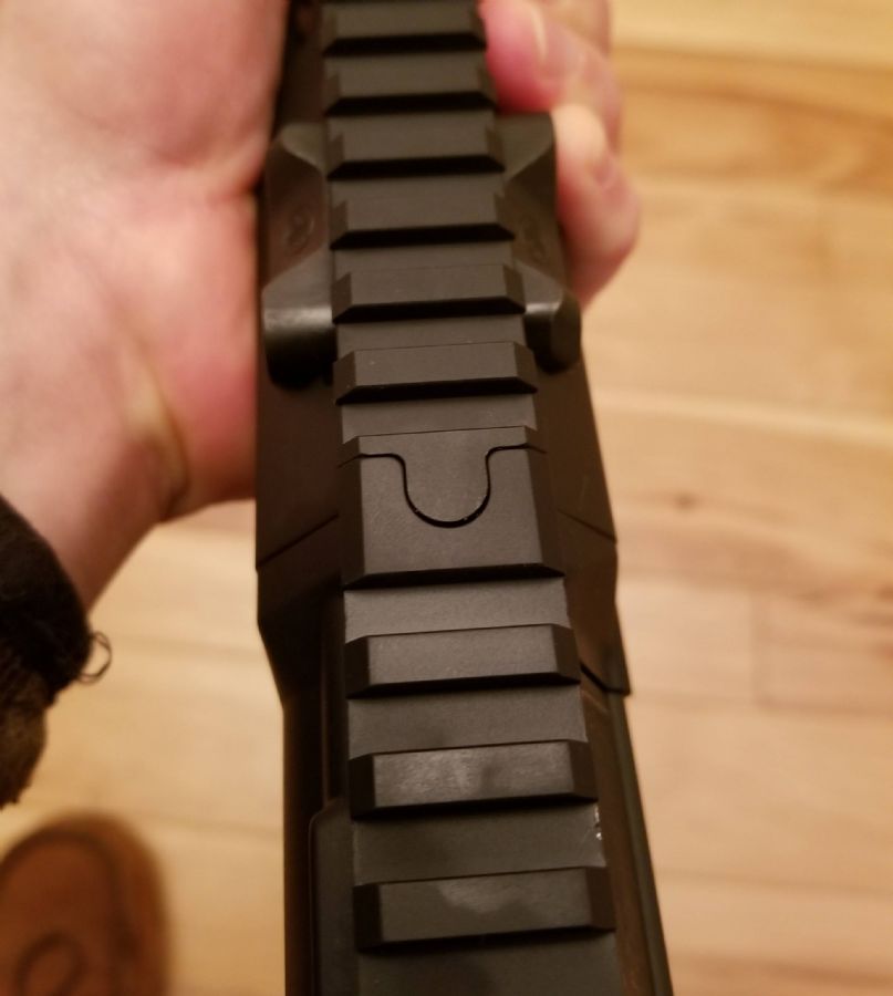

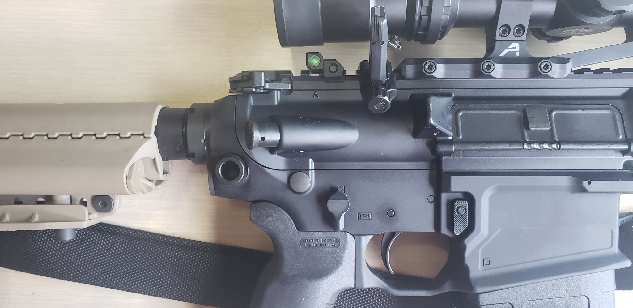

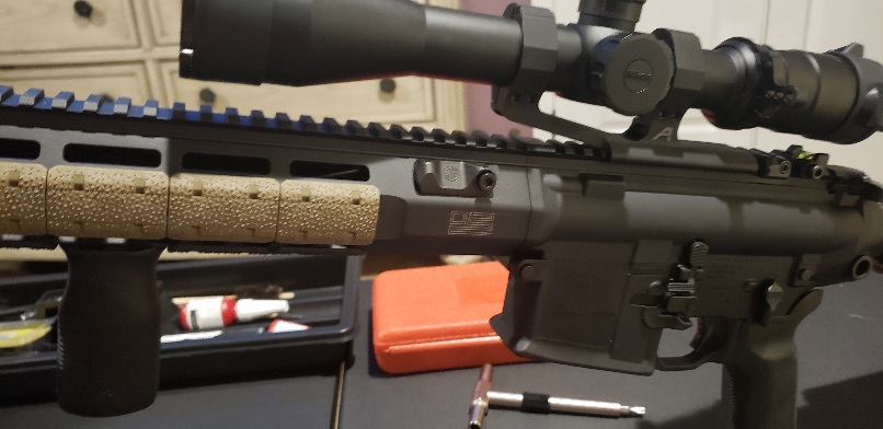

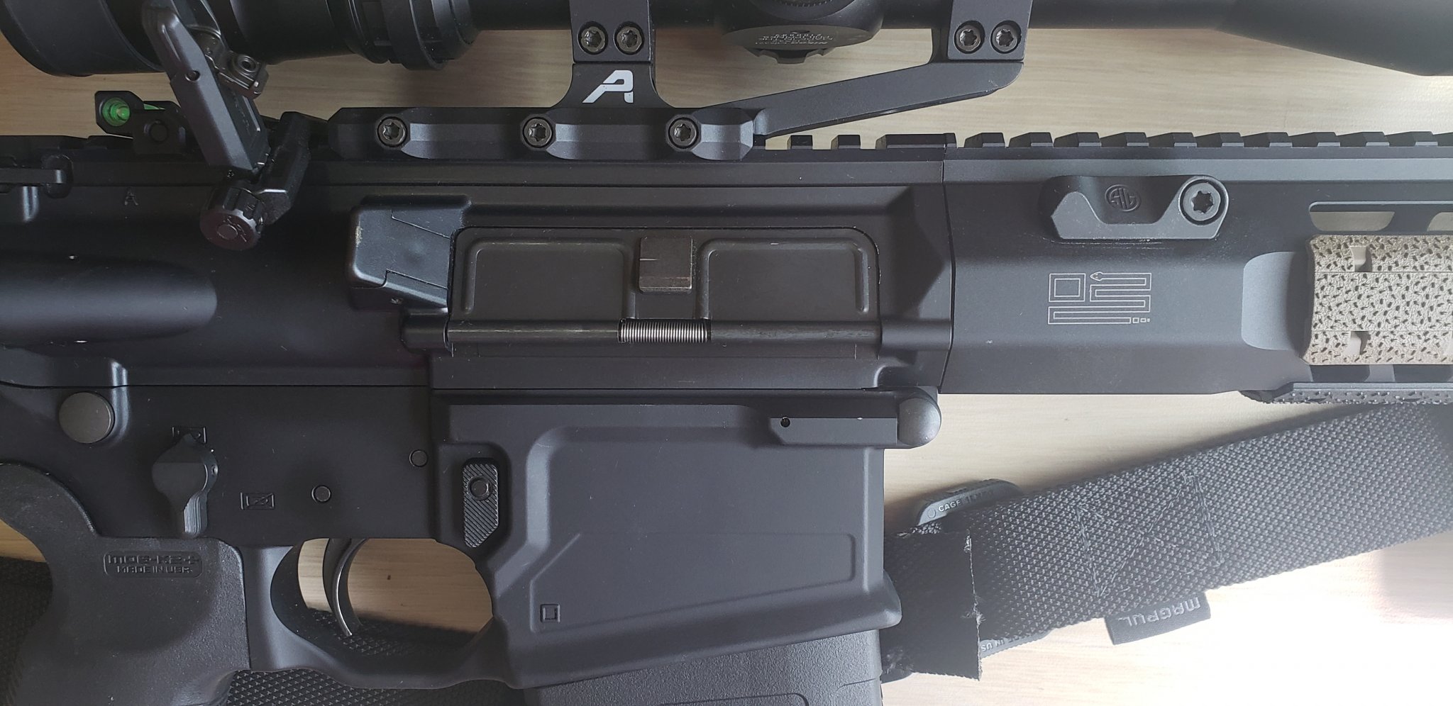

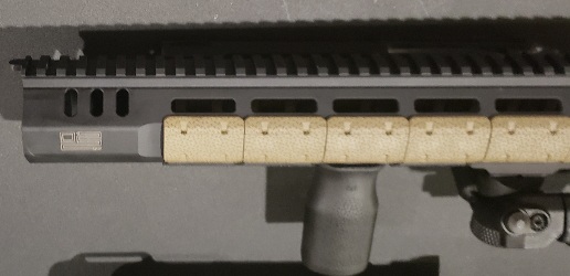

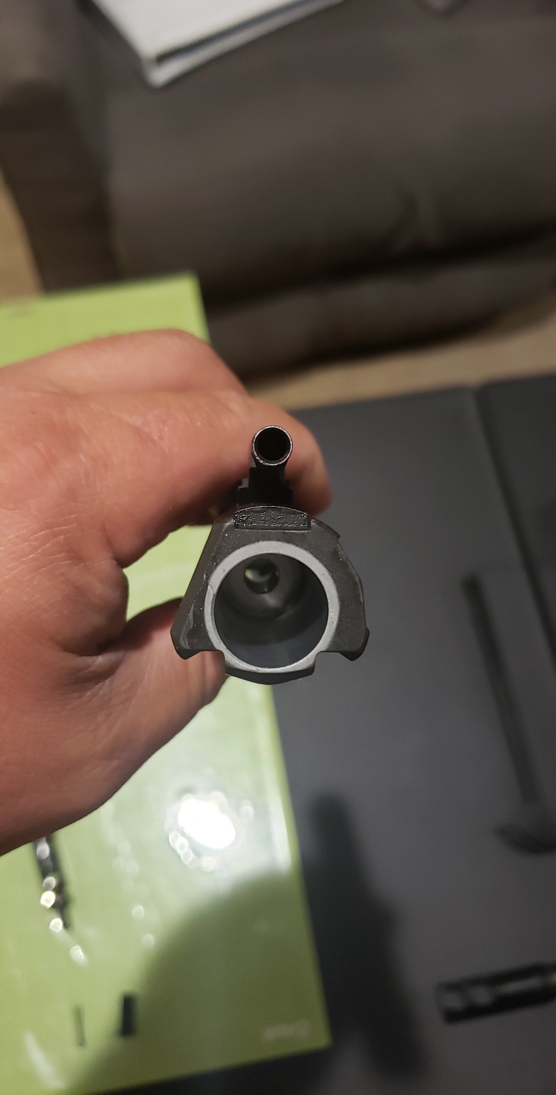

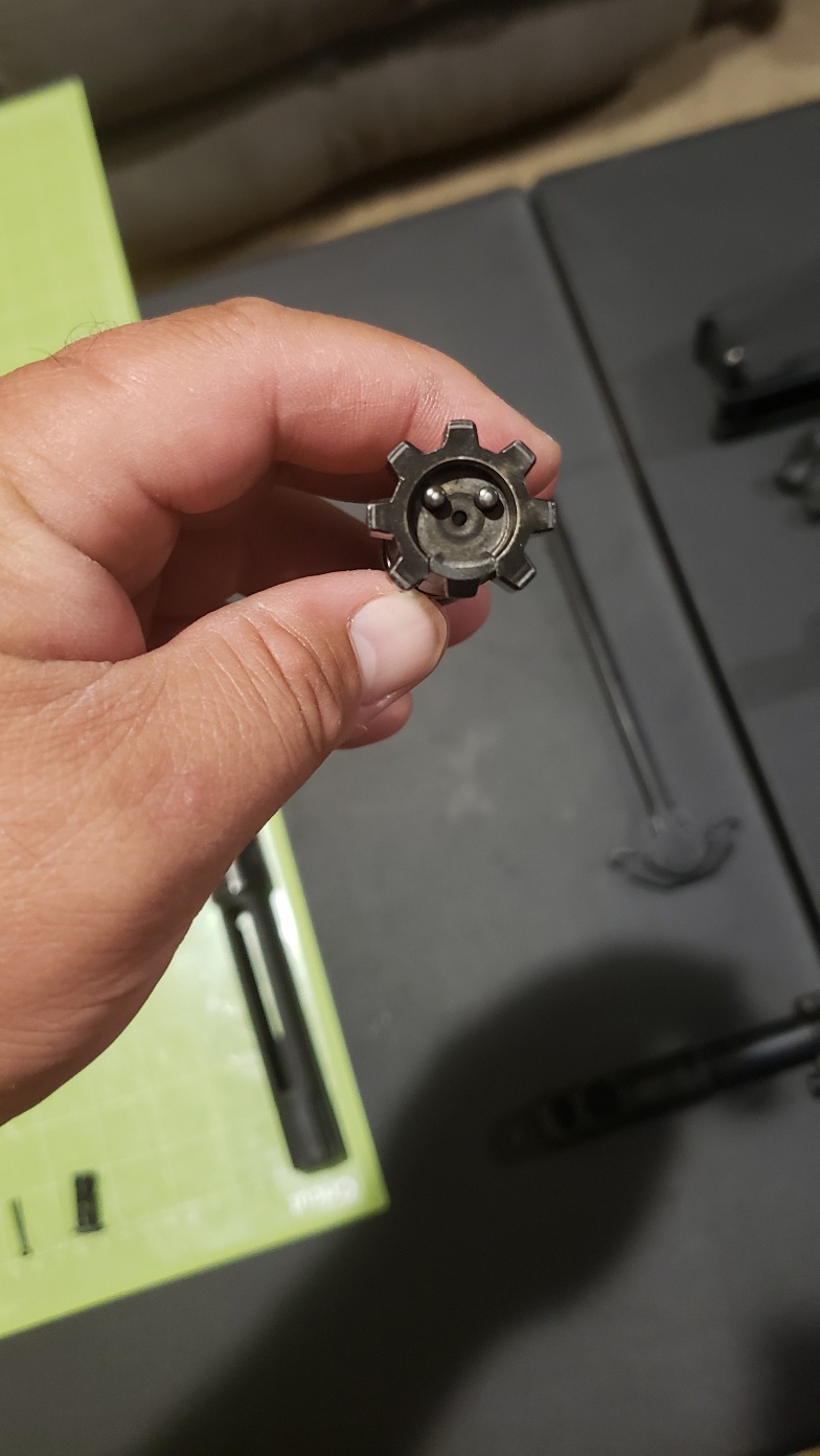

The Handguard is keyed to the upper to avoid rotation and the nuts are fastened to the handguard using a retaining clip the secures the handguard in between the exterior top barrel threads. Very easy on off. Sorry about the measurements I don't have calipers. Tried using the wife's Cricut mat and my micrometer for a better idea.
Thanks for taking the time to post those pictures, it seems to be put together well.

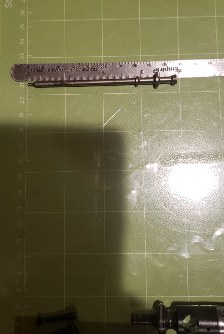

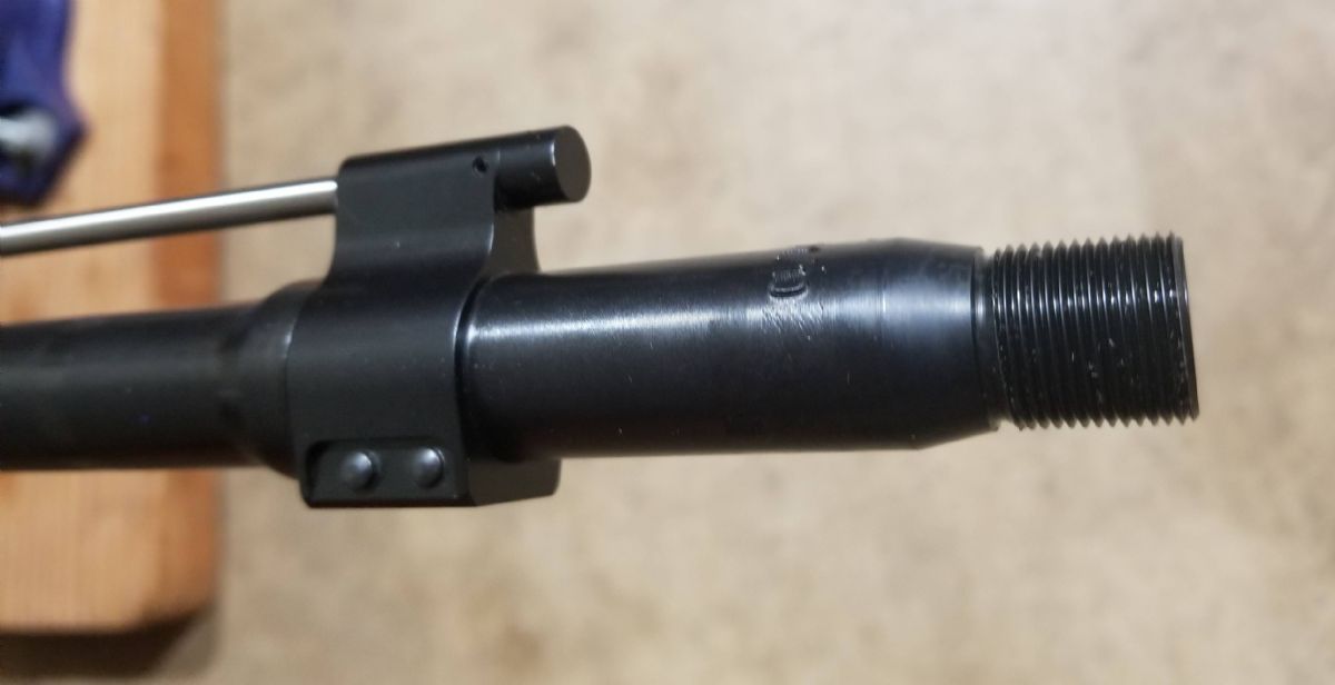

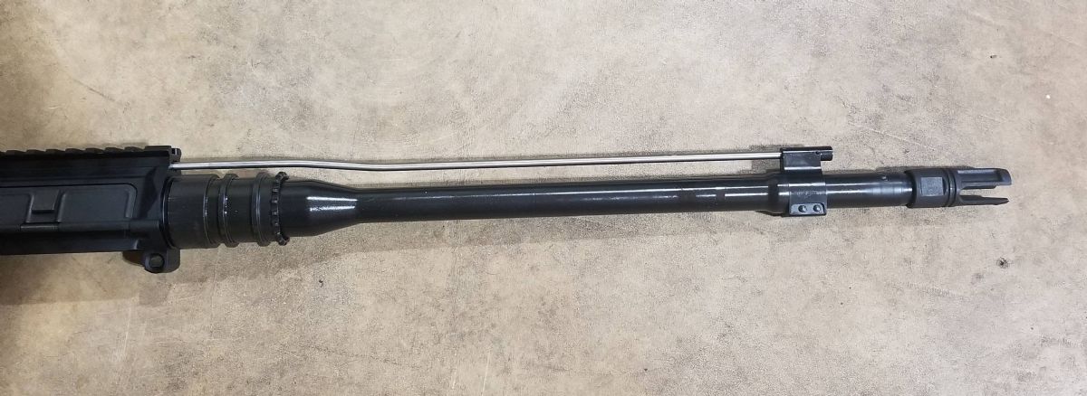

couple design features, from the pics, that I think are worth mentioning.

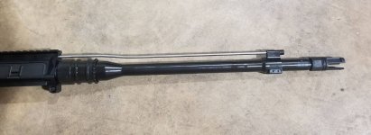

looks like the gas block is clamp-on? instead of set-screw or pinned. I would've expected it to be either pinned, or dimpled and set-screw. just an observation, clamp-on works just fine. might be pinned, just not enough resolution from the pic.
the handguard anti-rotation key that mates with the notch in the upper receiver, is nice, although you won't find any aftermarket HG's that have that feature, if you want to rebarrel and go with a different length HG, e.g. 20" barrel & 16" HG.
the handguard retention looks to be similar to what BCM does, opposing screws at the top. The wedge retention against the barrel nut (is what it looks like) is also similar to what Aero Atlas, and SLR HG's use, although at the bottom. It's advantageous to have the retention up top by the gas tube.
the cutout in the top of the bolt carrier for the charging handle, with the raised edges, and stress-reducing radius's (circular fillets), is a premium touch, IMHO. Helps to keep the end of the charging handle exactly where it's supposed to be, so that it doesn't have the opportunity to twist (think of when you have to mortar), or contact/bind the gas tube (GT engagement in the gas key). Although the depth of the cut seems deeper than AR-308 "standard". Should still be compatible with aftermarket charging handles (e.g. Raptor, etc). Gas tube is supposed to have a slight degree of float so that it can self-center in the gas key. All of my AR-308 bolt carriers are cut flat across.
and it looks like a steel barrel nut, instead of an aluminum barrel nut.

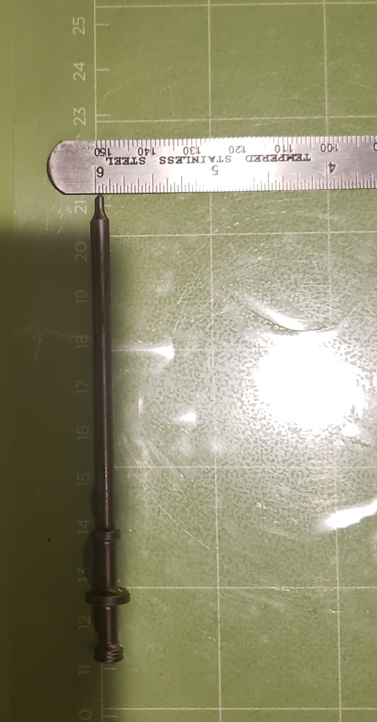

would be interesting to know if it has the HP "skinny" firing pin and corresponding smaller bolt-face FP aperture, if you ever decide to put a 6.5CM upper on it, although perhaps not absolutely necessary. couldn't tell if there's a regular extractor, or lobster tail.
just some observations from the pics, nothing more.

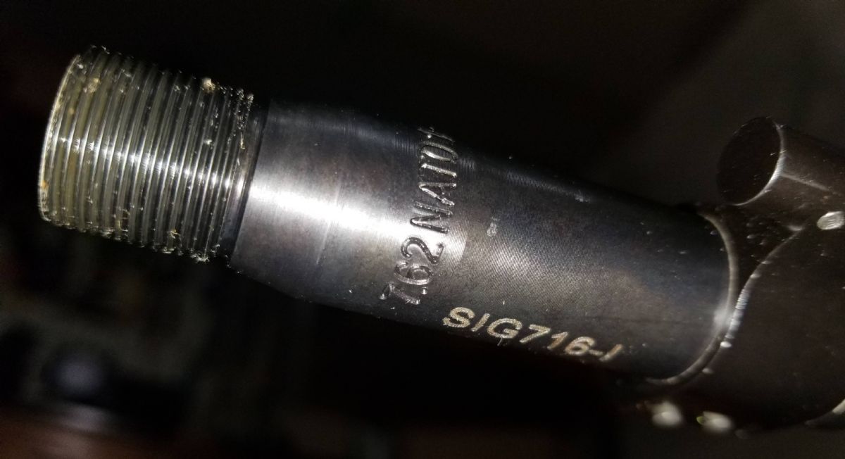

The gasblock is pinned with 2 large pins.

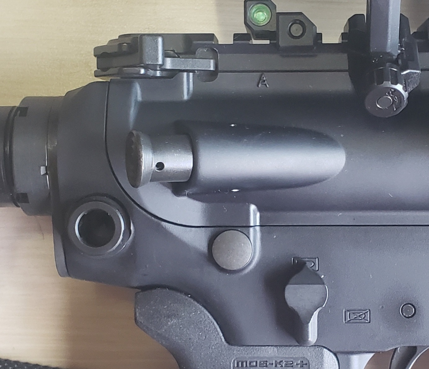

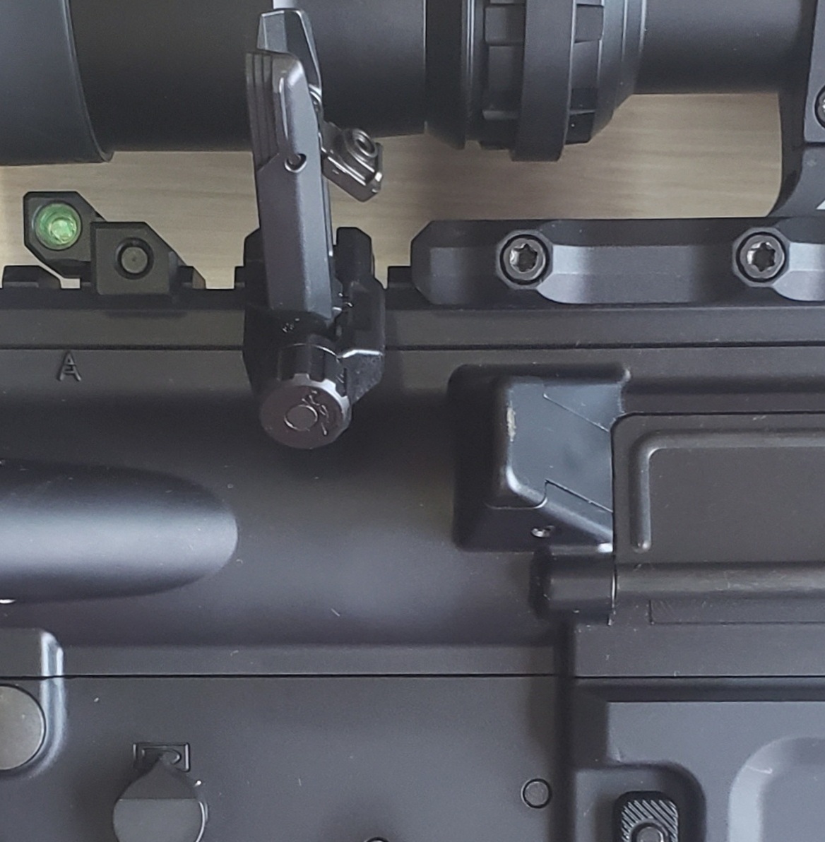

I am not an engineer. Based on what I can see, I think a 716 weak point might / is going to be the rear of the lower receiver where they put a QD mount hole, based on cracking problems all-synthetic AR lowers had, if the Indians use shit ammo and have to resort to "Mortaring" to clear stuck cases.
522485
EDITED: NEVER MIND. It looks like the Indian Army 716I does NOT have the QD holes machined-out:
522485
Every time I see that QD socket machined out on the RET boss thread area, I think the same thing.
I suspect they incorporate reinforcement into it when I see the raised ring around the socket aperture, like KAC has done on the later SR-15 variants and their PDW.

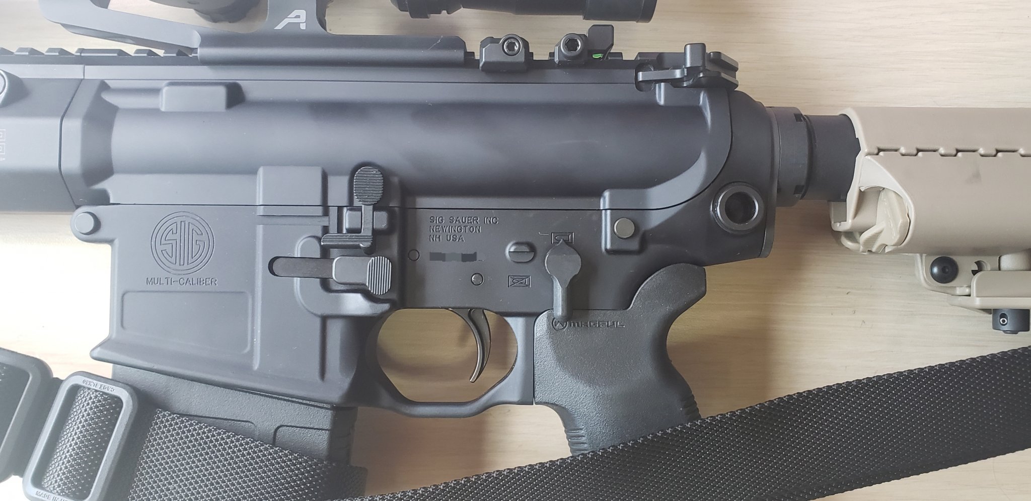

Another interesting thing about the SIG 716i is the pistol grip, which looks very close to a P365 grip angle and shape.

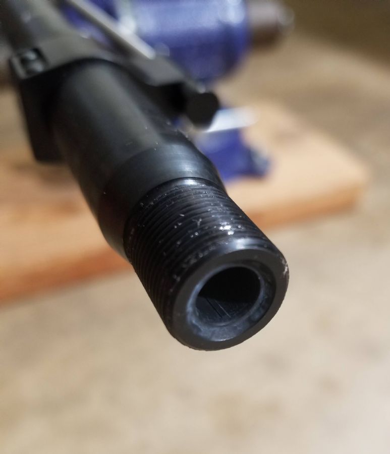

Can you tell anything from the Forging marks?
Here are better pics, included is a close up of the removable/ replaceable steel brass deflector and of the QD mount rear.

Here is another owners pics and mine illustrating the handguard key. Also some more barrel and crown shots thanks to Ex_Sanguine_Nation from AR-15.com.
