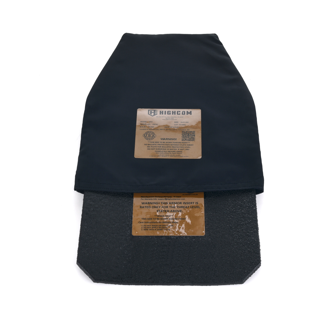

Hey friends, this is a question for those of you that have experience with hard armor.
I'm looking at picking up a set of level III steel/titanium plates soon. These have been debated back and forth with pros and cons over ceramic, but that isn't what I'm looking to get into here.
I need something to control spall (the splashing of lead and copper that shoots outward when a bullet hits the front of a steel plate). I've seen zero aftermarket options to purchase, but a few people had mentioned that I could linex the surface of the plate (there are no linex dealers for 150 miles) or sew a bag out of layers of bulk Kevlar.
Am I missing a better option? Or is it very easy to sew and cut kevlar?

The plates (ceramic) we wore in combat were placed into a kevlar pocket. So, spall/splatter/whatever wasn't really an issue. You are going to have to put these things into some kind of carrier to wear them. If whatever carrier you use is made from kevlar, it should solve your problem for you. Although a centerfire rifle bullet will penetrate a layers of kevlar, once it gets through the kevlar and strikes the plate, the bullet comes apart into shrapnel. By then the velocity is so deminished, the kevlar around the plate catches all the pieces of the shrapnel.
It is fairly easy to sew and/or cut kevlar. It's the pulling/breaking strength of the fibers that stop the bullet. But, the fibers are easy to move sideways and allow a sharp item like a needle or icepick to slide through. It doesn't break the fibers .... it only moves them out of the way. They cut fairly easy, also because you are not stretching or breaking the fibers by pulling them (which is where kevlar gets it strength). That's why cops put the thin metal trauma plates into the pockets of thier vests .... because the vest doesn't do much to stop a knife or ice pick.

We use to carry some Level III steel plates that were stitched into a Kevlar carrier to reduce threat of spall. Issue was that the bulk of the kevlar kept the plate from fitting into a carrier of the corresponding size. Buyers were finding that they had to go up a size in carrier to make the plates fit. Also, many of the steel plates in the 5mm zone were failing to stop some of the threats that they should have been stopping. Some of the metal plates are "in conjunction" plates which require that you wear IIIa armor behind it as well.
Im not aware of any carriers that have the kevlar composition to count as spall protection (front or rear). There are carriers that have kevlar, but thats and angle taken to increase strength and reduce weight, nothing to do with ballistic protection.

Thanks for the information guys. Any thoughts on an amount of layers that should suffice as a covering? I've heard 3 to 5 layers. Kevlar comes in different weave counts and thicknesses.
Re: The Spall Liner
You can do the linex yourself..they sell it at autoparts stores spray or roll on. But I have no opinion on its effectiveness.

Actually, this might work too.
Kevlar Tape
If I taped a couple of layers to the front of the plate would that control the spall? I would think it should act the same as if I stitched a kevlar bag, but this might be easier.
It says it isn't suitable for bulletproofing, but that isn't exactly what I'm looking to do. More fragment control.

I have used plate backers before, this helps prevent fragments of the ceramic plate from penetrating the body. I suppose one could place a plate backer on the front side of a metal plate to act as a spall liner. Or sandwich the metal plate between two soft plate backers. There are so many variables here that trying to come up with a sure fire way of preventing spall or richochet is more or less guess work and theory than anything else.
http://www.ebay.com/sch/i.html?_sacat=10...kers&_rdc=1
