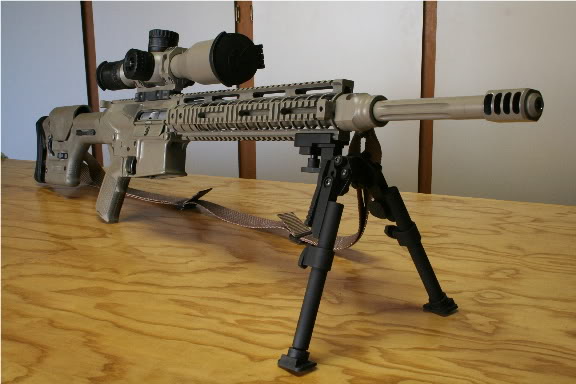

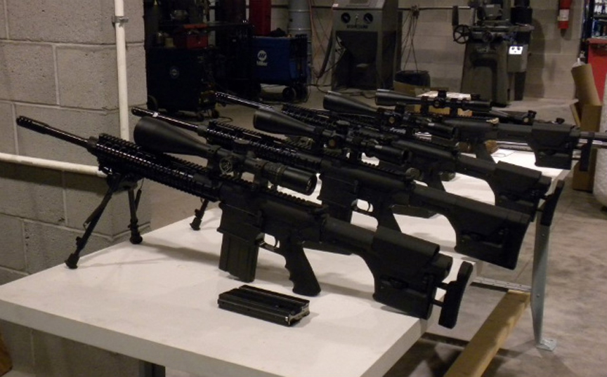

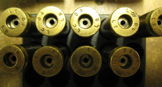

LCLR Brass for the Wilson......., once fired brass made for USMC and USA Sniper and designated marksmen teams by Lake City, head stamped as such, fired at Picatinny and collected by the one gent who has a license to take that brass from that range. So far I have 2,000 of them with a standing order with him.
Also pictured is our sorting tray. 1/10th gr increments.
