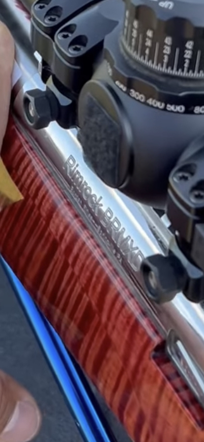

Eric Cortina seams to know what it takes to win. Here’s a closeup of his action taken from his latest YouTube speed test video. He’s running a Borden. I’m not an expert but BAT or Borden seam to be solid choices.

Eric Cortina seams to know what it takes to win. Here’s a closeup of his action taken from his latest YouTube speed test video. He’s running a Borden. I’m not an expert but BAT or Borden seam to be solid choices.View attachment 8118335
Ohhh a Near Mfg Alphamount. I got a few of those myself 💅🏻 didn’t know Cortina ran them.

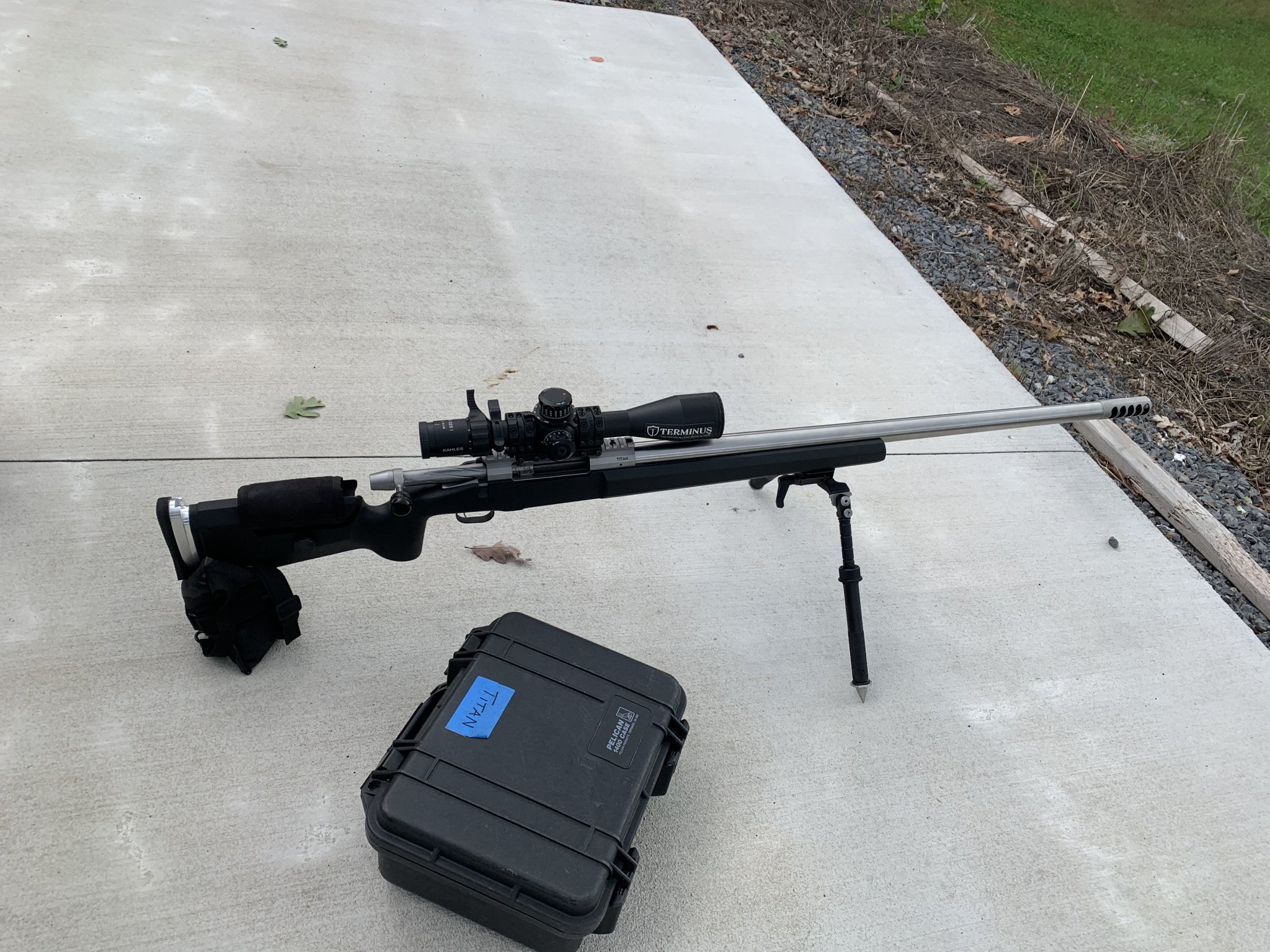

Here is a prototype Titan in 300 Norma.
