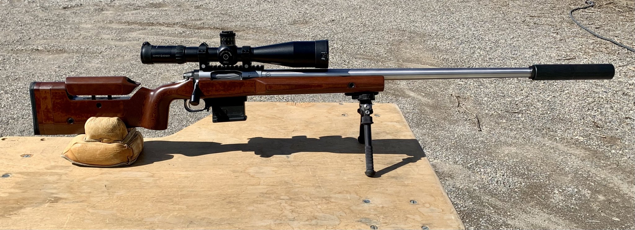

20 practical for the win! I just finished this one. I had hundreds of rounds left over from the previous krieger barrel, and fortunately this barrel shoots that load perfectly

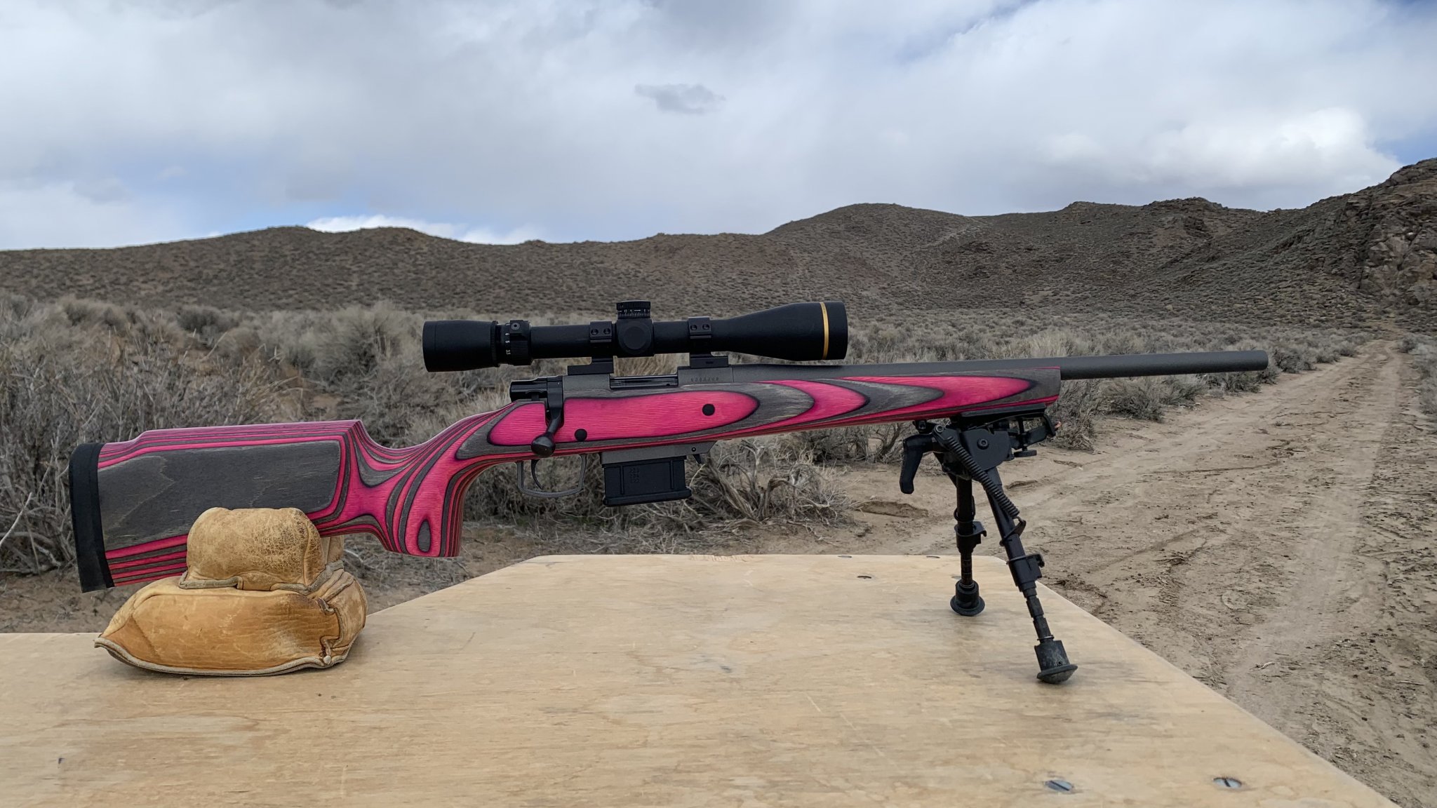

The Pink Panther. Howa Mini action with a 18” 2.5 contour Krieger, chambered in 20 fireball. Stock is a modified Boyd’s. Built this as a xmas present for my girl a few years ago.
20 fireball loaded with 32gr Varmigedons. 18.2gr of H4198 goes 3415 fps out of this barrel.

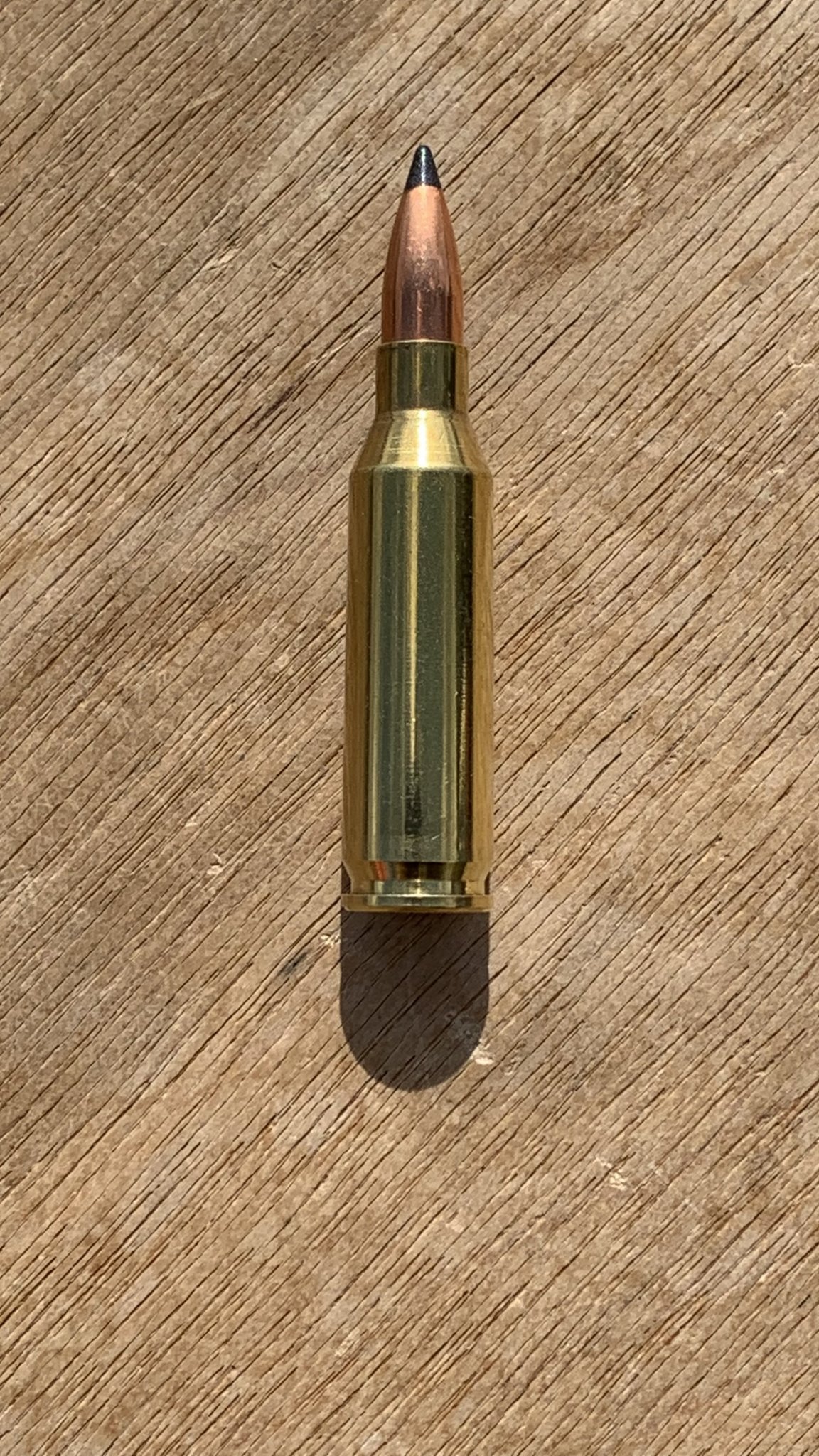

Although there are guys out there with MUCH more experience with little cartridges than I have I've still played with a fair amount of them from 17 cal to 22 cal. It's a juggling act deciding which works like you prefer it too for the different situations you find yourself in.
I settled on this one called a 5mmFBI as my do all. Basically a 20VT AI with 40 degree shoulder. Although I can push it to 3850 fps with 32gr Vmax out of a 21" barrel it shoots better at 3750 fps.

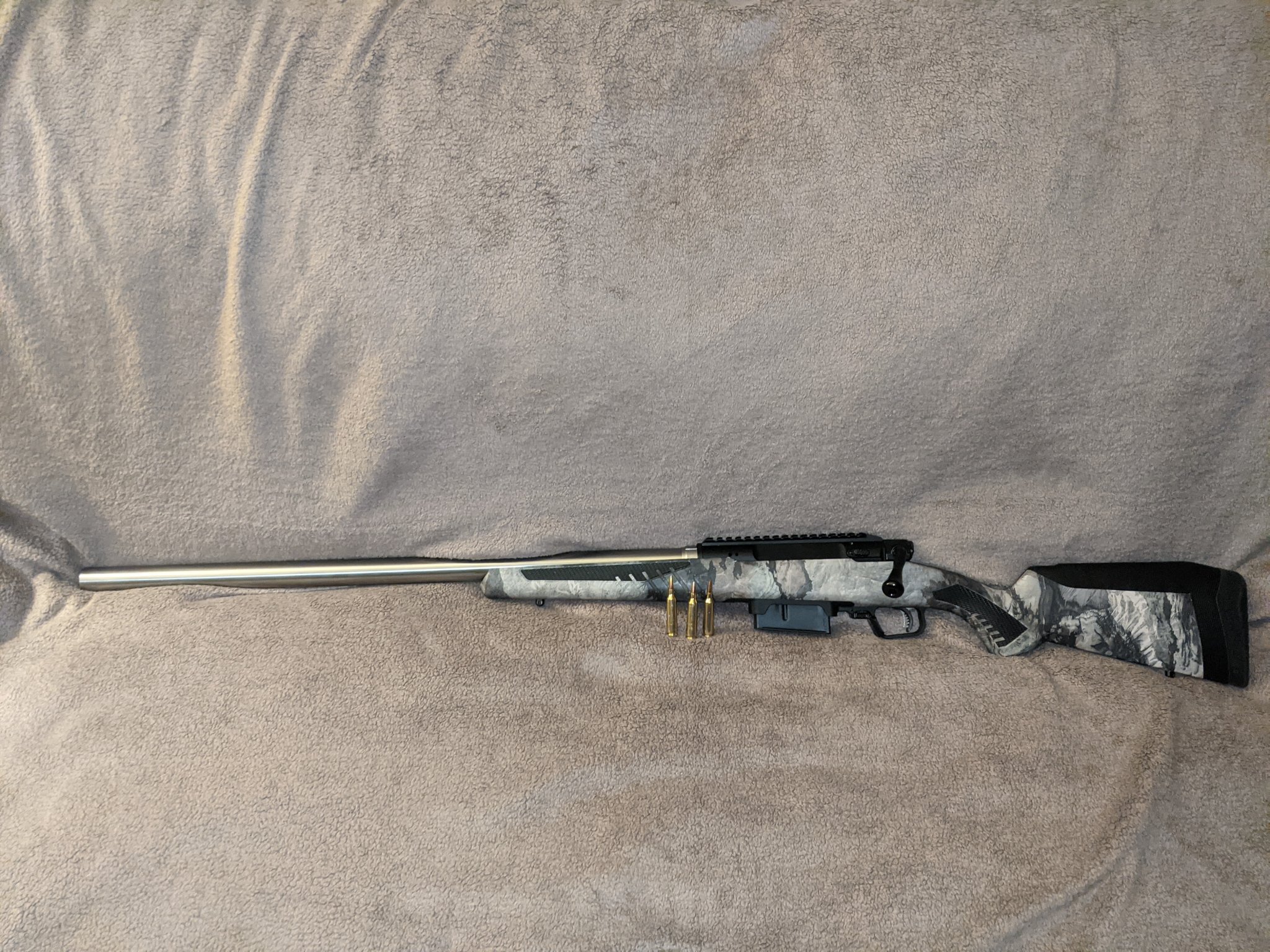

I built a 20P turn bolt rifle years ago to test out the .20 cal waters and was very impressed.
After finding out that Savage wasn't making any .378" bolt heads for the Savage Impulse rifle for me to chamber it in 20P, I ended up building a
20-250.
No special mags needed, easy brass forming and the parent 22-250 brass is readily available.
It's been a great cartridge so far.
20-250.
View attachment 8107506View attachment 8107507
Whats the 20-250 load? How fast?
I'm shooting a 55 gr berger /4350 load that the fellow I bought the barrel from said shot lights out and it does.
Haven't chrono'd the load, as I wanted to get out in the field to shoot coyotes with it before the NY season ended.
I bought some 40 gr NBT's and will see how fast I can push them accurately before chopping the barrel to make it lighter and easier to hump around.
