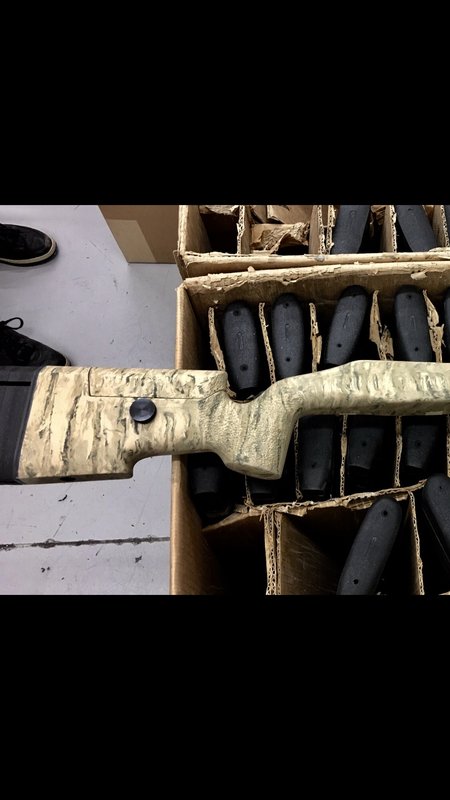

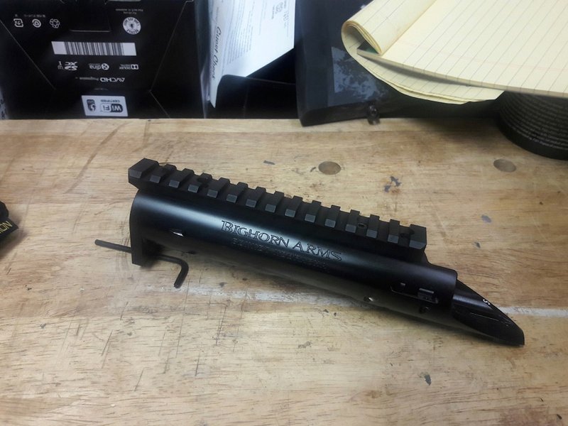

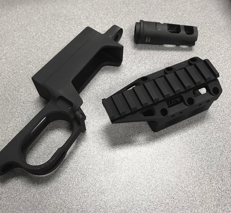

    DLC T3, McMillan A5a,Terry Cross DBM, and McCann SIRS NV mount. Gonna be chambered in 6.5 Creed and sending those rounds through a cut rifled Muller Works barrel.

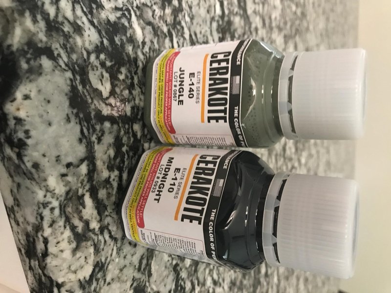

    I started mixing the colors today on the ELITE colors and I only had about 10 ml of the Elite Earth to put in it. The jungle is definitely getting darker with the Earth and the Midnight mixed but it still has a hunter green look to it since I added the Midnight after the Earth. I'll have some more Earth soon and it should really do the trick to bring it to more of an OD/Tarjac green. At least I hope.
    The reason I want to go with the Elite is the harder/thinner/slicker properties it's claiming to have. My smith has said it's definately thinner/slicker then the H series. FLAME SUIT ON...I hate the silver NP3 color. The action itself is DLC'd, so I'm masking off the entire inside meticulously and blasting the outside and the BOLT. I want to see if the thinner/slicker aspect of this Elite series will work well since I'm not tolerance stacking it with cerakote on the inside of the action. YES, I'm sure it would be slicker with the NP3/DLC combo but I want to see just how slick I can get it with the DLC/Elite coated bolt. Worse case scenario it's sucks and I just send the bolt off for DLC or NP3.
