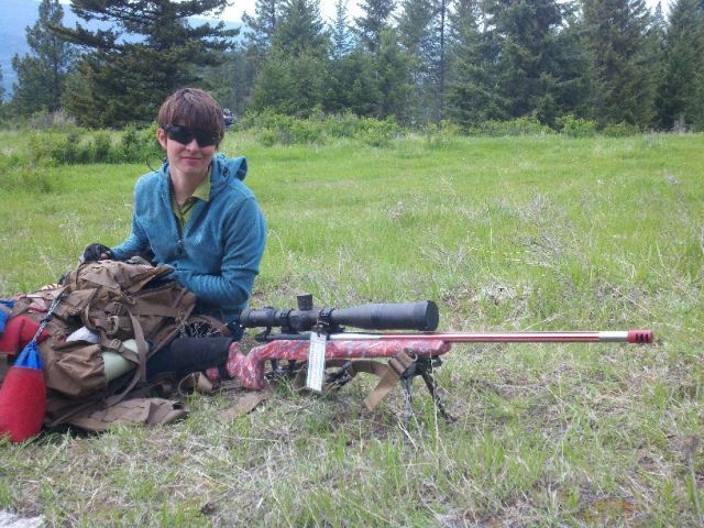

- We females (as my audience well knows) can be stubborn creatures and like to look badass. If she picks something heavy, let her drag it around a bit then be ready to trade it off when SHE decides it is time. I really didn't want to swap until I had held different stocks. NOT my husband. ME.
Here's a pic of my McMillan/6.5SLR here, scope is Vortex Razor:
