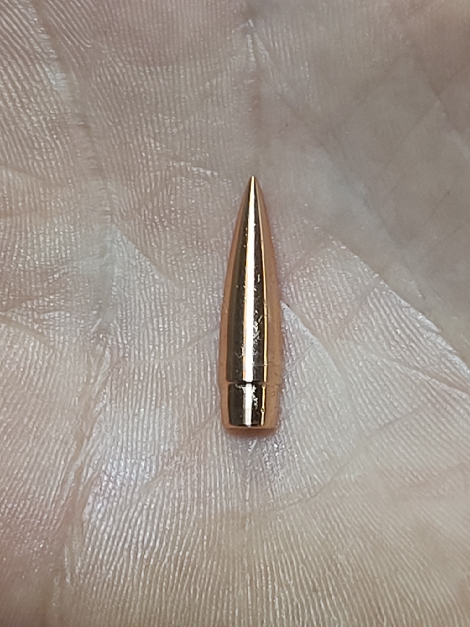

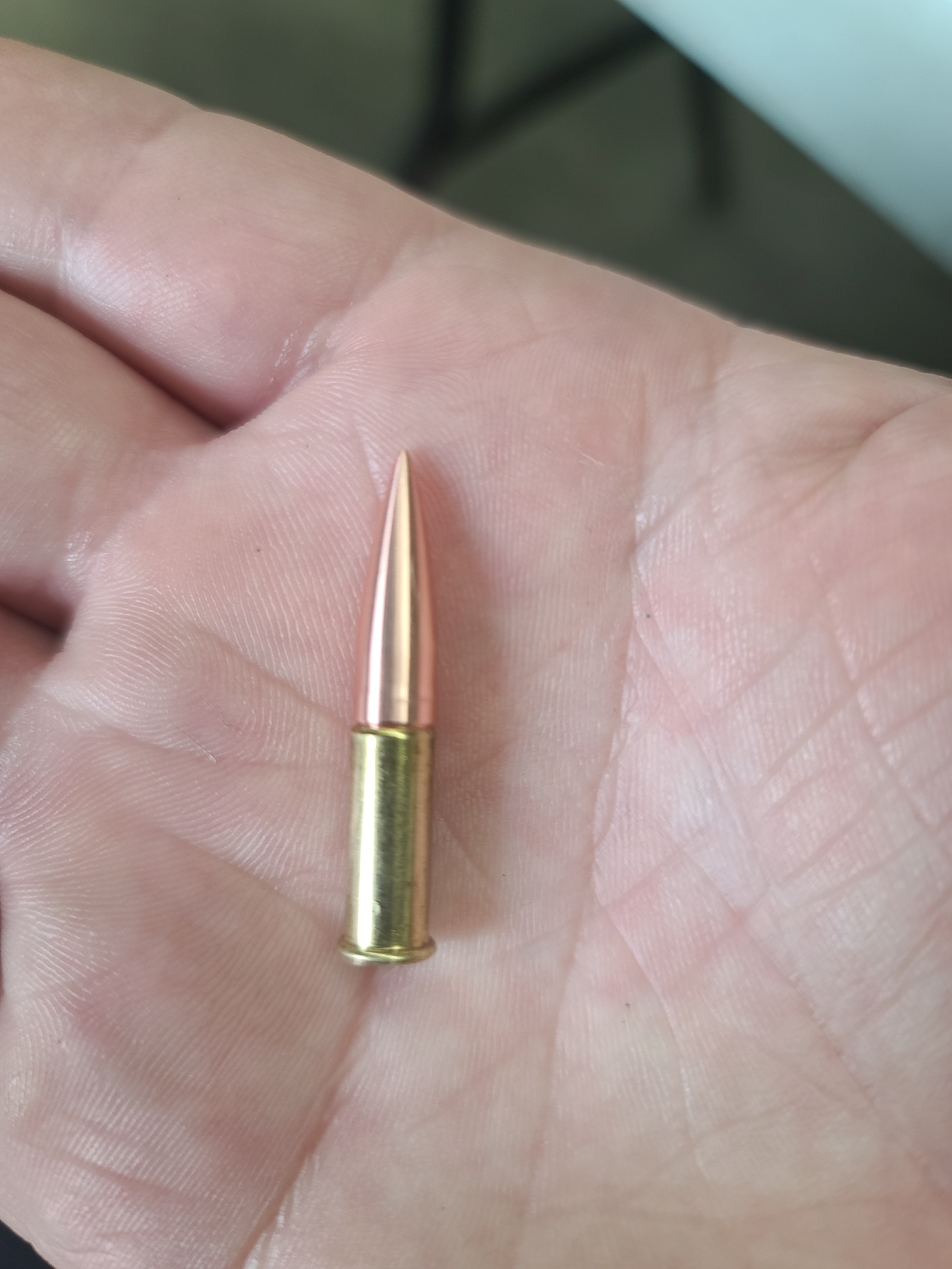

    Let’s see what these will do in a fast twist Bartlein on a Vudoo. Had my buddy fit and chamber a 1-5.75 Bartlein barrel. Worked with another friend at Badlands Precision to get this bullet made.
    That big bullet doesn’t leave much room for powder.
    That looks pretty wild!
    I'm looking forward to some range reports. Economy of scale would be a friend to all if these ever take off.
    Pulling factory bullets and replacing with these or are you changing the powder charge as well?
    Very interesting for sure.
    If they shoot well enough I can't see single feeding an issue. I know it would be to early to tell.... but what price are you thinking per round? Having boxes of 50 or so like a standard box?
    I have no intentions of pursuing loaded ammo with this. The biggest part for me in this was designing the bullet. I had some parameters and we worked together to make it what it is. I would imagine Badlands will sell the bullet if someone wants some once the design is finalized

    Currently this design is under .60 that can change depending on design changes
    Not horrible when looked at next to some of the Eley or Lapua ammo I guess.
    How do you go about setting these up on the case? You pull the lead out of a shell and "reload" with the brass projectile?

    My brass came from FedArms. This is actually one of the least expensive projects I’ve done. I’m under .65 a round. Got the bullets today and ran into a little problem after a few rounds so this is pushed back a week or 2 now.

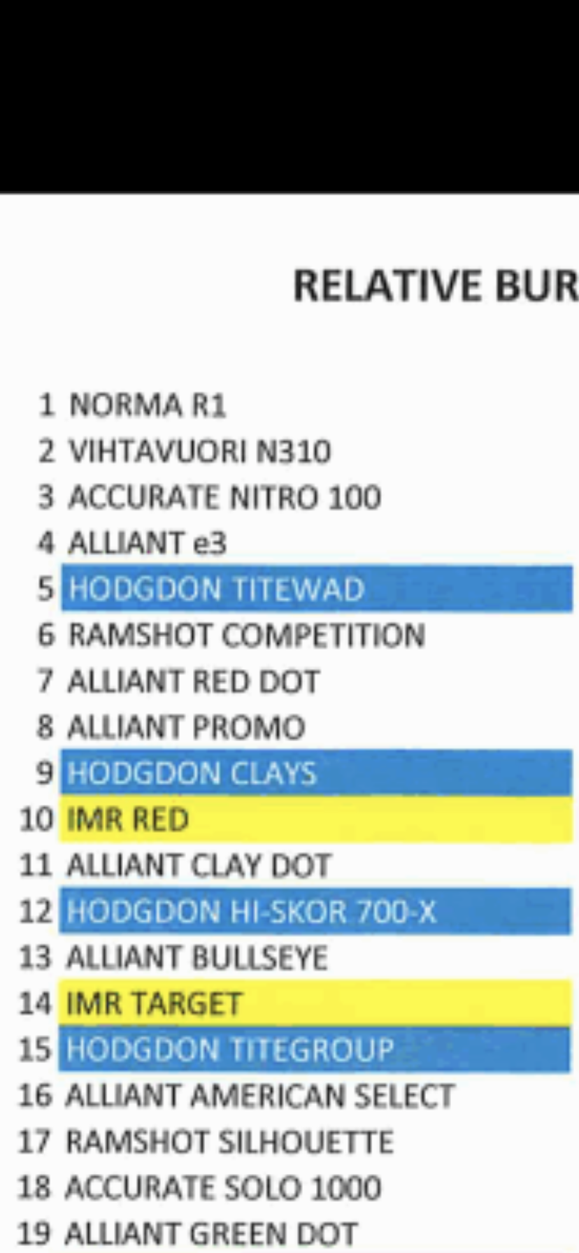

    Starting with titewad
    here’s a possible thought for you as well.
    you may not realize, this whole deal was done, as well, 25 years ago when RFBR was still shooting some group matches.
    Billy Brawand, who is still around Is a buddy.
    Anyway, as a bullet maker, he had dies made and turned our BR grade jacketed bullets.
    He was able to source quality cases but the real issue was sourcing proper powder which nobody would sell, or really discuss other than discovering it was a proprietary
    VV version.
    His entire exercise was largely responsible for rules mandating only commercially available , lead bullet, million rounds/ year etc. in all sanctioned shooting.
    My point to this whole deal is that, with your experiment, you might also try to autopsy a few high end rounds for powder as sort of a “ proof of concept “ sort of test.
    Just a thought.
    Reactions: z28kid and Geno C.
    I’ve seen tiny stick powder and flake inside match ammo. My thought is to start with the fastest powder I had, and go from there. VV makes an R1 I think that is the fastest available, but I don’t have any. If what I have doesn’t work, then I might have to try to get some
    Really just #1 and 2 I’m thinking I might meet to try. Titewad might get time where I need to be but I’m not sure yet
