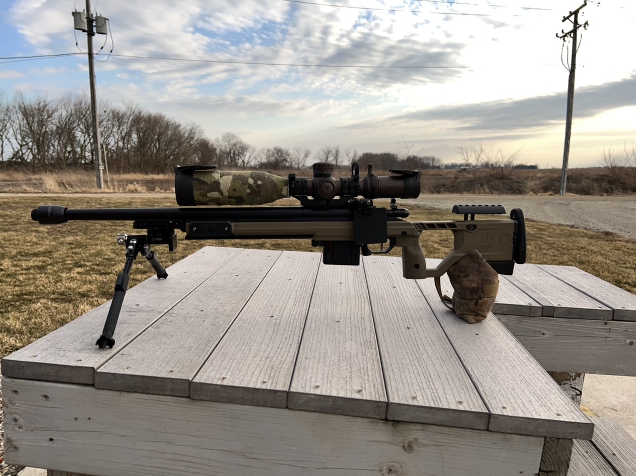

If you're only shooting bench, esp scoped, I'd think the 18" might serve you better, but the VGW folks are worth a call, they can give you great advice.
If you were shooting PRS, I'd tell you to get a 22" MTU for balance purposes, which is what I'm looking for rn. I have an 18", shoots great but too rear-heavy.
My 22" MTU in a Greyboe Ridgeback balances right in front of the magwell.

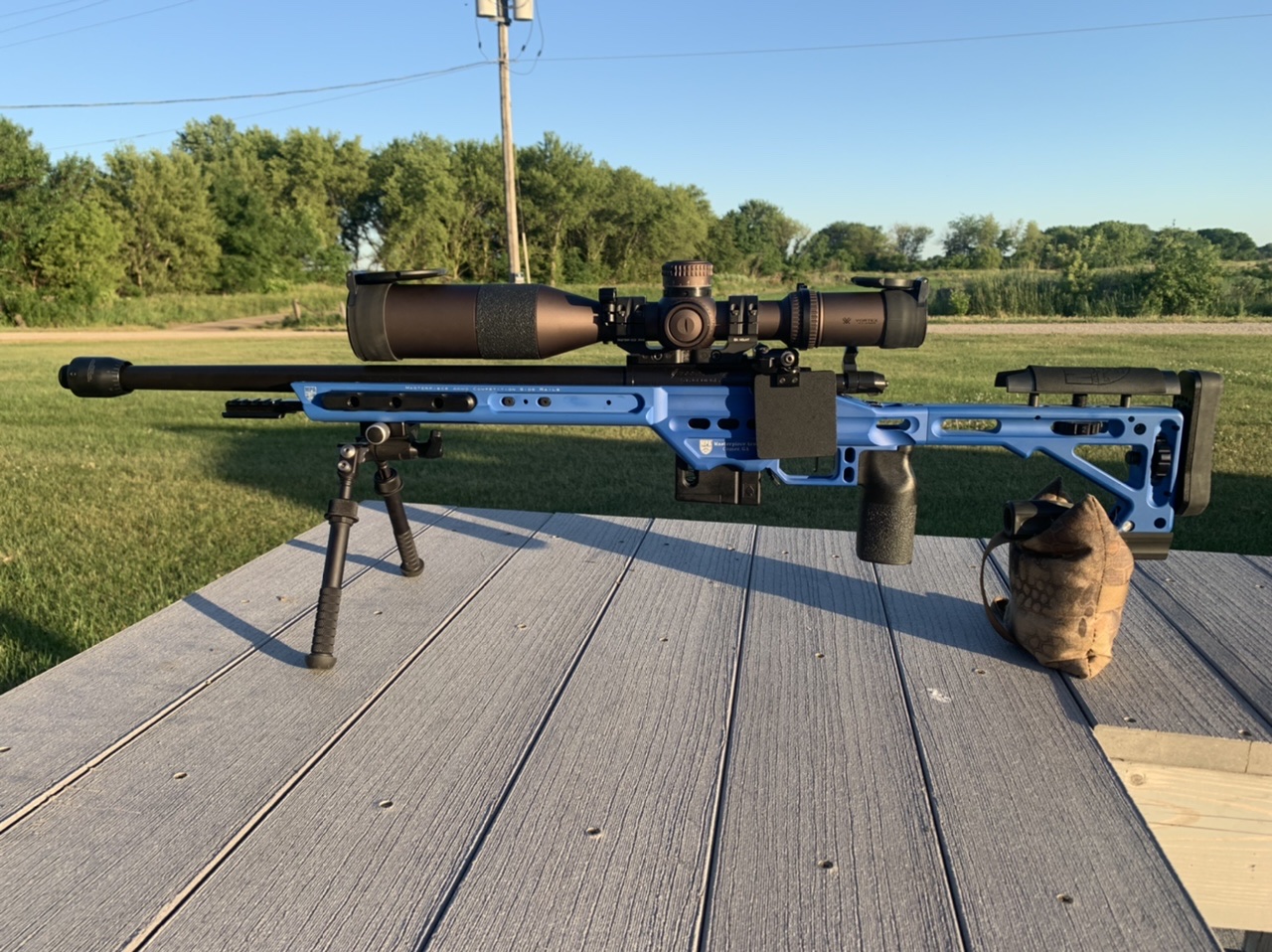

I have a 20" MTU & a 22" Kukri - Both are in Grayboe Ridgeback stocks. It was a simple process to open up the Ridgeback barrel channel a tad to accept the MTU profile.
Both these set ups work fine in a BR situation. For what it's worth, the Kukri is a better shooter but that means nothing as not all barrels are created equal! Both these are Bartleins.

I’m not 100% why you feel this way. Balance plays a huge role in positional shooting. My 20” mtu in the Krg whiskey 3 is too rear heavy causing me slight additional strain trying to counter balance it which in turn was proving to be accounting for more misses.
I removed the heavy bag rider, added front external weights and while it’s still not perfect in my mind it’s significantly better and my hit percentage went up

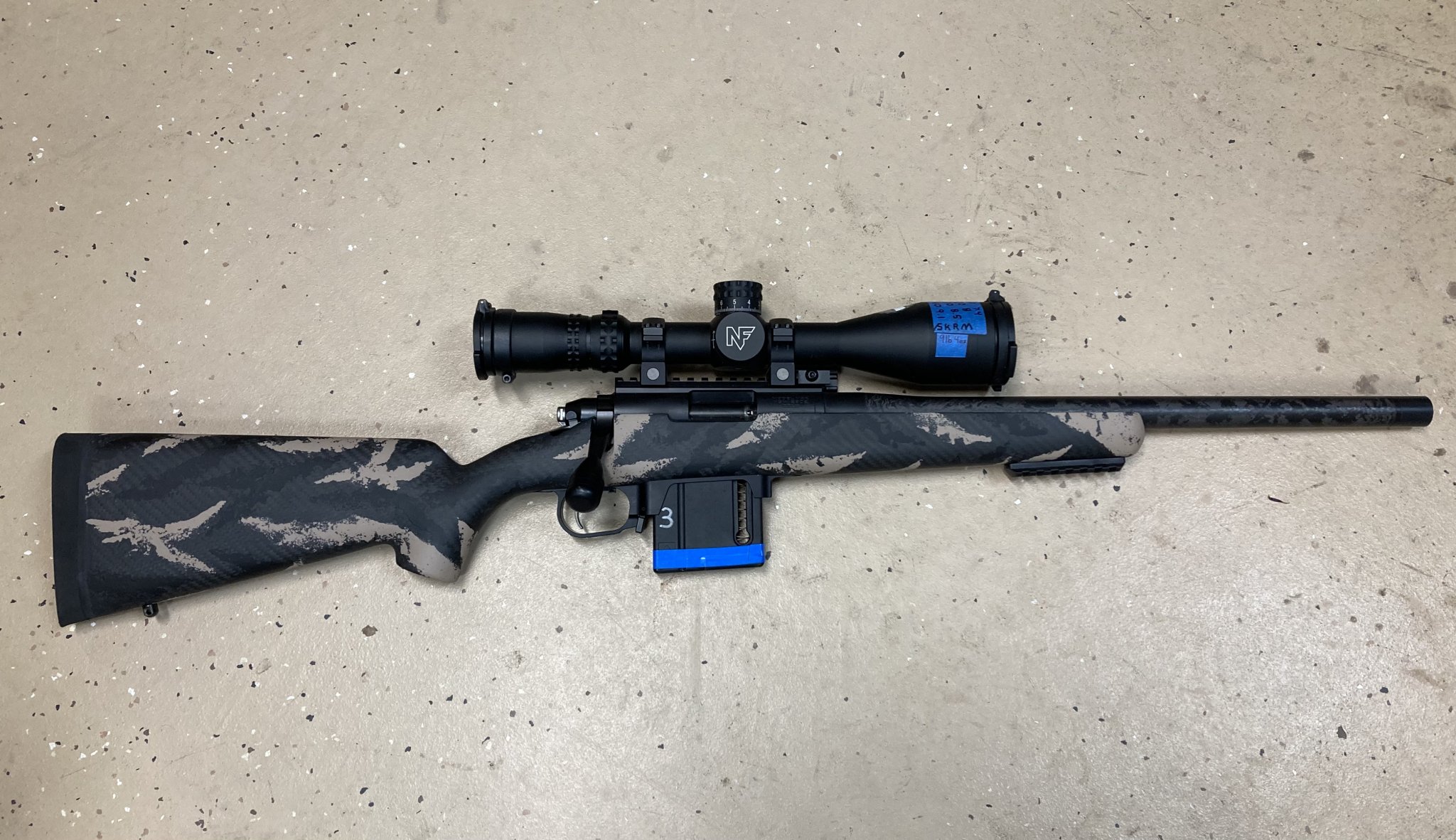

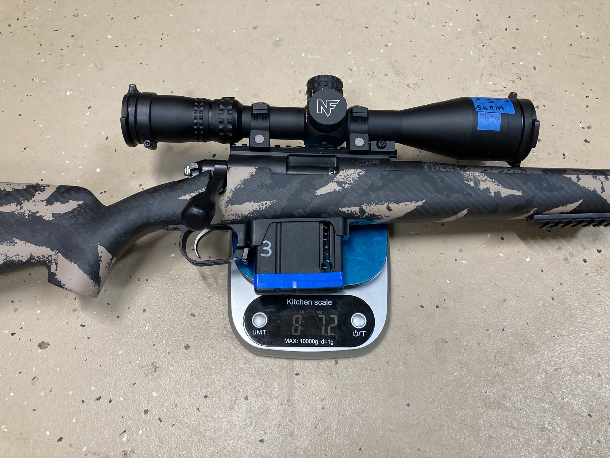

I am at exact opposite extreme of trying to be light as possible with the not so lightweight optics I want to use. I need to be at 8.5lbs or lighter for one of my matches per national rules. holding a rifle offhand changes your perspective on weight very quickly. Having a rifle as heavy as possible for barricade benchrest isn’t that appealing to me as my opinion is you are using excess weight to mask problems with fundamentals and technique.
18 proof factory barrel in a AG Composites carbon fiber stock and lightweight NF rings barely make weight requirement:
View attachment 7840785View attachment 7840788
Great looking rifle!
