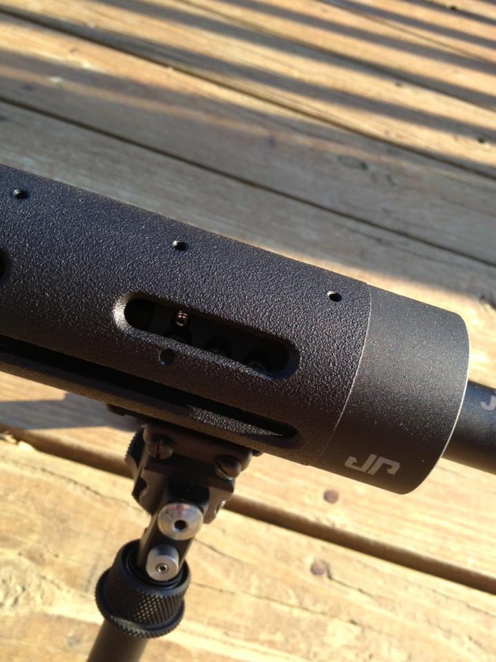

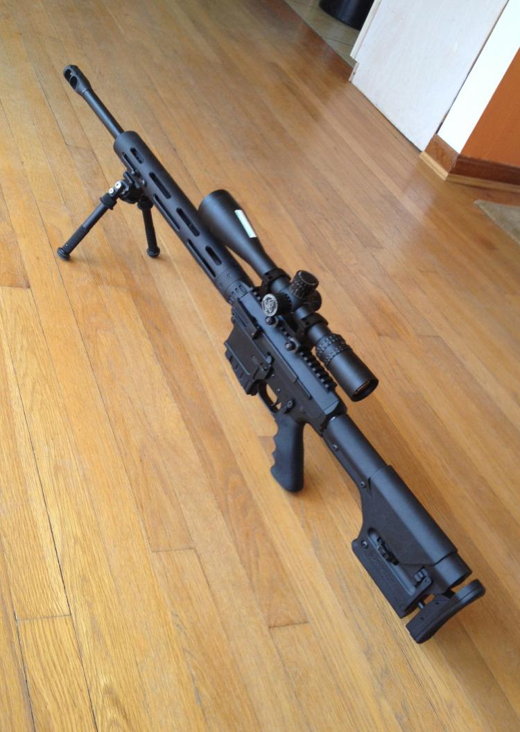

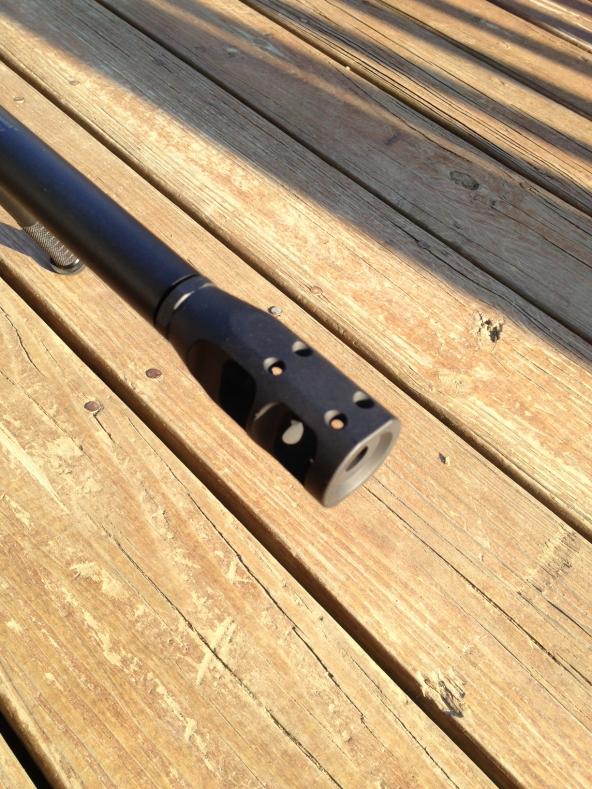

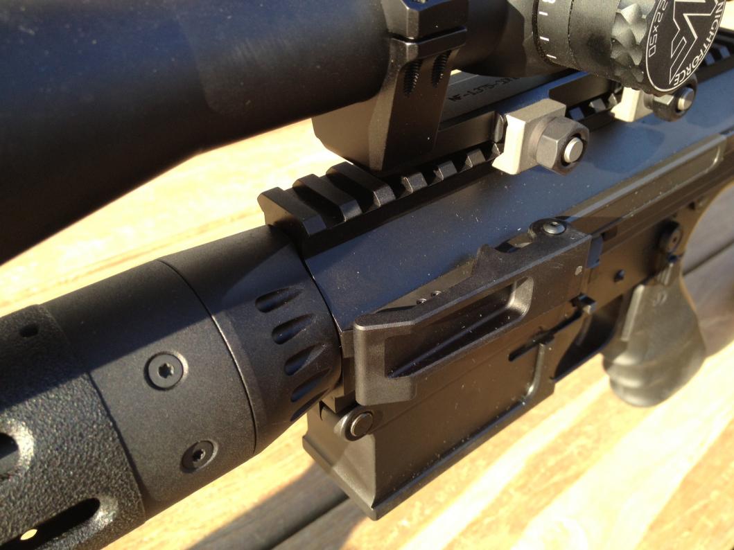

My new LRP-07 in 6.5 Creed
22"-1 in 8" twist
Silent Capture Spring
15 week wait time
Everything they tell you is true......
