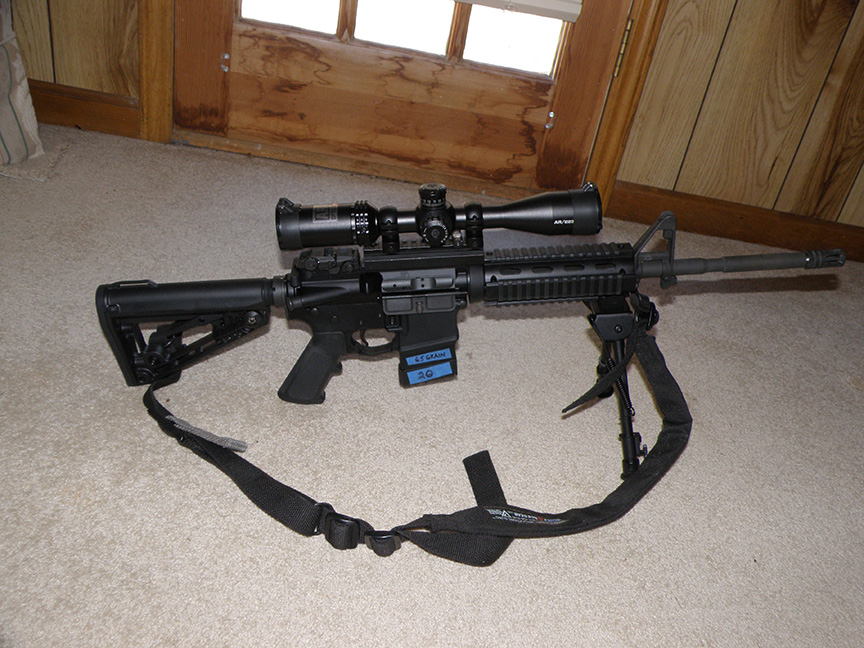

My Colt 6920 Upper shoots well with a number of different loads. Have you tried putting in a nice trigger, scope and using match grade ammo to see what it is really capable of? 1/2 inch groups at 100 yards is not what you gun was made to shoot. Although with proper load this is certainly attainable.

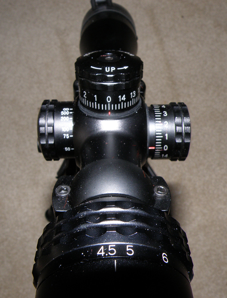

My LE6920 has a Geissele SSA-E trigger which is very nice. The scope it has is a Bushnell AR/223 (4.5-18x40mm) and I reload Sierra 65 gr. Game Kings which shoot under an inch which I killed 3 deer with this year, but open up after three shots. I did get a box of Sierra 69 grain Match Kings, but haven't loaded up for a ladder test with them yet. Maybe I'm jumping to conclusions about not being accurate enough?
I haven't free floated the hand guard yet though.

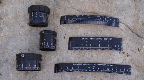

PS: I almost for got. After I get my drop chart done I'm going to add one of these to my elevation turret.
http://customturretsystems.com

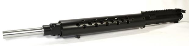

I am torn between these complete uppers the 18" (1 in 7 twist) & 20" (1 in 7 twist) to replace the upper that came with the Colt LE6920 M4. I want to shoot 65 to 77 grain bullets out to 600 yds. plus. It will be used for hunting antelope, deer, coyotes and informal target shooting. The price is the same for either so which one do you think I should get. I am a little concerned with balance so I'm kind of leaning towards the 18". These varmint uppers are both listed on the White Oak Armament web site. White Oak Armament | Complete Uppers | Varmint Uppers
Which one would you pick and why? Below is my Colt LE6920 M4 which has a Geissele SSA-E trigger and a Bushnell AR/223 scope which has a 4.5-18x40mm zoom.

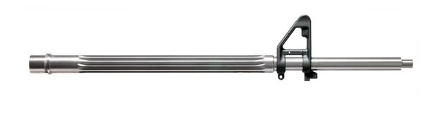

In the morning I'm going to order this 18" upper and have the barrel fluted like this one to save about 1 pound of weight.

This is the complete upper that I ordered from WOA and the 18" barrel will be full length fluted similar like the picture. Caliber will be 223/556.
