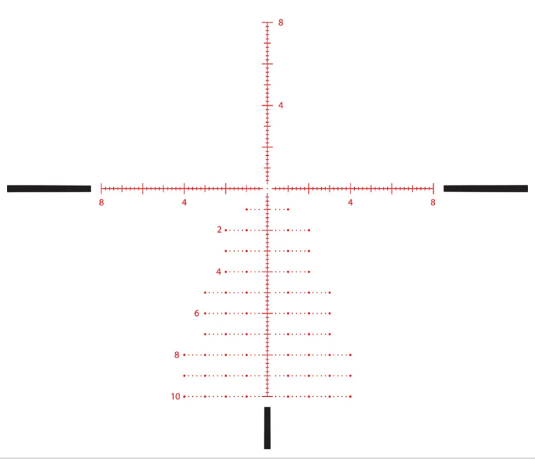

    Vortex used to have a really awesome budget scope. The 2.5-10 HSLR w the XLR reticle. MSRP was $899 but they could be had for $400 all day. It was a FFP Scope.
    It was a LOT of scope for the money and I still favor that on my “cheap hunting rifle”
    It has/had a great drop reticle that wasn’t overly complicated. I also like how the holdover was marked AND matched to the dial. A shooter could choose to hold over or dial.
    The Horus, while great, is useless for the masses and prob intimidating as well.

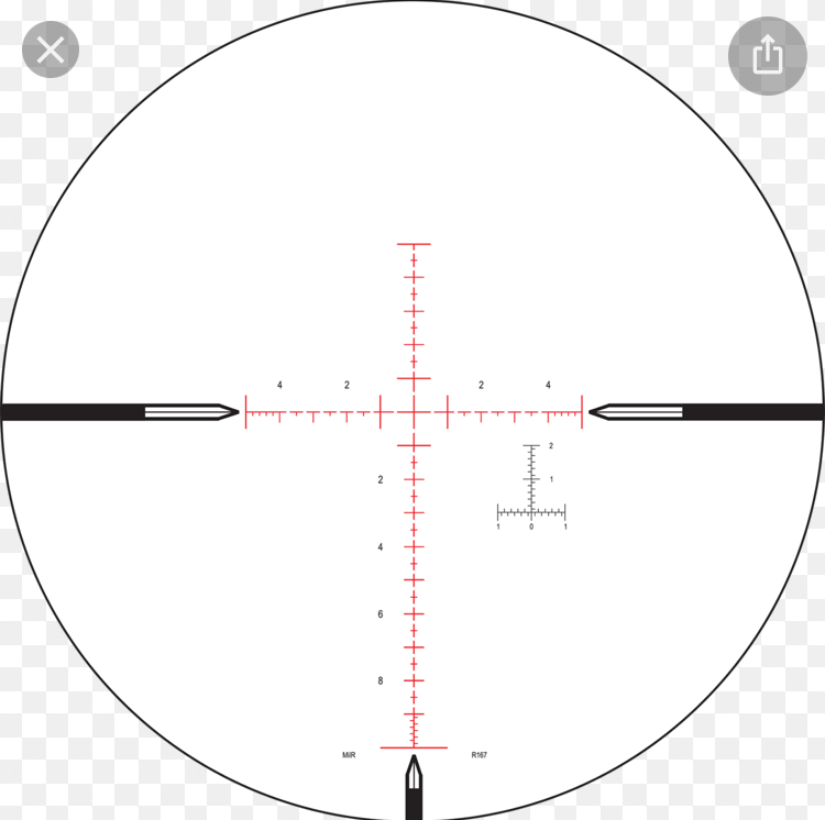

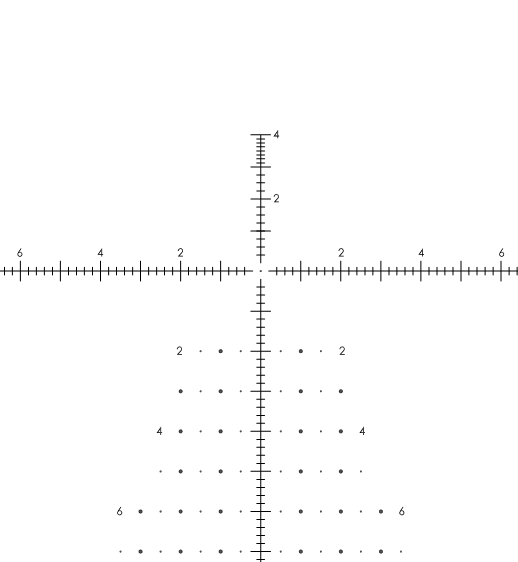

    I've shot this reticle (Athlon APRS6). I REALY like it. It was simple, intuitive, quick and easy to see through. There are very minor things I would change (delete) but its one of the cleanest simple reticles I have shot

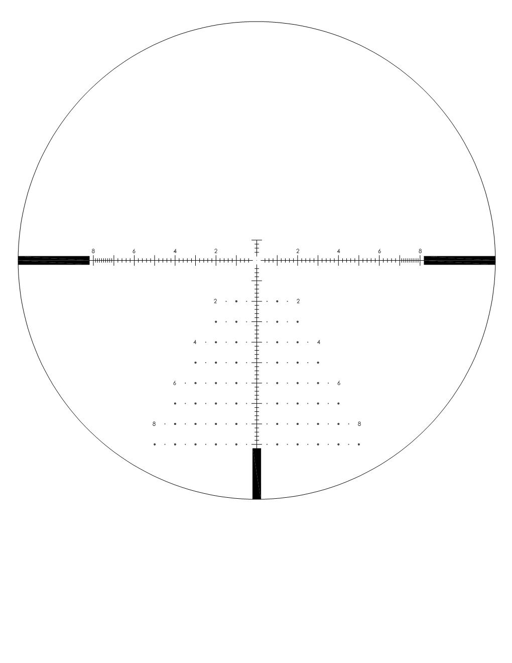

    Is it meant for hunters or PRS shooters? for a hunter .5 marks are probably good, for PRS with smaller targets .5 isn't quite enough resolution.
    The other things i've never understood is why we have trees that go down to 10 mil of hold over and out 10 mils on wind. I think most guys prefer to dial one or the other, imagine the kind of wind you're facing to need 8 mils of wind at any hunting or even PRS distance (ELR maybe) where you also think that hold overs are going to get you a hit.
    Just like making the top of the reticle clear, I think you could drop anything below 6 mils from the reticle all together and limit the windage to <=4 (maybe even 2). that would cover 99.99% of shots people take and expect to make a first round hit.
    I agree with this too.
    Who is holding over 10 mils? Why would you hold 10 mils when you could dial it
    6 mils gets 308s to 700yds and 243s out to 800 yards.
    I really think this is enough tree in the competitive world

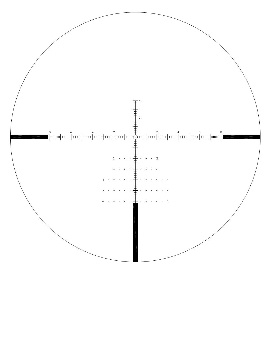

    I regularly hold 7-8 mils for NRL22. So I'd go to at least 8. We have stages that shoot 50yd - 200yd, with transitions, so I never dial for those stages.
    Why those .1's out at 7 windage? or the heavy black lines way out? Do those help people get their head straight on horizon? They just obscure if not.
    I hadn't thought about NRL22 - good point on windage if thats your game. A little different than a 6 creed :ROFLMAO:
    Reactions: lash
    .1's are used for ranging. So accurate measurement of the width of a target in mils, and then do the math to figure out how far the target is. Unknown Distance stages have been popping up here and there in matches.

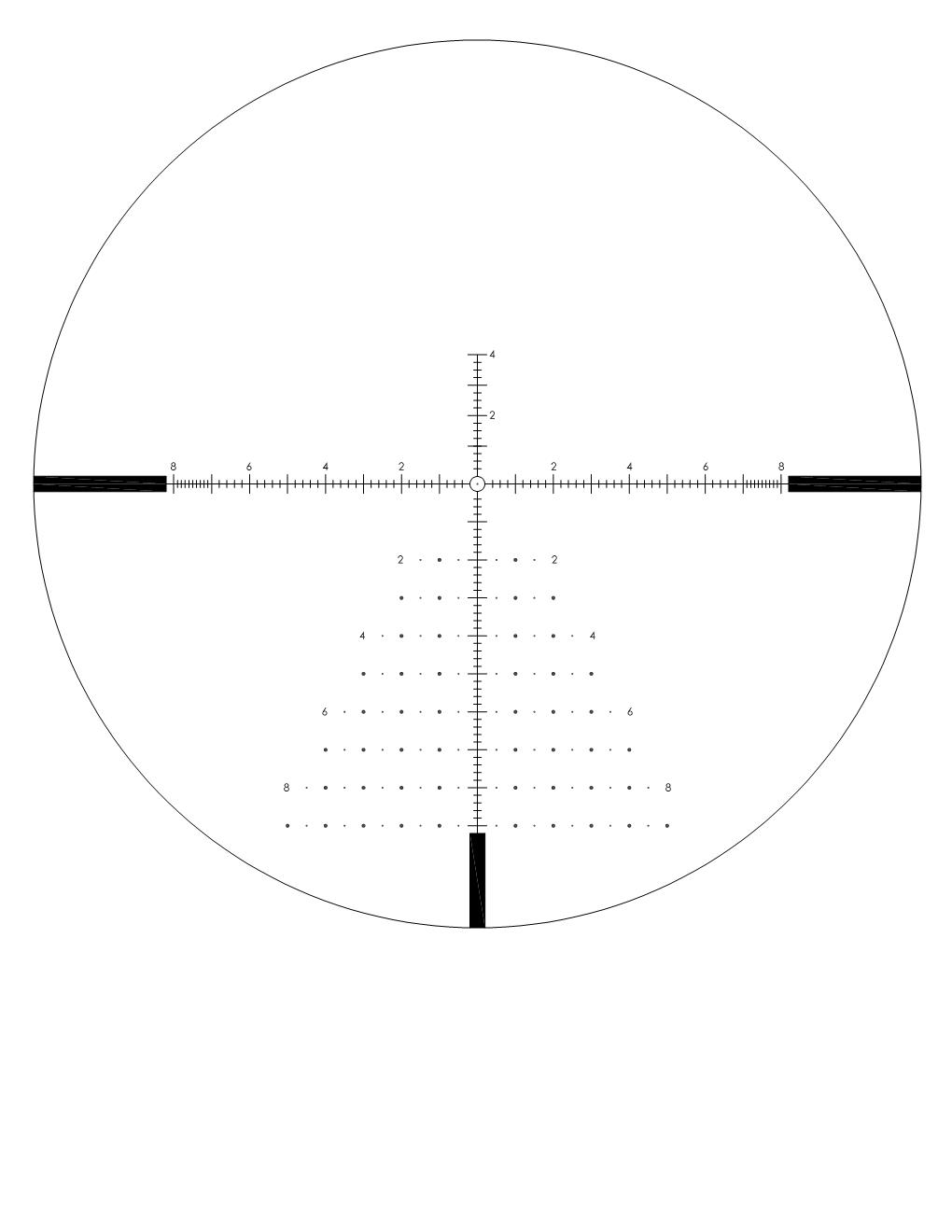

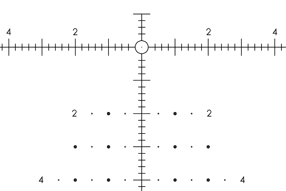

    Remove the center cross and make it a dot. Remove the measuring grid on the right. Add a tree on the bottom from 2 to 8. On top, put a number at every mil mark.
    • Love
    Reactions: iceng and SRPowah

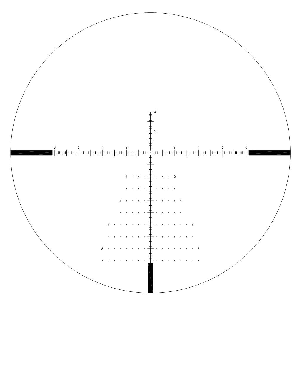

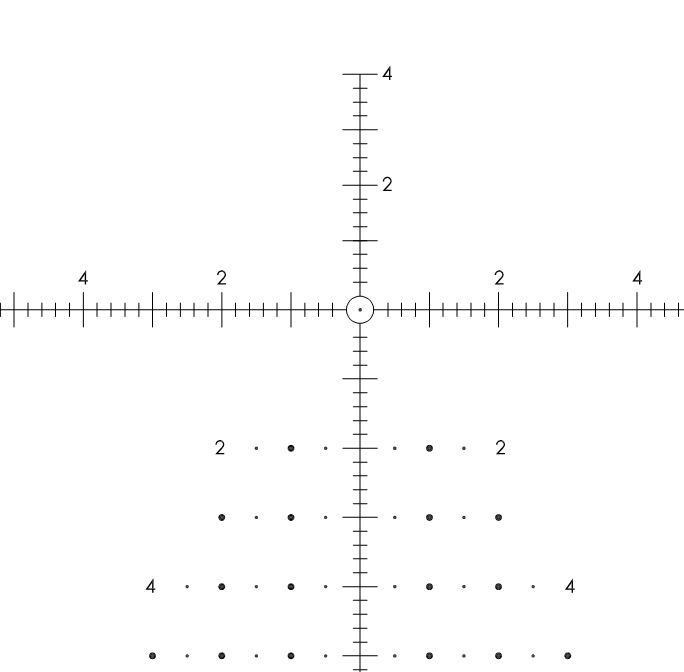

    This would be my final design at this reticle.
    This reticle has 4 mils above the horizontal main stadia with 0.1 milling bars in the top mil.
    I kept the 9 mils of tree height but trimmed the edges of the tree a bit to limit the width. Could add a 10th line the same width as 8 mil if needed.
    Circle or no circle is a big question. Some will hate it, some will like it. I could really go either way. I think the circle would make the reticle more useable on lower powers.
    0.2 hash marks are 0.1 above and below the main stadia. (0.2 mil total)
    1 mil hash marks are 2.5 mils above and below the stadia (0.5mil total)
    Center dot is 0.05mil (3/16" at 100yds) - this could be changed if needed. (0.085 would be a 308 bullet at 100yds)
    Tree dots are 0.1 at the full mil and 0.5 at the 1/2 mil
    I struggle with not having something at the 1mil hold over tree mark. Adding just a 1 mil and 1/2 mil dot might help this area but I know Frank wants it open.
    Ya that reticle is about perfect with the changes
    The circle part I can go either way because it has the center dot and it gives it better definition outside the direct center.

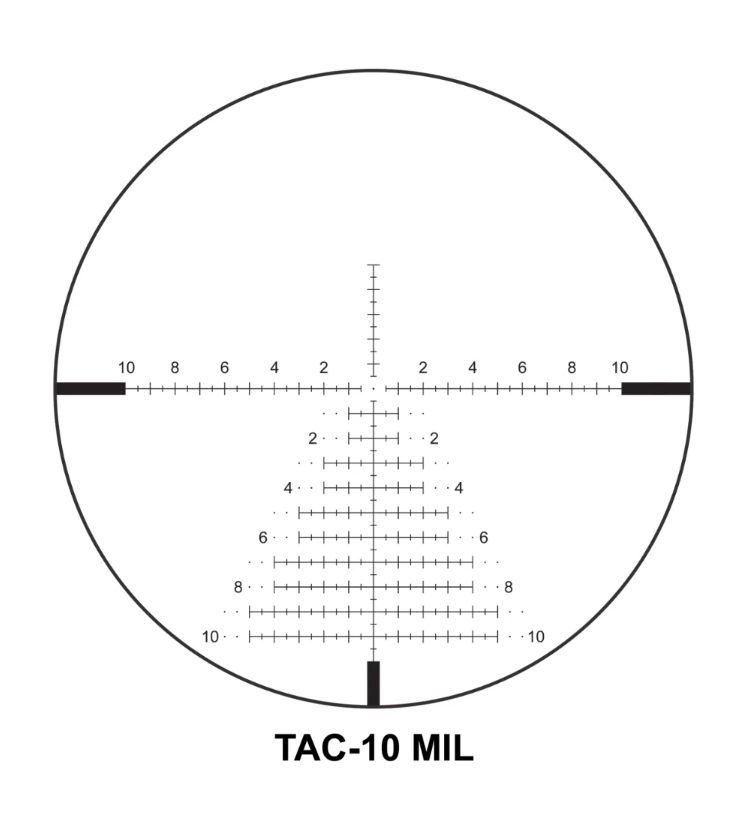

    You don't want those connected lines like the Tac 10, those things block impacts
    Reactions: ZG47A

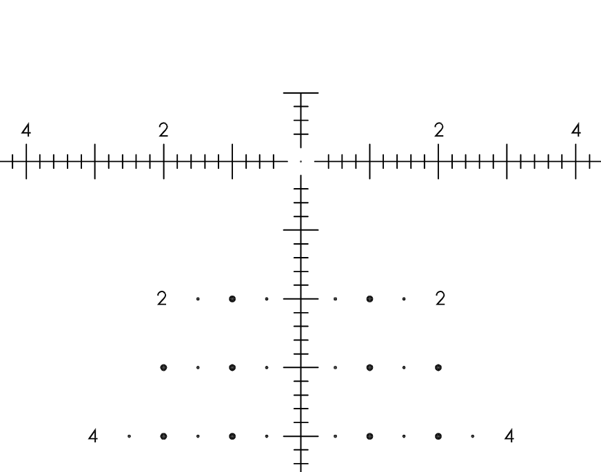

    View attachment 7593903View attachment 7593904
    Fuckin win, dude! Thats it!
    Now that's a great reticle!!
    That’s pretty close to perfect and what every scope manufacturer should have as an option.
    I’d just have the wind dots all 4 mils instead of taper out. The ranging sub tensions be between 1-2 mils because nothing more annoying trying to measure a target and doing it on the edges of the reticle. Remove the numbers at the top and make the rest of the numbers a tad smaller. Otherwise it’s mint.
