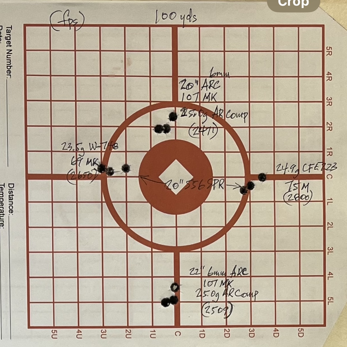

Love those SA piston kits. Here’s a pic of what my 20” 6 arc and 20” 556 (top and middle) will do compared to my DI 22” 6 arc. And the only reason the 22” doesn’t have one is SA doesn’t make a .875 piston kit. I know they’re only 3 rd groups but these are to check zero as I’d rather use up my ammo hitting steel than punching paper these days
