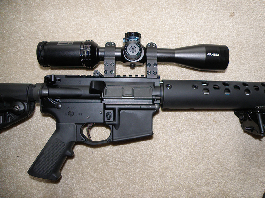

What height do you need for a good comfortable cheek weld? I have had a problem getting the correct one for me. I need 1.5 inches from the top of the Picatinny rail to the center of the scope tube. I ended up using a Warne Ultra High QD aluminum rings which are very light, but strong and have shorter ones in 30 mm rings also. I also have a Bushnell AR/223 scope with 4.5-18x40mm zoom which has tactical turrets which are accurate as my Vortex 6-24 PST FFP MOA scope.
You can see how it is set up in my picture. You can also see the end of the B-SQUARE bubble level just left of the rear scope mount which helps shooting long range.
OOPS now I see that your scope has a 34mm tube.
