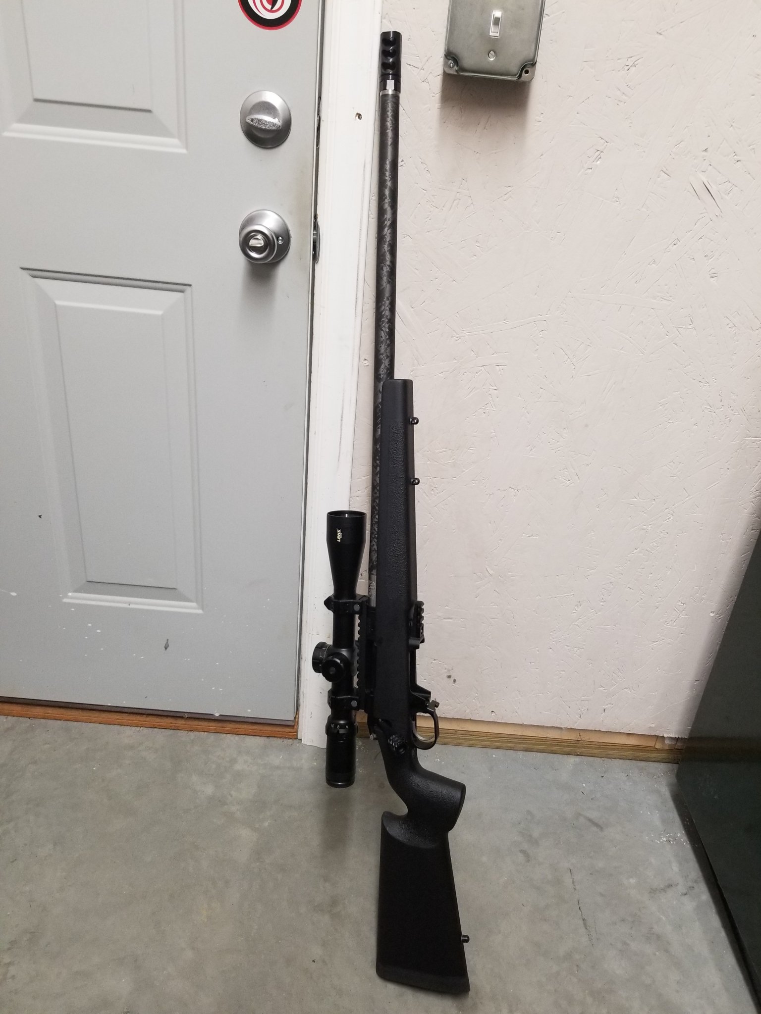

I have a few rounds down thru mine, and will say the weight savings is noticable when hanging a brake on the end of a 26" barrel. Brake performs as good as its heavier counterpart as well.

I’ve been running one on my 300 wsm.... all I can say is ultralight is an understatement. When the box came in the mail I literally thought they mailed an empty box.
Performance has been really surprising for such a small and light muzzle brake. I’ve been really happy with it and wouldn’t hesitate to buy another or recommend it.
