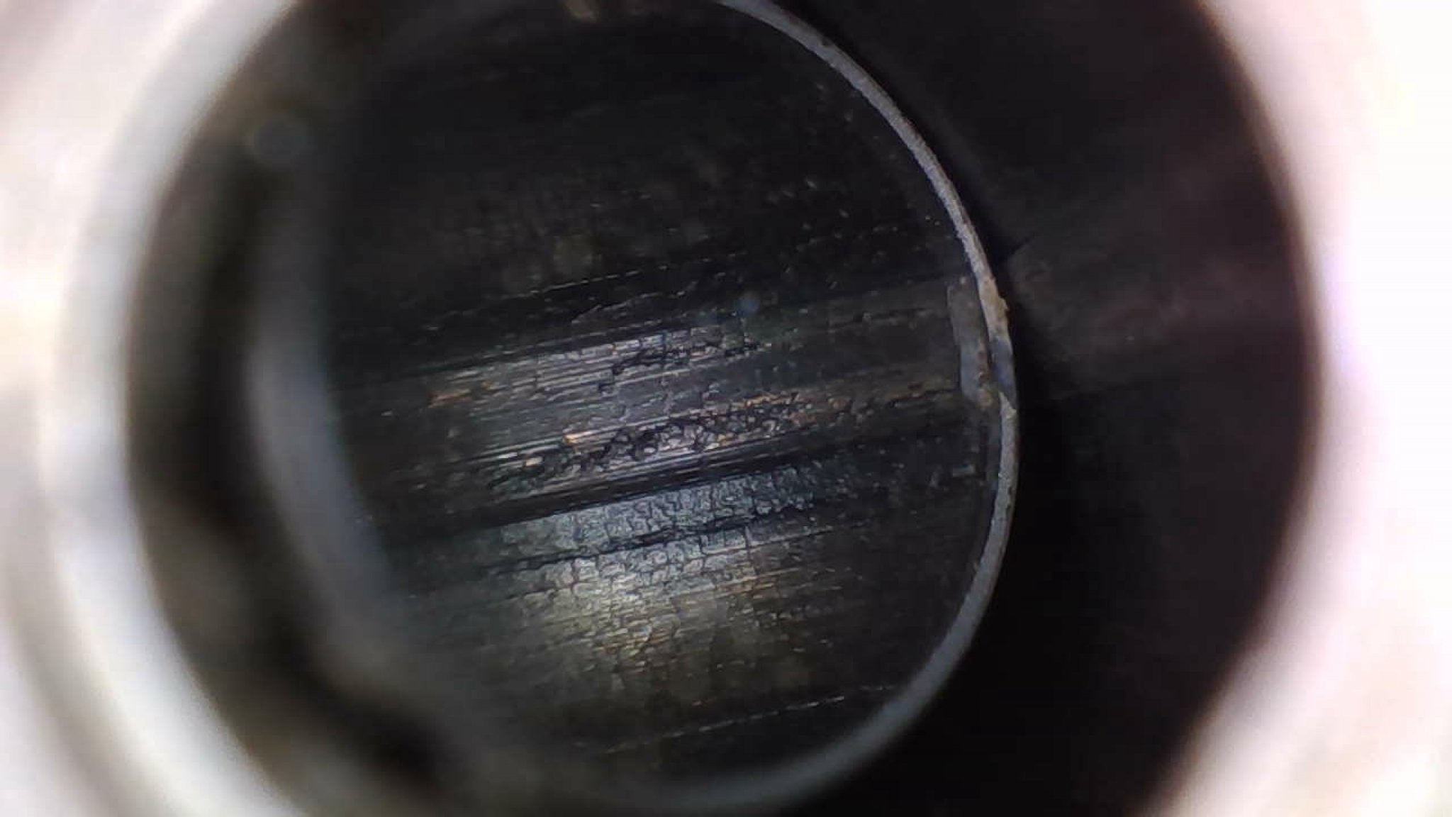

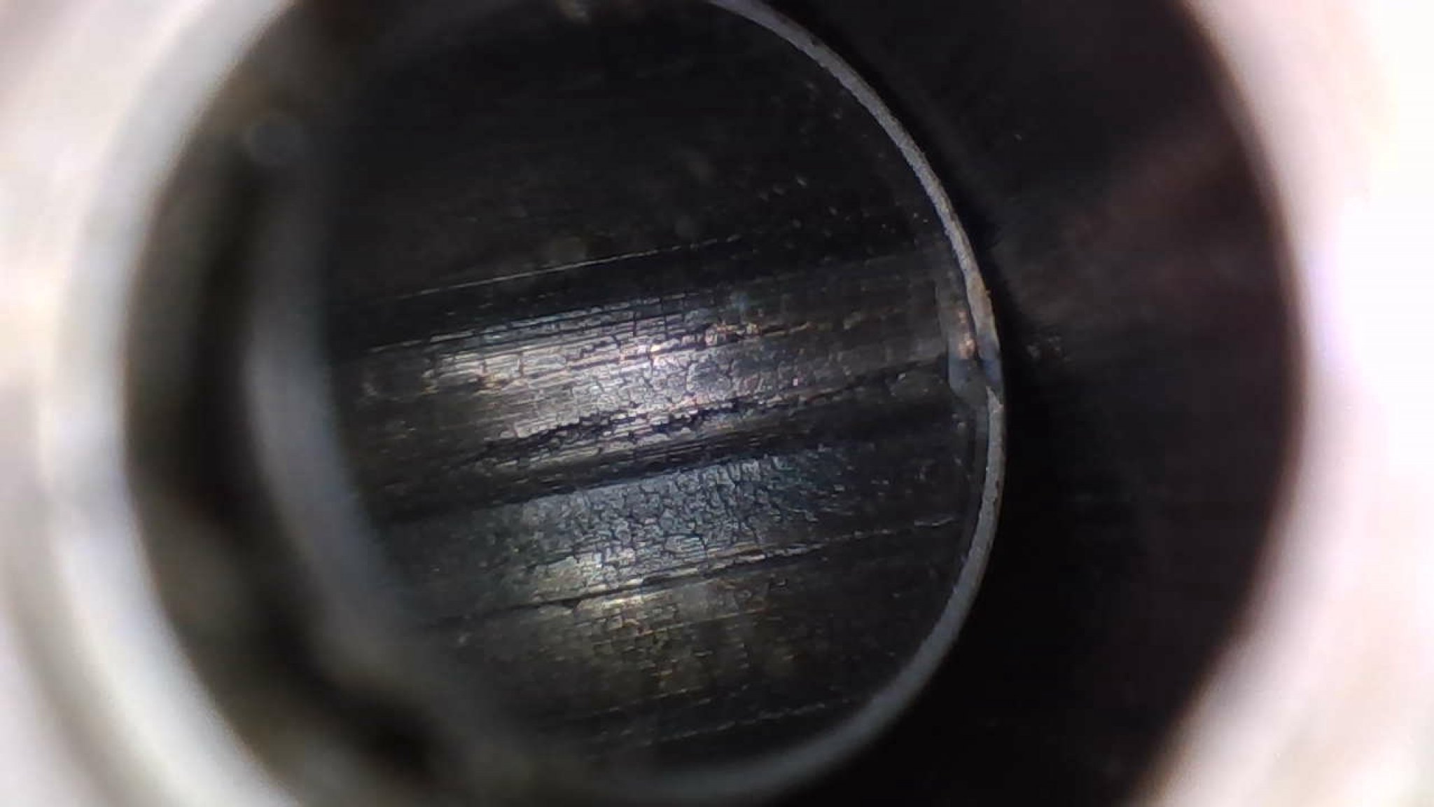

1600- 1700 rounds through this barrel. All but 100 or so my loads, 6.5 CM, 142 SMK, 40.4 Gr H4350, Lapua brass, Fed 205M. Run about 2625 to 2640 over a Labradar. I looked at it 150 rounds back and saw a little bit of chipping, but nothing like this.
If you're unhappy with the accuracy, change the barrel. It doesn't matter what it looks like at that point. I've seen barrels shoot way past their life expectancy and I've seen barrels that get shot out early.
Reactions: Bradu
Clean it and maybe adjust your load a bit.
Pics really won’t tell you much, my first 260 barrel looked a lot worse and it was still hammering.
Yea, run it. I'd stop cleaning copper out unless you have serious accuracy or pressure problems. After 1000-1500 rounds most barrels look kinda ugly, especially in the first 2-4" of rifling.
Proof is in the pudding, though. If it starts throwing nasty fliers (over 1 MOA) I'd ditch it. My last 6.5cm barrel made it just over 3000 and started throwing some wicked fliers. Most everything was good enough (3/4 moa or better) but the fliers would stretch it to like 1.5-2 MOA.

Looks like some moderate fire cracking but the only thing that really matters is how it shoots. If it's still shooting well then keep it, if it's fallen off below what you want then rebarrel.

I've only cleaned copper twice, the last time was about 150 rounds back. Both times I cleaned it, it was because it started shooting right by 5-6 inches at 500.
Don't think there's a carbon ring in those pictures, they are about 4 inches past the throat.

Once they fire crack like that they go down hill fast. The crack deforms the projectile taking it out of balance and it will have a corkscrew like flight path that gets bigger the further it flies. If you race cars you burn up tires, if you run guns you burn up barrels. The price we pay to play the game.
Yep.. Went from the gun outshooting me to me out shooting the gun within a hundred rounds or so. Has gotten steadily worse. Smith called today, new gun is ready, just in time.
