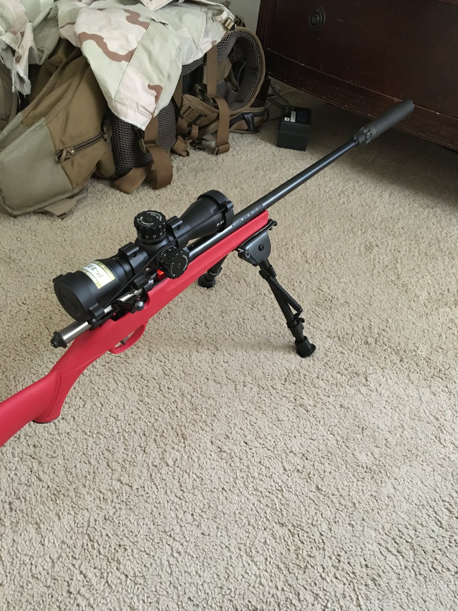

Zak has the clean answer. But I had my sons Rascal threaded 1/2 - 28 then added the adaptor just like you said. Works great for my TBAC takedown!
ZY
Not the TBAC on it but you get the idea...
Some of the different adaptors mentioned in other posts had different threads on the barrel to come up to the 1/2 - 28. I should be safe with a standard 1/2 -28 thread job and then add the adaptor?

With regard to ZY100's adapter photo-- be aware of the (lack of) thread relief cut! Just make sure it's shouldering up. Sometimes the lack of a thread relief cut can prevent the rear of the suppressor from shouldering up to the barrel or adapter shoulder.
