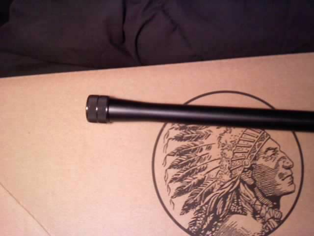

    You have enough barrel to go with a 5/8-24 but will have a very small shoulder. You can make a larger shoulder by threading the barrel long and making a 5/8-24 threaded tapered bushing. The bushing will thread on first and leave the required .600 length for your suppressor to thread on giving you the shoulder dia. you need. Remington makes a Model seven this way now, and I have noticed several others over the years. I also made one for myself a few years ago and works great.
    Do you have any photos of it ? I want to confirm the mental picture I have of what are describing.
    Savage uses the same concept on their SR(suppressor ready) barrel profile. Sporter weight barrel with a shoulder added to the profile.
