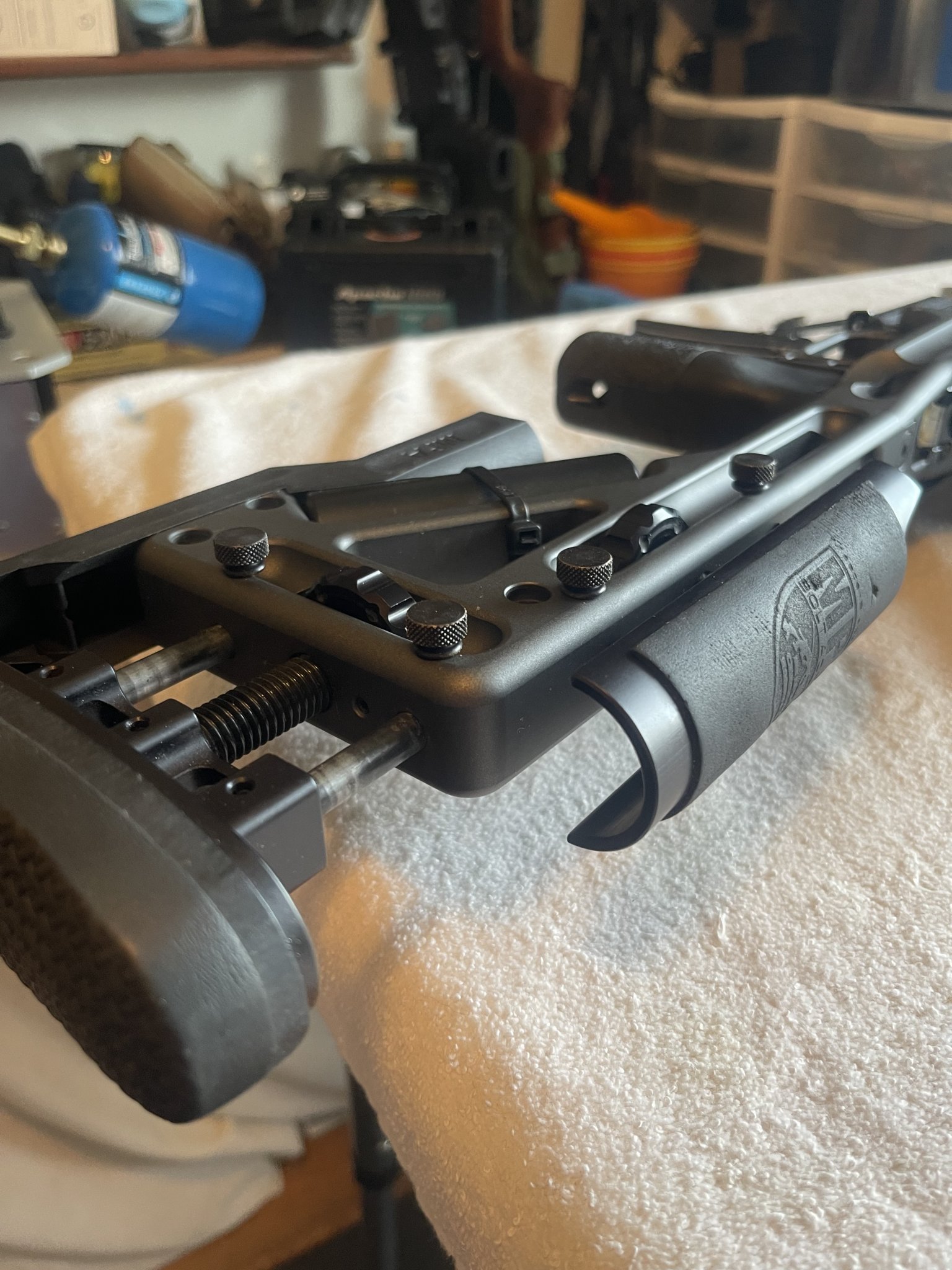

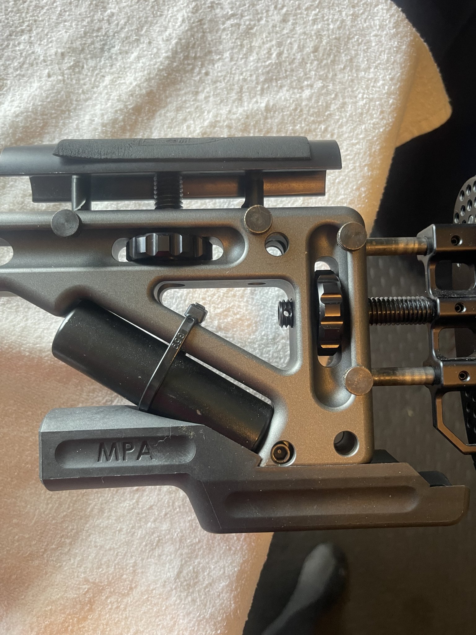

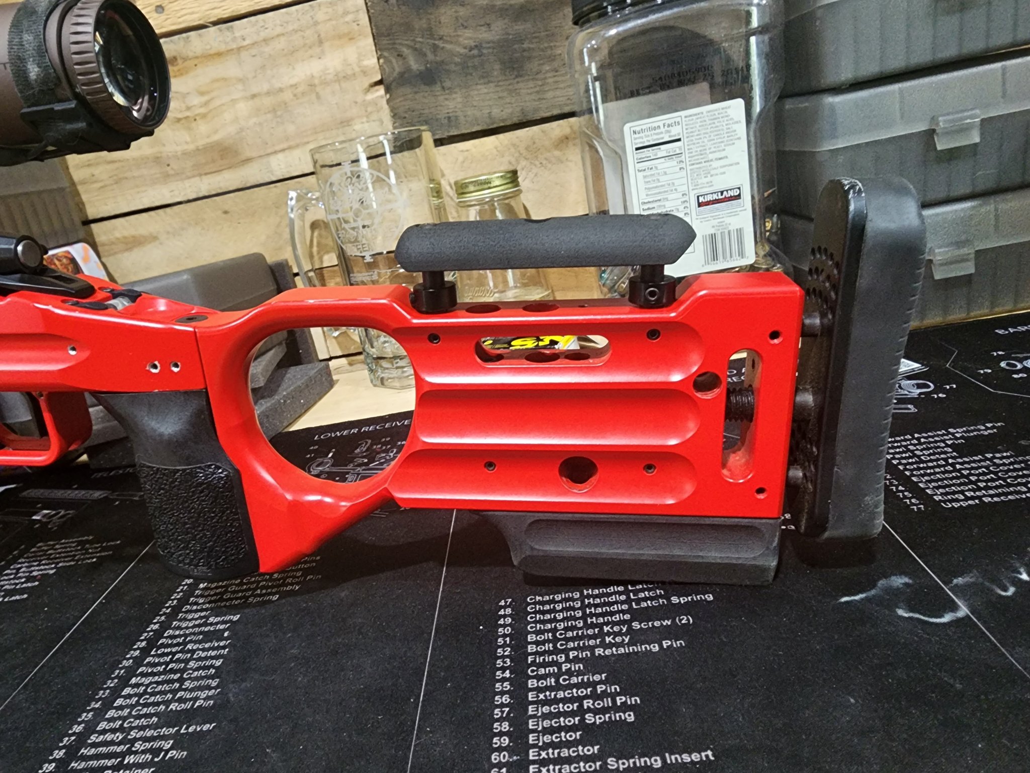

    Just an fyi for anyone looking to do this. I bought a MPA comp second hand. There were no set screws for the cheek riser or butt pad. Both of which are annoying loose without them.
    Purchased some 8-32X1/2 knurled thumb screws. Just fyi the 3/8” are to short. I cut the 1/2” down just a touch
    A dab of blue loctite. Worked the screw in and out and allowed the loctite to dry. Just enough resistance when I thread it back in to snug by hand and not vibrate loose in its own
    Found the screws on eBay for $10/10 pack

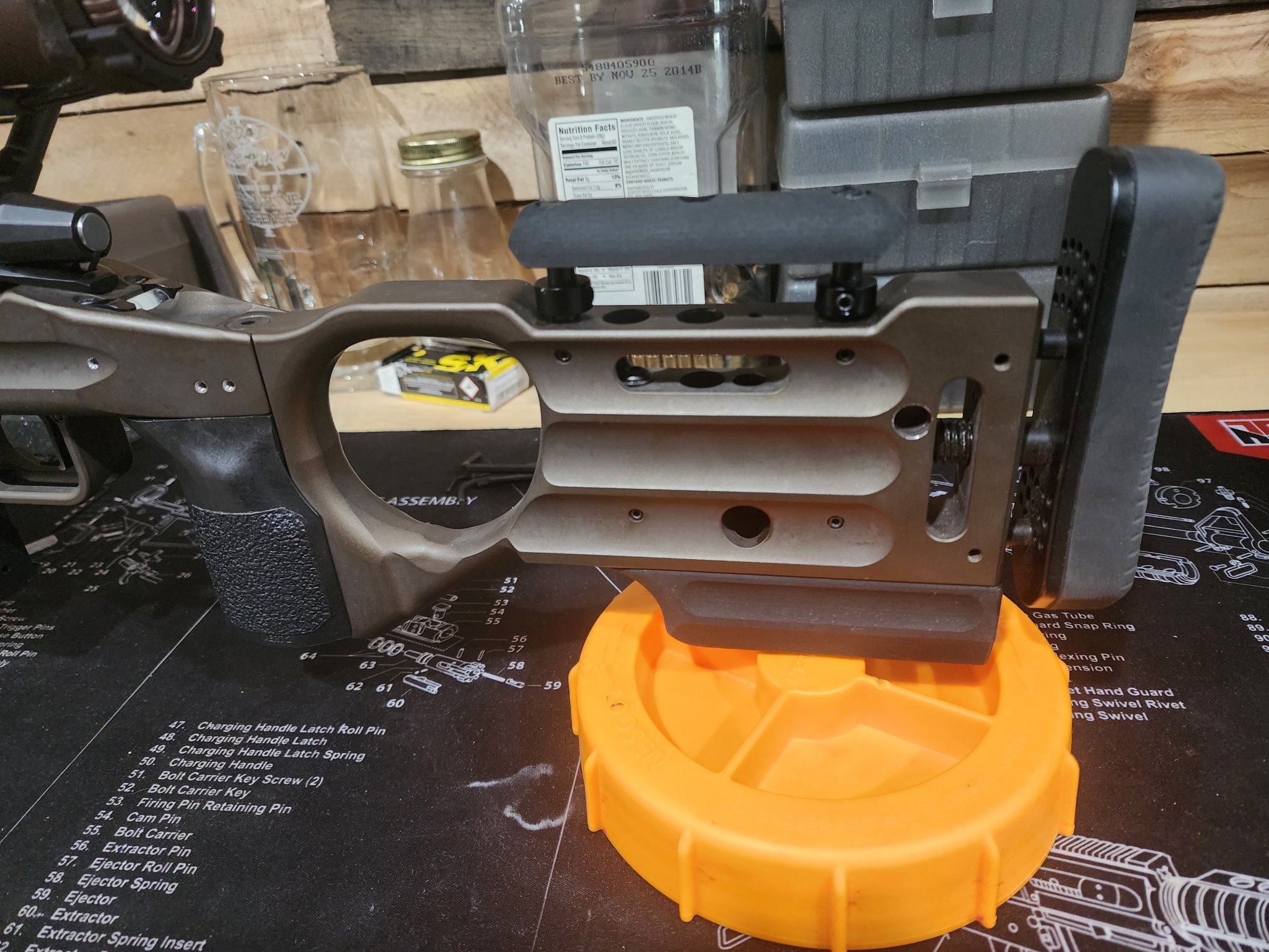

    Good info Hafejd30. Might have to try and get some of those. I have actually used some of the collars mentioned and they work really good but something else I have started doing, especially to the butt, is take the wheel out of its spot and put it on the outside and use it as a reference point. I wrap a little electric tape behind it so it doesn’t move from that spot and then just loosen the two set screws and it pops right out.
