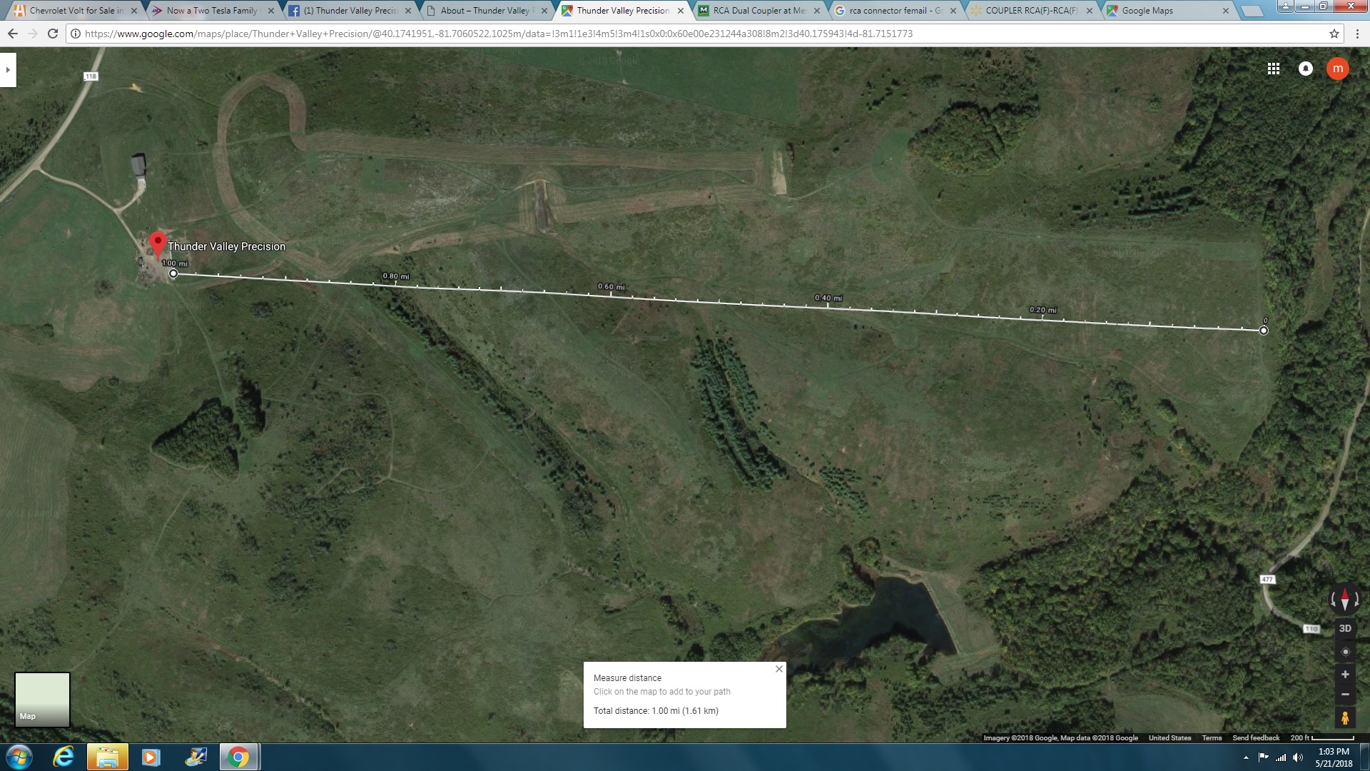

Oh, I played around with google maps too. Here's a picture using the distance tool on google maps. It shows the distance is 1 mile from shooting tables to the treeline. But the targets are not at the treeline. Is google maps measuring tool accurate?

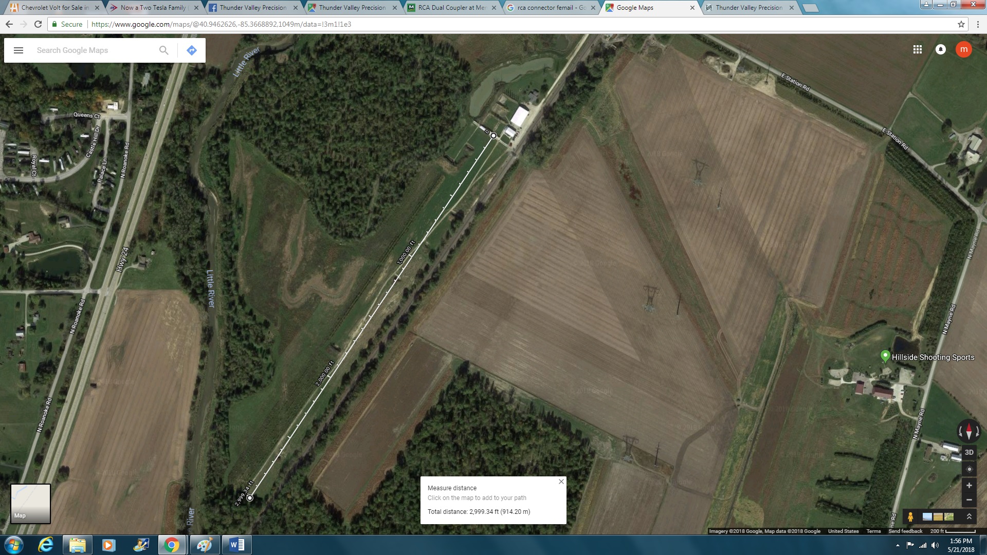

Here's a google map distance at Hlllside which confirms the 1000 yard tool agrees with their distance and also my laser range finder.
Stumped...
Mike

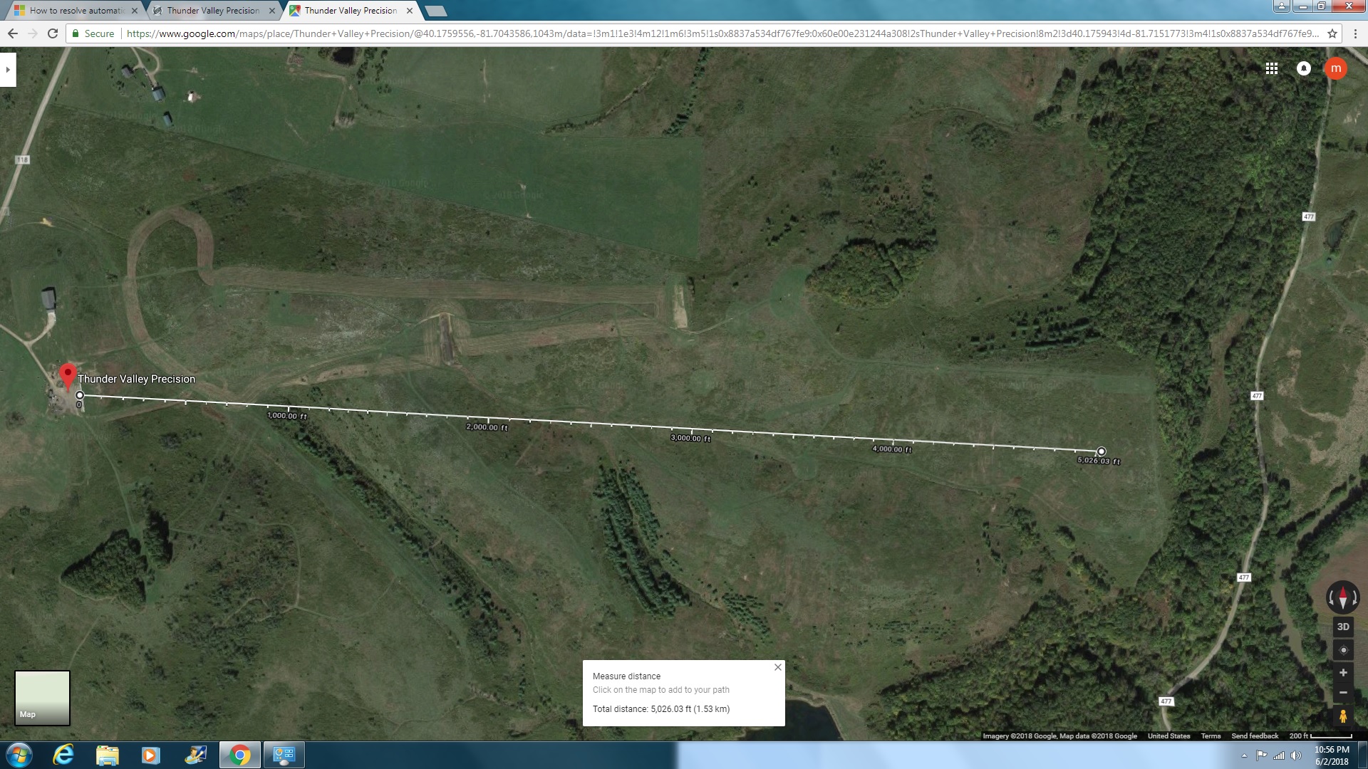

The "mile" targets are 1710 from the covered shooting bench #14 according to my vectronix.
MACHTECH.... Thanks for the update!
This distance confirms my 285 ELD Ballistics and my 300 SMK.
Here's a google map measurement of 1710 yards. Which corresponds to the "1 mile" targets placed shorter than 1 mile (5280 feet/1760 yards)
