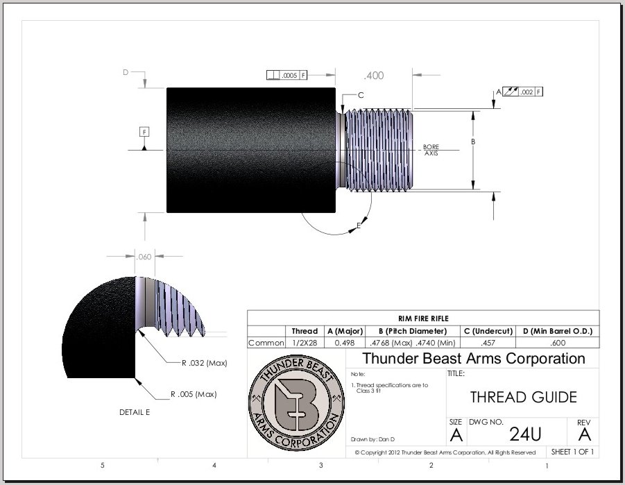

    I came across a strange problem today. While out shooting my new Bartlein barrel on my CZ, I noticed that it is threaded 1/2x28 but the threads are about 0.600" long. Significantly longer than any other .22lr I have more like an AR. My YHM Mite will screw right on but my uncles Silencerco Sparrow would not. It bottomed out before the shoulder. It has a stop built in that I guess is to keep it from screwing onto AR threads. My question is: will the TB .22 takedown screw onto my barrel?

    Rimfire thread specs
    You can use a spacer to shorten the effective length

    Stick with the 22 Take Down. Longer than .400in threads on a .22lr barrel are common. Just put a purpose built spacer on the barrel to take up .200in. This shortens the effective length of the threads, as Zak wrote. I have successfully used a few
    That's just a little to jerry rigged for my liking. I realize that Bartlein's threads are what is out of spec, but I already have that part.
    What is the diameter of those spacers, I dont see it listed.
    I realize the hesitation to use a thread spacer. It seems like a band aid that most people don't like. But it's a 22 and it won't effect anything. They are really just a threaded washer that will let you use whichever can you want. The other issue is that if you used a can with shorter threads than the muzzle tenon, you could very well lock the can onto the barrel. That's not a good position to be in.
    My recommendation would be to take the barrel to a smith and have them trim the muzzle to .400, which is the standard for rimfire. They shouldn't charge too much for this, it's very simple. Secondarily, order a thread spacer from a reputable company in the diameter of your barrel. It will be square and won't hurt your accuracy one bit.

    How are Bartlein's threads out of spec? Talking with Frank they are book spec. I just measured my Bartlein 22lr CZ 455 barrel, they measure exactly 0.600" as well. I also just measured 2 Keystone Green Mountains, 1 is their 22lr AR barrel and the other their CZ 455 22lr from the group buy. They both also measure 0.600".
    I just measured the depth on my Rugged Oculus22 and depth to first baffle is 0.85" and my QuietBore Titanium Form1 can I built is 0.75" to first baffle.
    Maybe "out of spec" is not the right term. Not meeting the standard convention for rimfire cans might be a little better.
    I will say that when I was having barrels cut for cans some of the companies were a little hesitant to send internal thread drawings like the one TBAC provided above, so I had to take measurements myself on the cans I still had in jail at the time.

    0.600" does not seem to be the industry standard for rimfire. All of my other rimfire guns that are threaded are around 0.400". 0.600 is pretty standard for center fire so maybe that's why keystone and bartlein cut them that way. I ended up buying an oculus. Thunder beast and silencerco cans will not work on 0.600 threads.

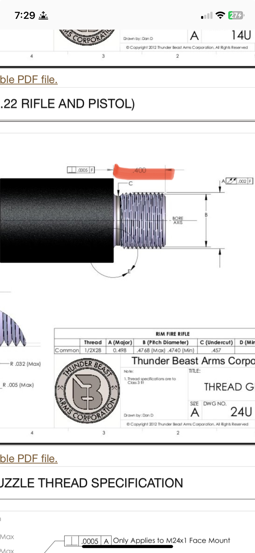

    Old thread but I have a td22 and just got my ruger mark iv back.The threads are 0.4375
    My tikka tx1 is .4895
    Do I need to run a spacer?
    Tbac emailed me back,said it would be ok on the mark with a peel washer but the tikka needs to be turned down to .400 unless it’s already at 16 inch.

    I know you said no on the spacer, but I run a Christensen Arms spacer for my TBAC 22TD (Mask fits fine) on my Christensen Arms Ranger 22, because it has ultra long threads like your rifle. The spacer is milled flat on both sides for concentricity. They're very inexpensive. My groups have not had any affect, positive or negative. The only thing the spacer did was move the can out about 1/4" to clear the baffles.
    Have had the td22 on multiple tikkas now and they have all been fine. It’s damn close but not touching the baffle.
    I had the same concern, but it hasn’t effected accuracy and I havnt seen a need to re thread.

    Measured not just the threaded portion but the whole extension and it runs pretty close to .5” on my chinesium calipers.
    I measured the whole distance as well
