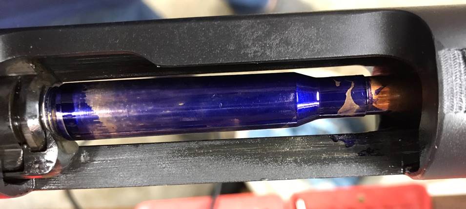

    The builder is finding that my brass is "bowing" just ahead of the bottom of the case.
    He had applied some blue dykem to show the contact on one of my rounds....
    He also conducted this excellent analysis sheet of some various ammo I sent him to function check in the rifle. Note the Lapuas are not reloads they are factory manufactured with new components at Creedmoor Sports, purchased from the CMP....
    GetAttachmentThumbnail
    My ammo doesnt look that out of whack except for just above the case head section H...

    Im wondering if the aid to progressive loading Dillon includes in its die design might be the issue?
    I think I may of actually set my dies up using the Creedmoor ammo as it has such a great reputation.
    Thinking of running a Redding FL size die after my Dillon trim die to work the bottom of the case.

    I think you are seeing slight case head expansion in your Garand rifles that is not compatible with your tight chamber '70.
    If you can live with using only dedicated brass in that chamber it should be fine. Otherwise a small base die may be in your near future. Redding can make one up for you. Not real expensive. 75-100?

    That particular piece of brass I sent him is on its 4th loading, nothing hot - 46 grains 4064 and a 168, but if its a big chamber and a Dillon die cut like a magwell it might be the issue. Ill be sectioning one to look for casehead separation or thinning.
    In the future my size die is going to be set up specifically for the Model 70 and the milsurps will use what is produced for it. I will be getting a few more boxes of Lapua brass to dedicate to the 70 but I also expect to use the other ammo on occasion.
    Kind of surprised because the Dillon trim die is cut pretty tight, some say it is a small base die.
    Thinking a Redding FL die after the Dillon trim die, will iron out that slight blowout. Ill probably set the trim die to size .001-.002 over SAAMI than use the Redding to get to 0 SAAMI or -.001.
    That would solve my reload issue. Dont know why the Creedmoor ammo wouldnt work though.
    He opened the chamber a slight amount. Ive asked him to fore one of the Lapua rounds and look for good extraction/ejection.
    If he doesnt have to palm the case from the chamber the slight relief may have fixed the issue.
