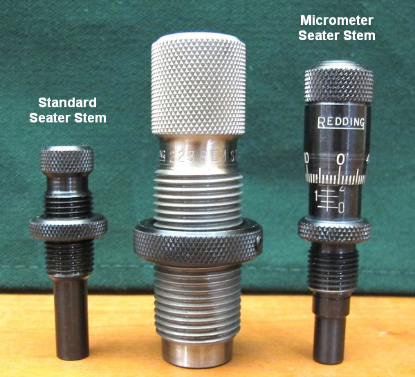

Micrometer top for the seating die? If your current die doesnt have one most brands will offer a replacement/retro fit.

Whats a chamber die? And what do you mean the "standard" rcbs micrometer dies?
(I assume by chamber dies you are referring to your wilson inline seater die.)
And that the standard rcbs is either their standard seater with a micrometer retrofit or you have their competition line which isnt a standard die.
In any case, thats how long it takes me to adjust my micrometer. You just have to spin it how much you want, set it down and pull the press handle. Nothing earth shattering.
Standard die is the one in which the micromeer you pictured above is threaded into.

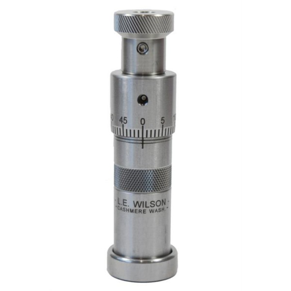

Micr chamber-type seating die:
7097331
Is all I use for precision rifle. Gets concentricity and OAL right all the time.
So a "standard rcbs seater with a micrometer retrofit" then if you have a micrometer and its not their competition line seater.
To avoid other future confusion those wilson style dies used on an arbor press are called inline dies (EDIT: By everyone else in the world other than the example of one).
I guess if you get a blank and use your chamber reamer you would sort of have a"chamber" die but the common term is inline.

No die gets OAL correct all the time. They are only as accurate as the bullets are uniform. Variations occur in all bullets. Base, meplat and ogive.
Set them up on a dial indicator and it will drive you crazy.
Understood.
The "inline dies" are better, in my experience, at "getting it right all the time.""... as much as variations in the actual bullet will allow. (Do I *seriously* have to note that bullets vary due to manufacturing tolerances ?)
NOT saying other high end match grade dies can never "get it right." I just like the "inline dies" better.

To avoid other future confusion those wilson style dies used on an arbor press are called inline dies.
The manufactuer calls them "chamber type bullet seater dies with micrometer adjustment."
Their email is "support(at)lewilson(.) com so you can inform them of their error in naming their product. :)
Me? I don't really stress at all over what they are called. :) I'll call them "inline dies" ***IF*** it'll help you. Just let me know.... :)
