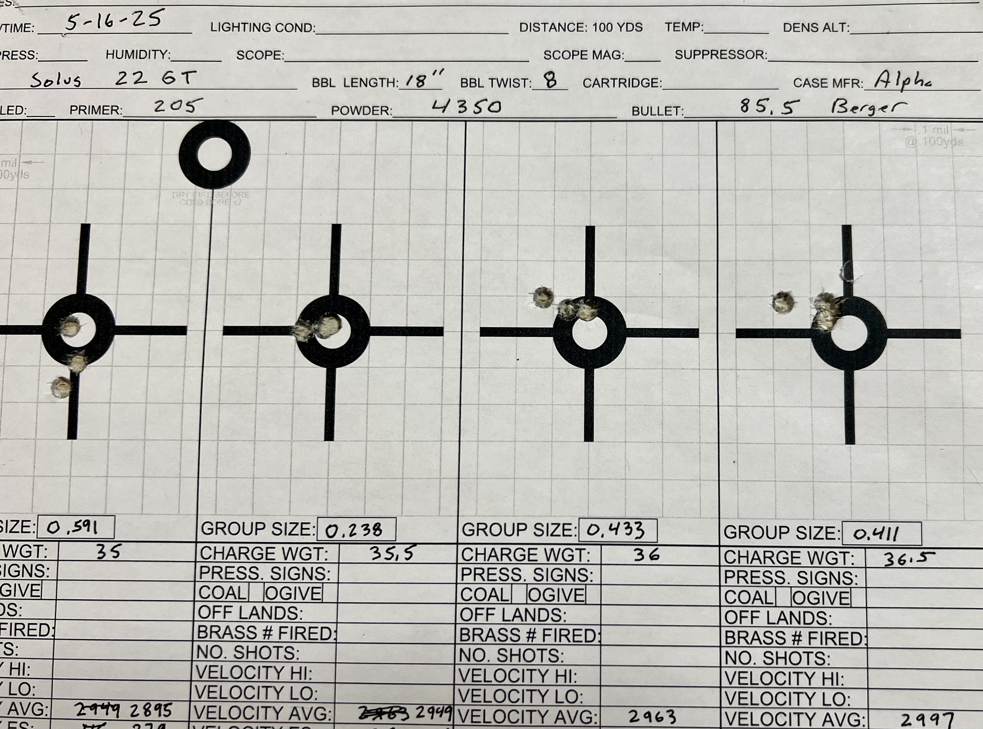

I am leaning towards it being ok. I chucked my modified case in a drill and sanded the body down a tiny bit so that I could easily insert and remove it. I was having difficulty measuring the OAL with so much force being required. Now it drops right in.
I loaded up some ammo and tested it out today. It shot great and no issues extracting the fired rounds.
