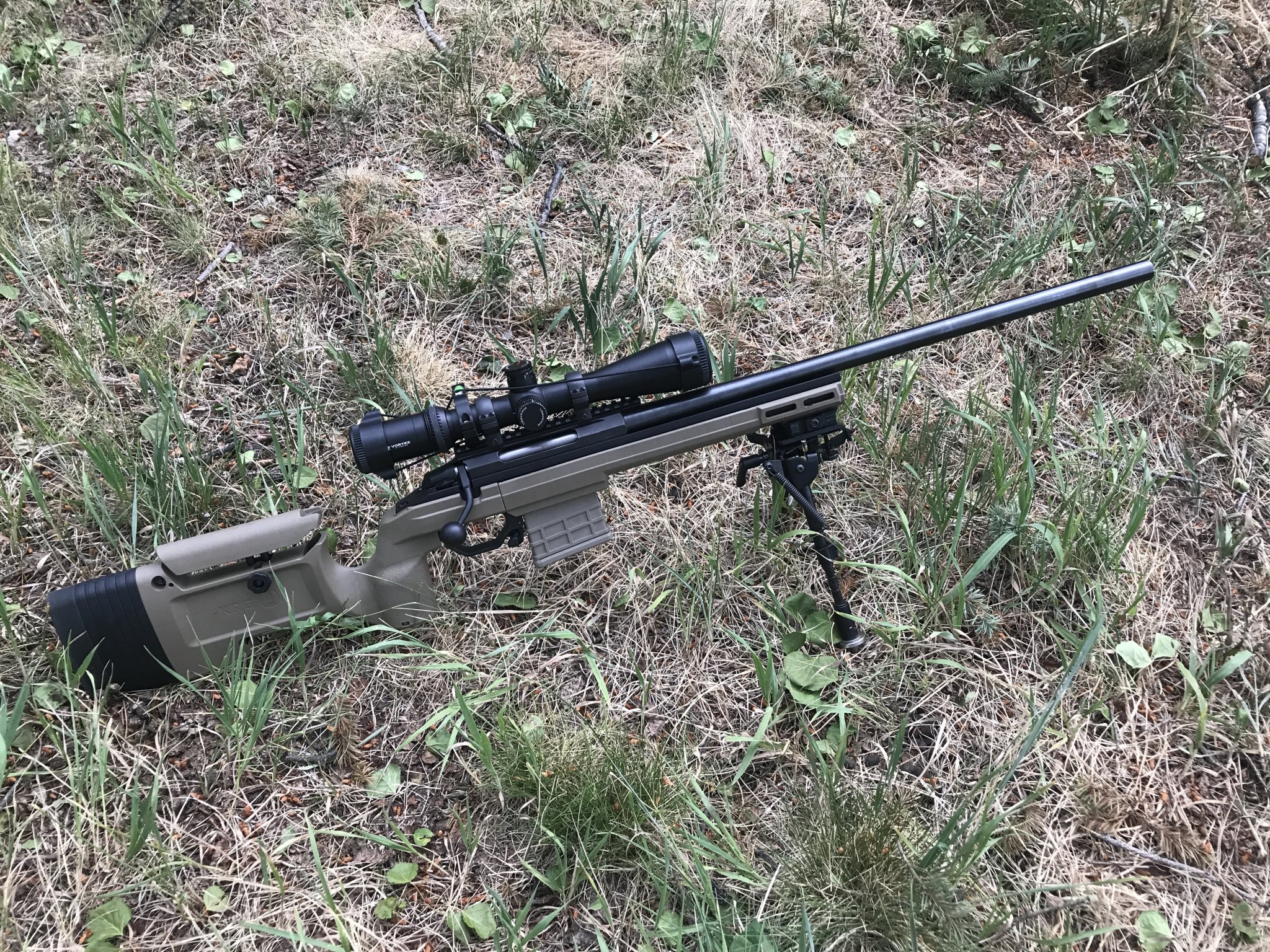

I'm running an MPA chassis on it, though I have a Tikka Bravo as well for another rifle (6.5CM). I'd think a Varmint in a Bravo chassis would be pretty easy for a solid rifle system.

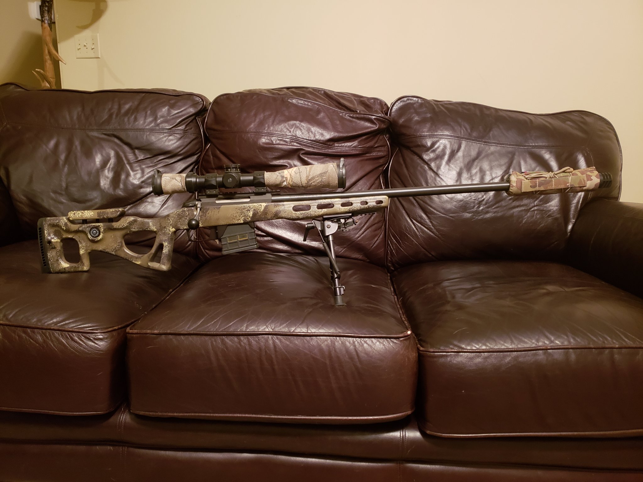

Mine is in the GGS Ranger with Mountain Tactical AICS bottom metal.

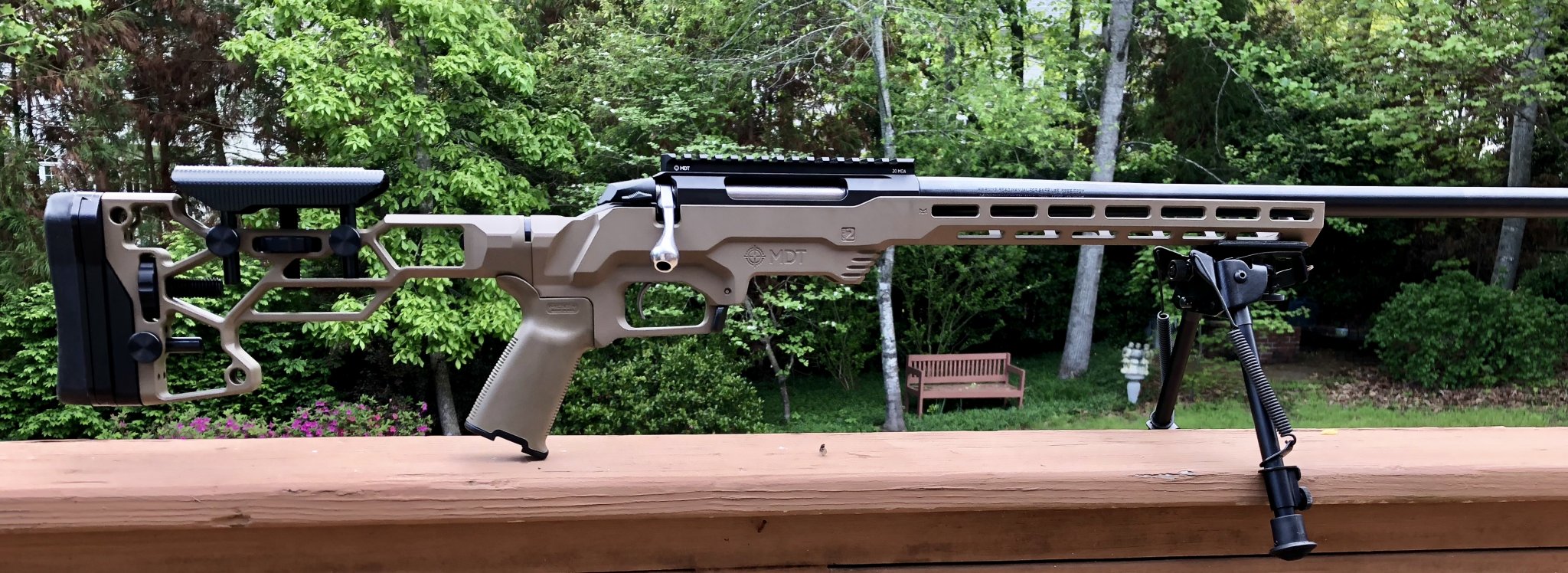

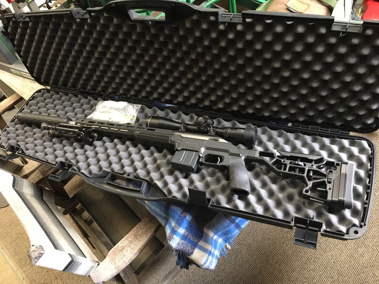

Here is my Tikka T3X Varmint (.223) in an MDT LSS-XL Gen-2 chassis with MDT Skeleton stock, with MDT 20-MOA rail. (not shown: MDT polymer AICS-format mag) The 10-shot group is an early one (new barrel) with Defender 69-grain factory ammo (short COAL, fairly mild load) at 100 yards on a 3/4" dot.
The rifle is used as a trainer. I got a case lot of the Defender 69gr SMK ammo at a good price; this group is typical (I have reloaded bottleneck rounds in the past but prefer to use factory ammo now, if I can get 1/2-MOA accuracy, which I usually can). The rifle does not like 75-grain bullets of any flavor (reloads, factory) but a recent test of 77-grain rounds showed some promise - hope to expand on that in the next few days. It's important to note that the 1:8 twist is adequate for 75-77grain bullets; shooting buddies' rifles of different makes with 1:8 barrels produce bughole groups with the same rounds mine spreads out over an inch @ 100 yards.
Hope this helps in decision-making.
