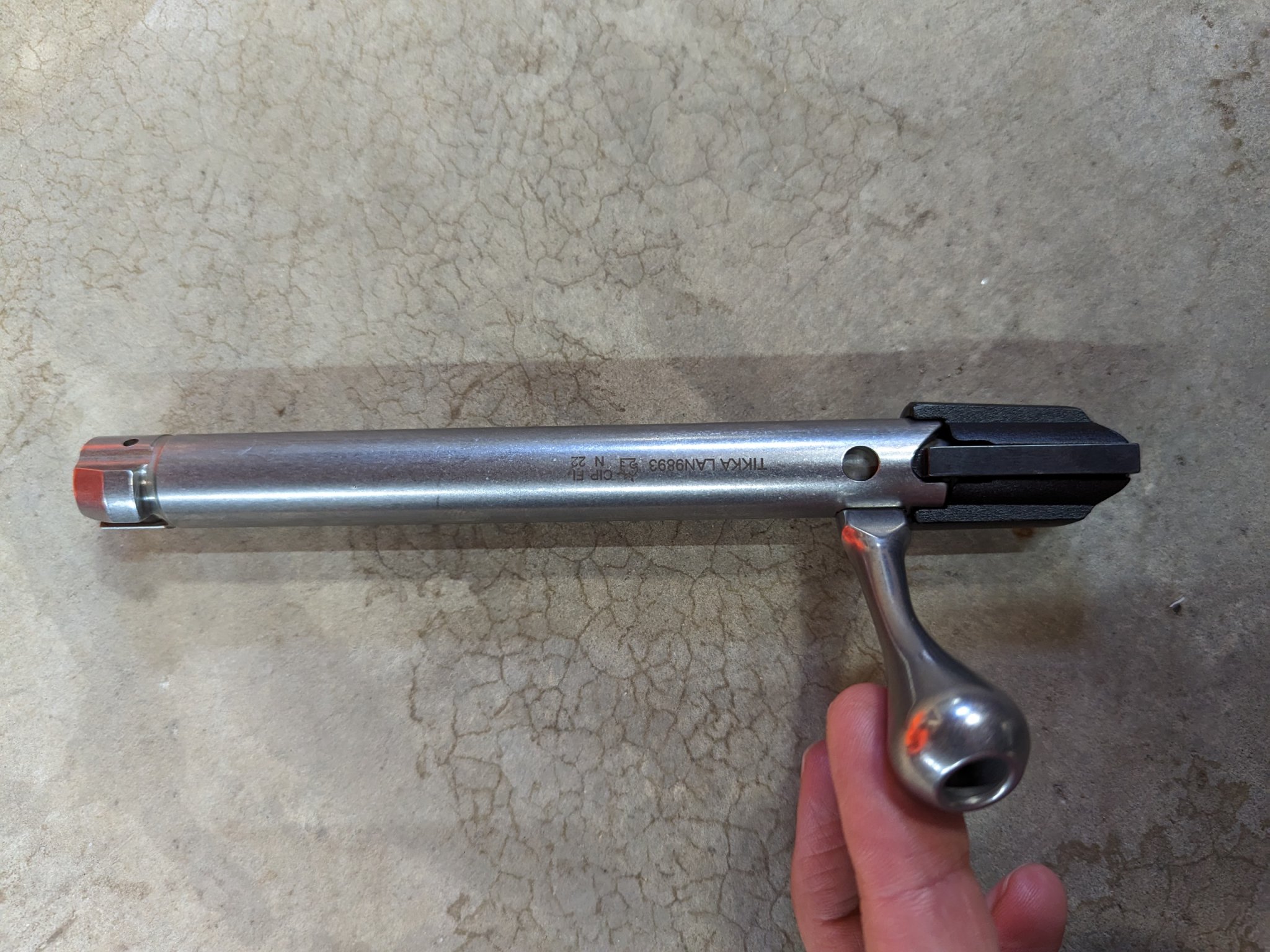

Trying to get my Tikka action ready to headspace a new prefit barrel that should be arriving soon.
Info seems to be thin online regarding the removal of the ejector. From what I could gather you just knock the roll pin out. Did read one or two posts along the way saying you had to strip the bolt and take out the firing pin assembly before doing so.
Thought I would just try driving out the pin first. Didn't seem to want to go and didn't want to fuck it up by hitting harder so I decided to strip the bolt and try again.
When I was trying to remove the rear shroud and fumbling around the firing pin dropped. I did get the shroud rotated before this happened. Now the shroud seems stuck. I can't rotate it by hand anymore and it won't slide off.
Sticking with the theme of not wanting to fuck things up, I decided to ask for help. I'm guessing I have to figure out a way to recock it? Pic of the current state of the bolt attached. Can take more.
Also, what about the ejector? Hit the pin harder or strip it down? I did this on an AnTi and had keep the ejector depressed while driving out the roll pin. Do I need to do that?

Hook the firing pin trigger interface sear on the edge of a work bench or something that you don’t mind possibly scraping material off of and push down to relief pressure and twist.
Or wrap it in a towel and twist with your hands like a man, I do it both ways (I only included that part for the lols)
It may be a one direction only pin, try it from the other way. A little soaking in wd40 or kroil etc may help.
i use a fired case to help with removing plunger ejectors. Take the rim and snap it under the extractor and then use the leverage created to hold down the plunger ejector with the case head. Now take your punch and hammer and tap out the roll pin. Do this in reverse to reinstall. I do this on the edge of a counter top and can do it alone and I bet you can figure out how, but if you have someone to help it makes it a bit easier.
@spife7980 got you taken care of with your other problem.
Thanks guys. I'll give it a go tonight. Didn't think it was overly complex but also didn't want to force it without actually knowing what I'm doing
In case someone else ends up reading this, I just clamped the bolt into my vise, just holding it by the trigger interface sear. Then you can grab the bolt handle to pull and get a little more purchase on it. Made it easy.

To remove the ejector you have to first remove the firing pin assembly. You will drive the ejector pin into the firing pin and that's why it won't come out.
To remove the firing pin assembly from the bolt you have to remove the bolt shroud and then decock the firing pin so there is less spring pressure.
There is a tab on the on FP assembly you have to compress to remove the bolt handle. Then you can remove the ejector. I recommend reinstalling the ejector before the firing pin assembly so you can confirm the ejector pin is not protruding into the firing pin channel.

Finally had time to dick with this and barrel is inbound. Posting for posterity sake.
Definitely had to strip the bolt, then remove roll pin for the ejector as suggested. My firing pin was slightly bent and had indentations from the roll pin from me whacking on it without stripping it first. I have no idea why/how some people say just hit out the roll pin with no mention of stripping or at the very least, indicating that it's not necessary. It was 100% necessary. Maybe there is a difference between T3 and T3x bolts? Mine is a T3x. Hopefully this will save someone else some heartburn.
