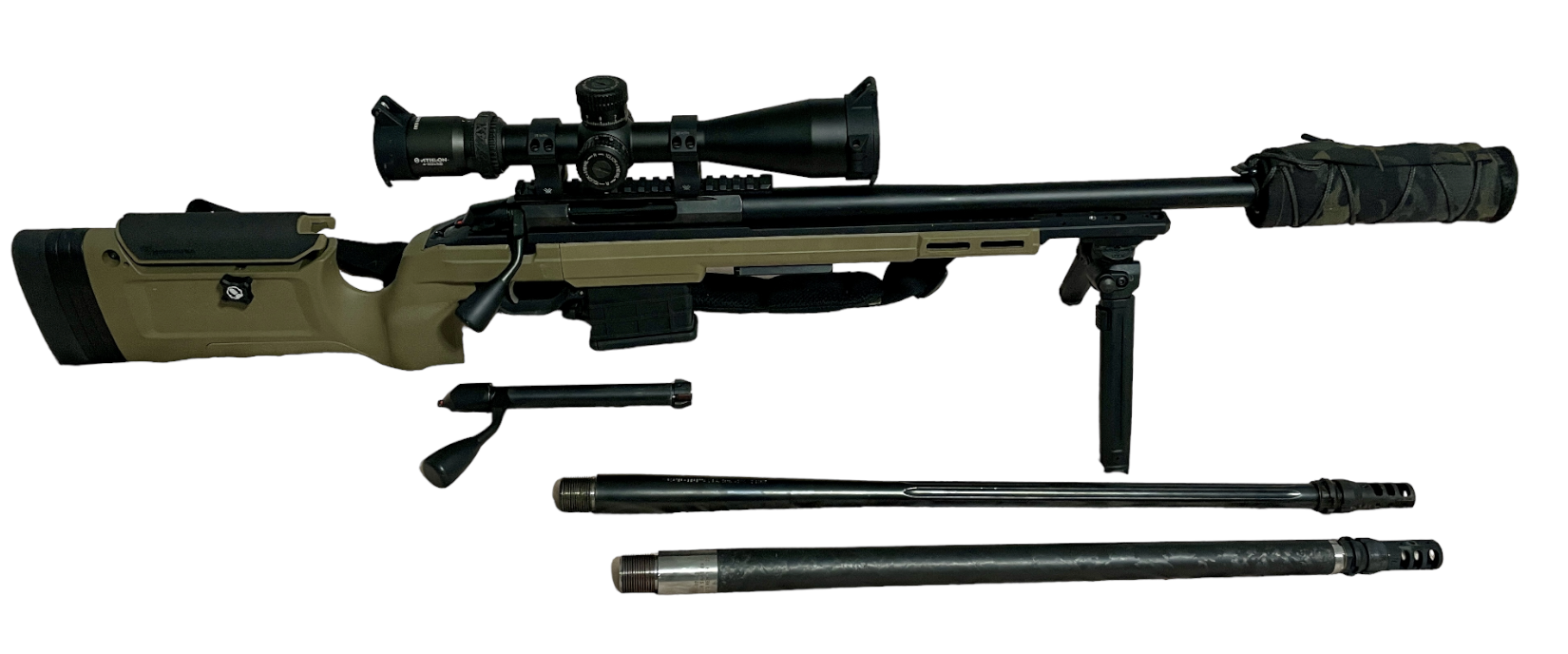

    I’m doing a version of this but found it easier to stick with the short action bravo for versatility. I figure a 300wsm or similar is all I’ll ever need for a switch barrel. For now I have a 223 and 308 bolt with a magnum that I’ll have to find in the future. Swaps are super easy with a strap wrench, so I can shoot everything in one range trip and leave it set up for whatever hunt or event I may have planned.

    I’m doing a version of this but found it easier to stick with the short action bravo for versatility. I figure a 300wsm or similar is all I’ll ever need for a switch barrel. For now I have a 223 and 308 bolt with a magnum that I’ll have to find in the future. Swaps are super easy with a strap wrench, so I can shoot everything in one range trip and leave it set up for whatever hunt or event I may have planned.View attachment 8093768
    If I wanted to run only SA in a KRG I’d just get lighter barrels for the Impact I have coming that’s going in a KRG XRAY with enclosed forend.

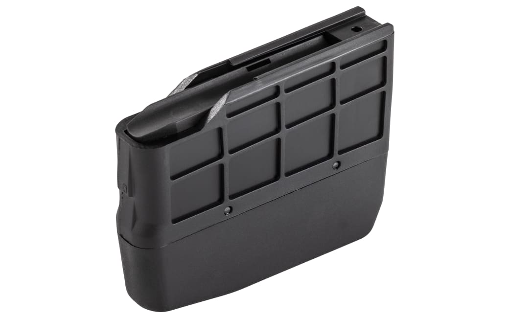

    I doubt a chassis that takes tikka plastic mags exist. A light one that does for hunting would be nice.

    So it’s a lite mag even though the hunter, laminated, varmint, super varmint, and a bunch of other models use it? No it’s the standard fucking Tikka mag system and I even clarified NON CTR… the only other mag system they make.

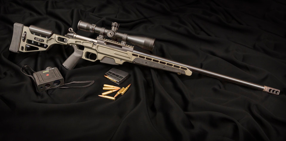

    I’m putting together a Tikka right now in 7prc, I chose a Element magnesium chassis that takes the MDT 3.560 AICS mags. You can get this magazine for magnum cartridges or .30-06 based cartridges. While not ideal for short action rounds the mdt mags are a “short” long action length a may feed fine. The HNT 26 uses the same mags.
