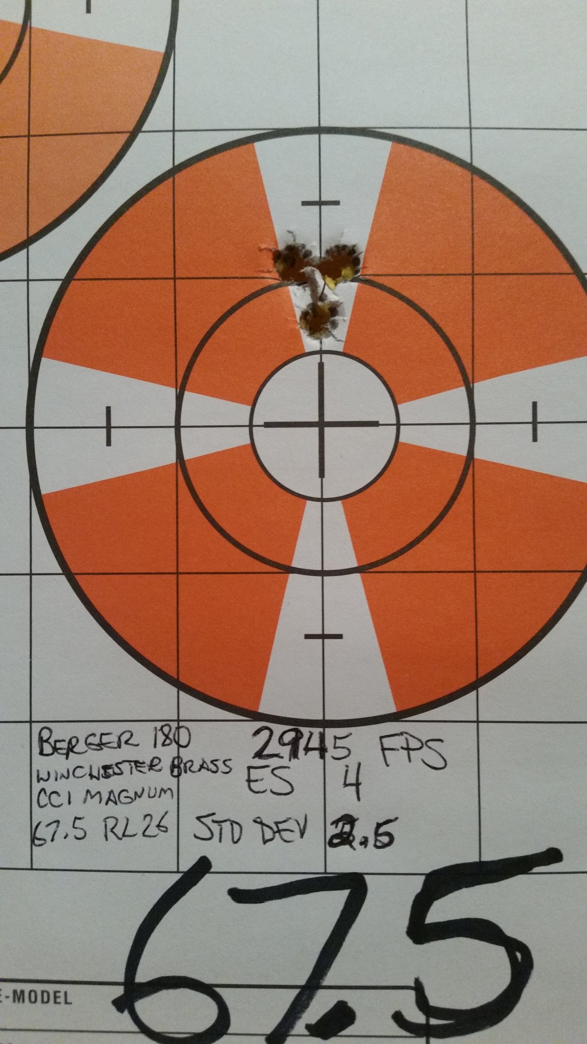

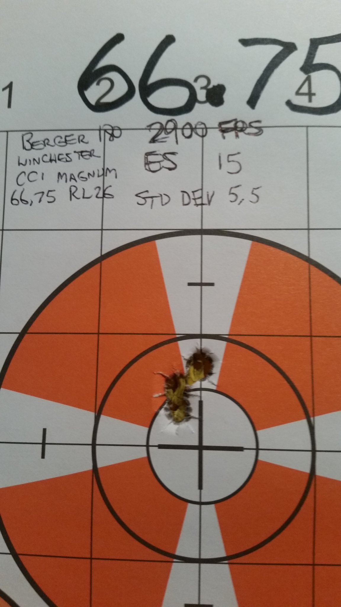

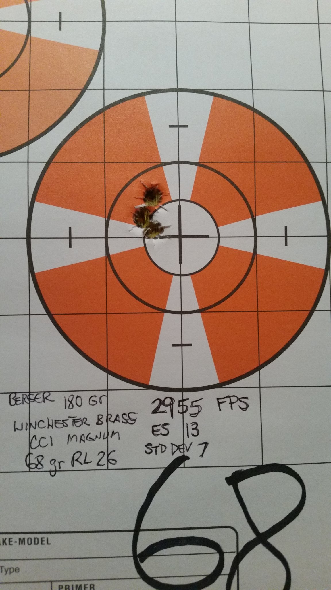

This was the first range trip doing initial load testing. It appears to be very accurate with any load so far. I need to try some seating depth variations to tighten groups. Shot at 100 yards.
