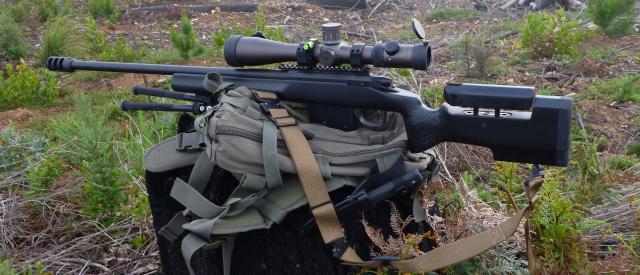

I'm looking to dabble in elr shooting(personally shot to a mile with my 6.5creed so far). I got a good deal on a Tikka long action mag bolt face rifle. I was thinking of doing a fast twist 300win mag or possibly something 7mm. I was wondering what's our there for Tikka stocks/chassis running aics 300wm long action mag. I have several KRG bravos in my short action prs guns. I like stocks more then chassis. So far I've only found a few options. Orxy and mdt are a couple I've considered. Any input would be great. Thanks

Our long action Tikka chassis systems use our 3.560" magazine so you can run up to 3.460" COAL. We set up West Desert Shooter with a Tikka LA ESS, and he shooting 7MM SAUM, and it works great! Our ESS might be something to consider.
