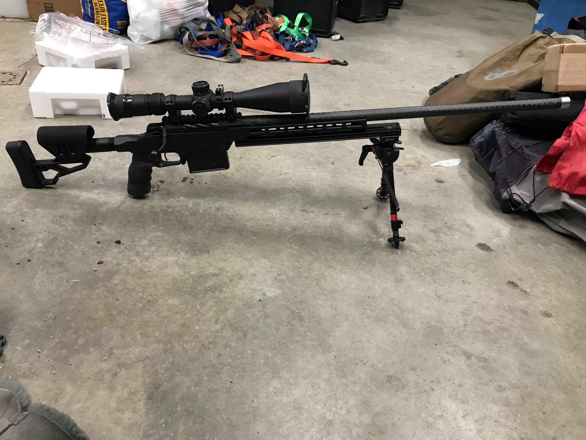

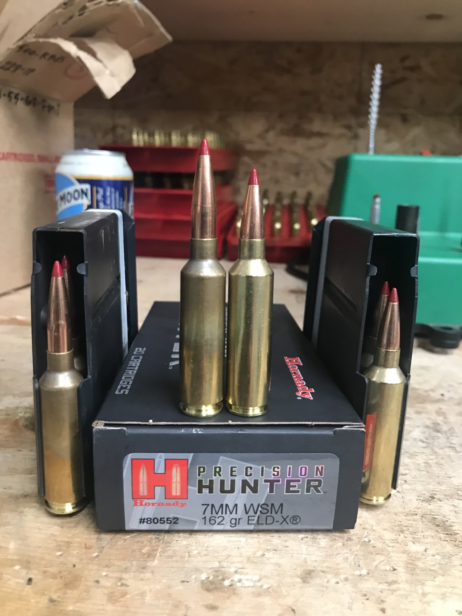

When I built my magnum rifle off of a Tikka, I went with a 300 WSM, spun the barrel off and put a carbon barrel in 7 WSM on it. Put the longer bolt stop in and put the whole thing in a MDT LSS-XL Gen 2 long action. I am nearly 3.200" COAL on my 7 WSM loads. And still have plenty of room to spare in the MDT long action mags made for the TIkka. Even the factory 2.860" COAL 162 ELDX feed just fine in the setup.
Here is my 175 ELDX loaded to nearly 3.200" COAL on the left and factory 162 ELDX on the right both in MDT 3.5" mags for their Tikka LA chassis:
There is the rifle:

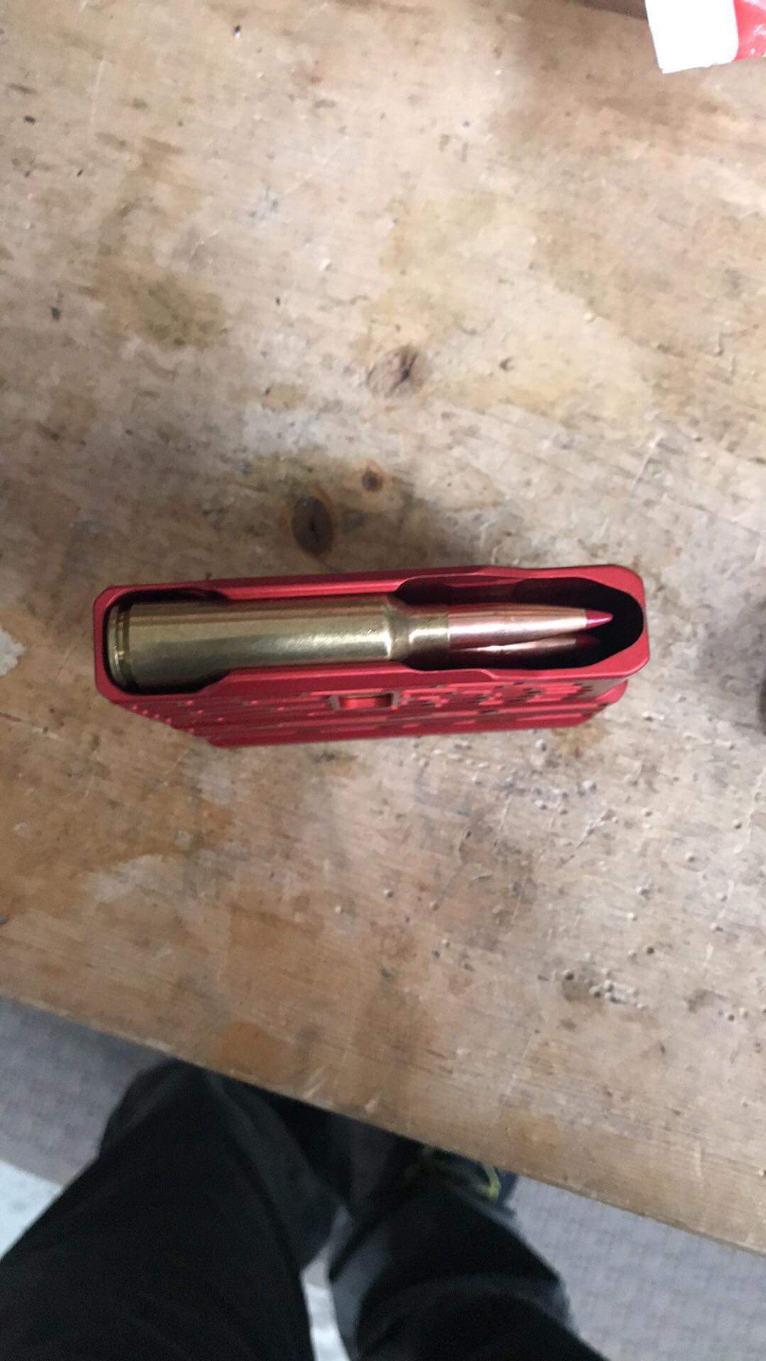

I will be building a 21" carbon barrel 300 WSM this winter and putting it in a carbon stock and using Tikka OEM long action "bottom metal" with the Mountain Tactical billet mag so I can run 212 ELDX out as long as I want for it.
Here is the Mountain Tactical with the same 7 WSM rounds (3.200 COAL roughly) in them:
For me anything LA on the Tikka platform (270, 30-06, 7 Mag and 300 WM) is a non starter just cause of mag box limits. Yeah you can get some that will get ya out to 3.5" and such but even that isnt' allow one to take full advantage of the cartridge and long skinny bullets. It may shoot great there and have seen lots of Tikka shoot great at mag box length and such...but I just like the option to go longer if possible even if it means giving up a bit of case capacity going WSM of WM.
