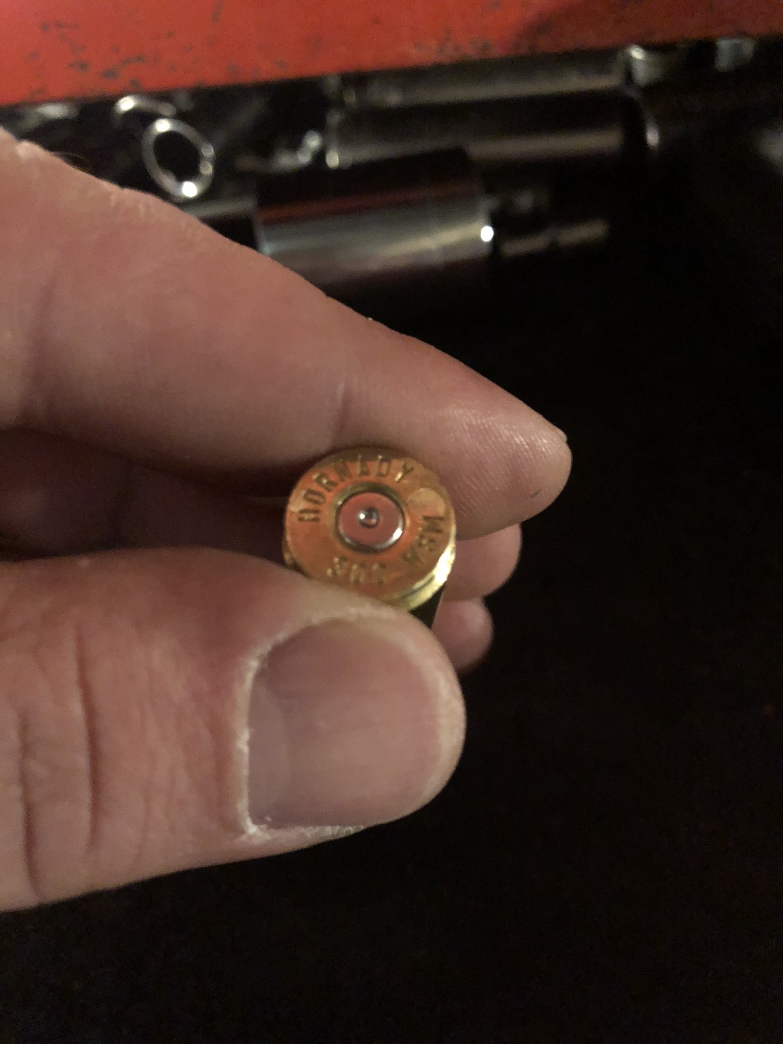

    Not a very good pic but it’s the best I could do for now
    I dont think you have a headspace issue, the heavy bolt lift seems strange as the primer in the picture looks good.

    The primer in the pic doesn’t look bad but there is definitely brass flow into the ejector and extractor on both Hornady Precision hunter 200gr eldx and federal blue box 180.

    That is the thing, I have never encountered brass flow into the ejector without flat primers.

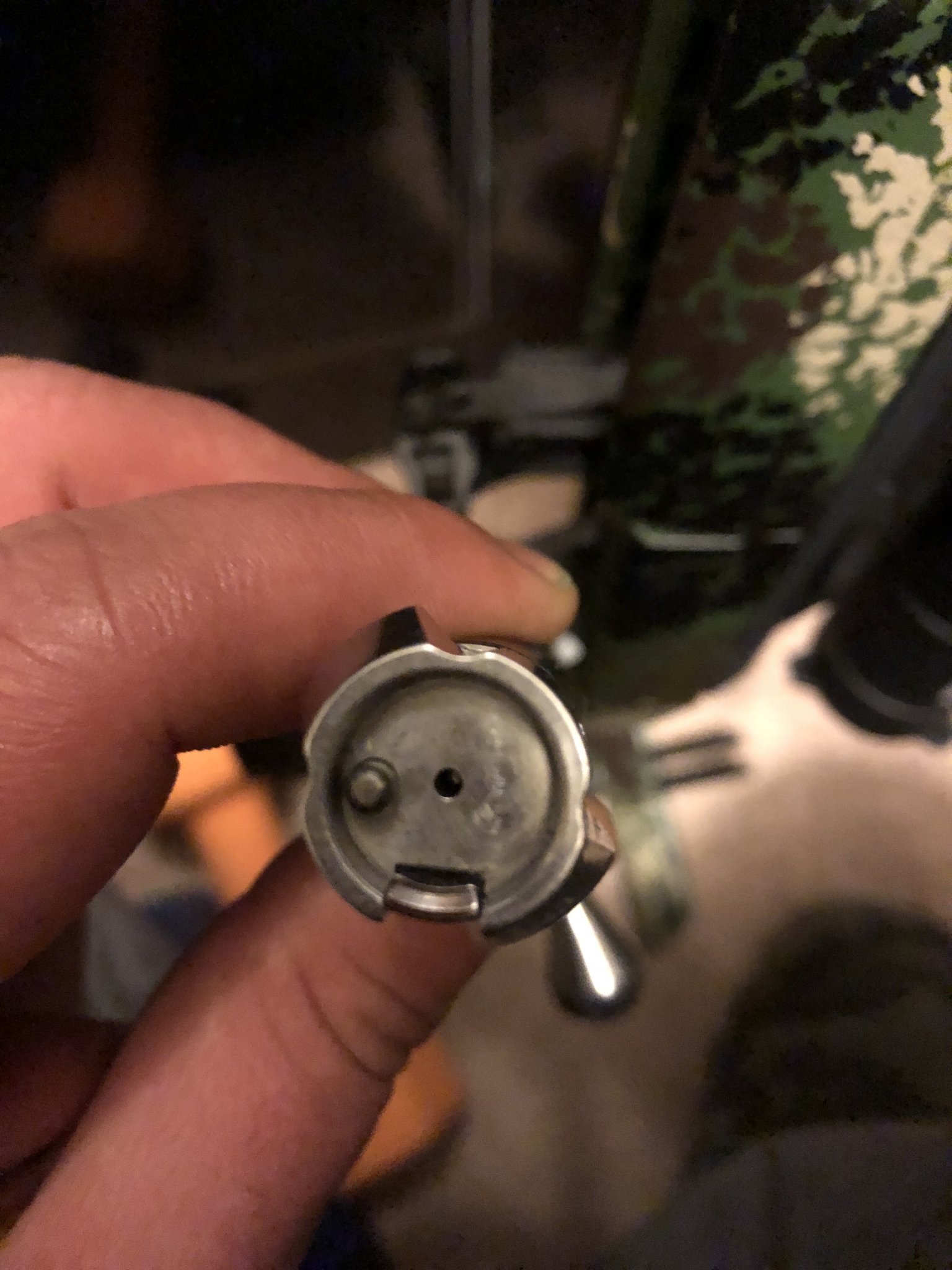

    @IronOperator87 post a good clear pick of the bolt face.
    Agreed. I know this is different brass and cartridge but I’ve seen cratered primers when I loaded some hot 308 with almost no brass flow or hard bolt lift(tikka also).

    .006" case length difference between virgin and fired brass is not unusual. It only stretches that much once, after that you're only bumping back .001-.002". When firing virgin brass the longer headspace can cause false high pressure signs in the form of ejector swipe marks. If the primer hasn't flattened, it's likely a false pressure sign. The swipe mark is caused by the case slamming back into the bolt face.
