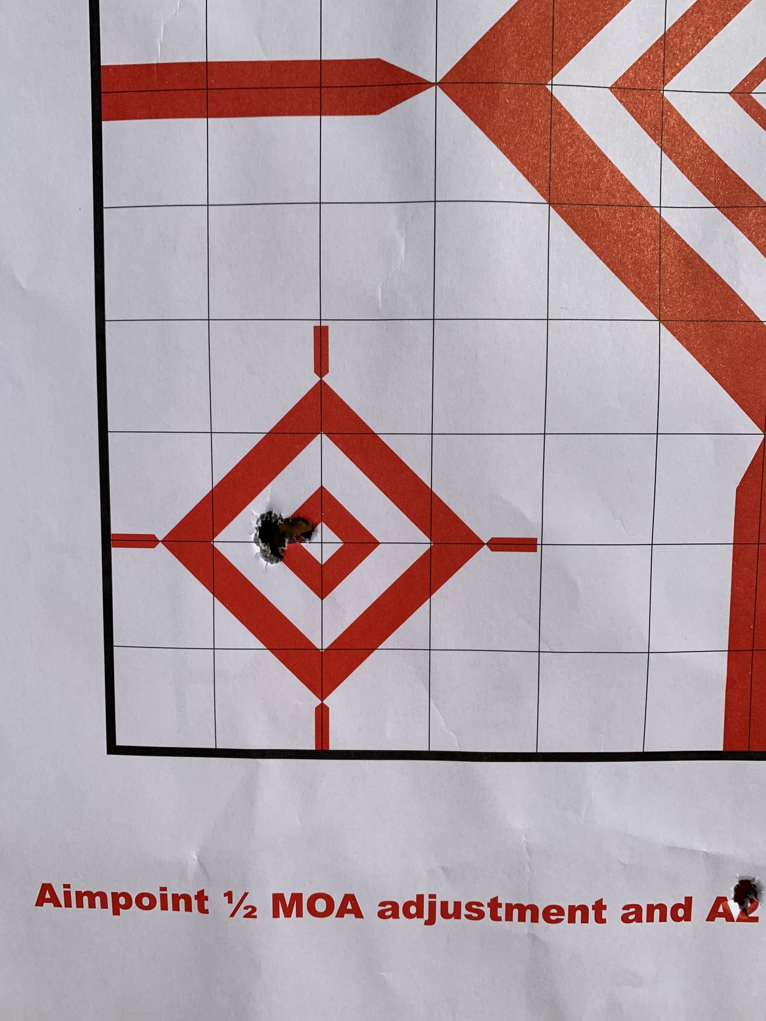

We used a barrel nut prefit from solid accuracy. 2 week turnaround. 1st Group out of the gun.
This is what we need more of!
