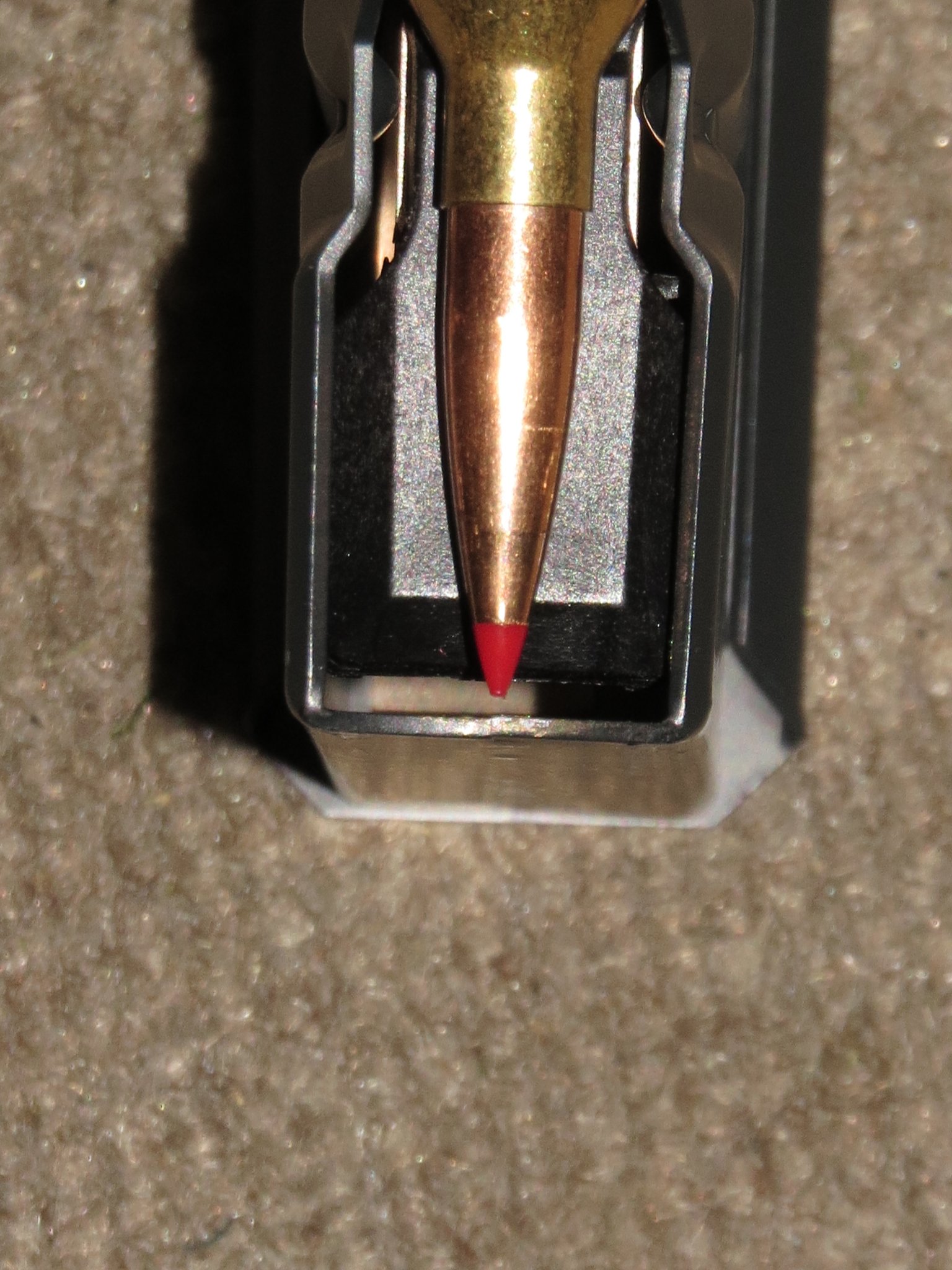

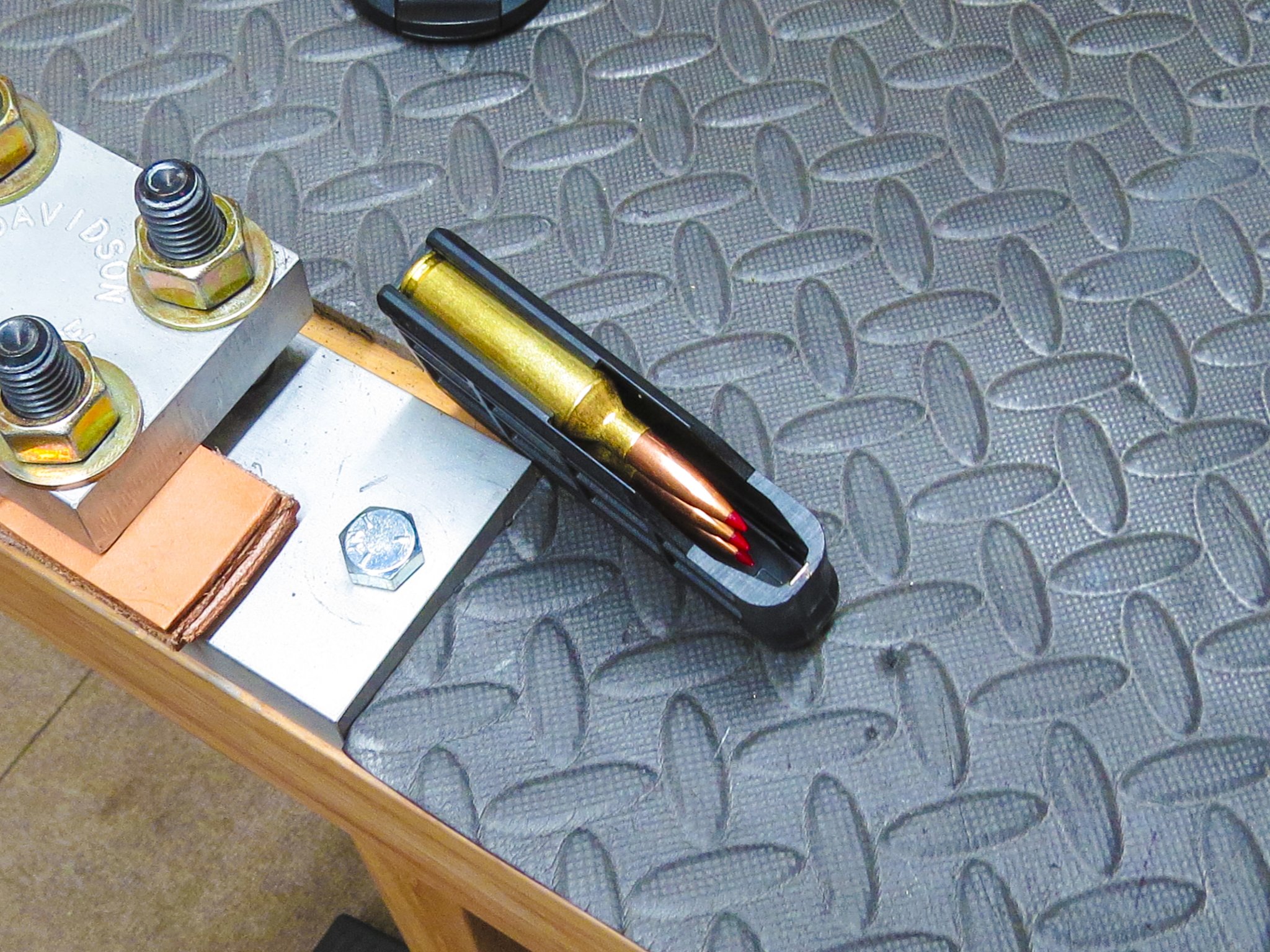

MDT sells a long action chassis for Tikka and there might be some others.
They use a AICS 3.56 magazine if you want to load longer rounds.
You can also use the short action binderless mags in a short action chassis that will get you between 2.96 to 2.97 that will work with factory PRC ammo but it is a close fit.
Most people are already using what you have for 6.5 PRC....
They work fine in a factory 300/7 magnum long action and bottom metal and magazine.
If you decided to go with a more traditional stock you can get it inlet for the factory spec'd dbm in either factory or aftermarket like Mountain tactical, Atlasworx, RedSnake and I'm sure a few others...
Pictures are MDT without the binder plate and the factory plastic mag just to give you an idea.

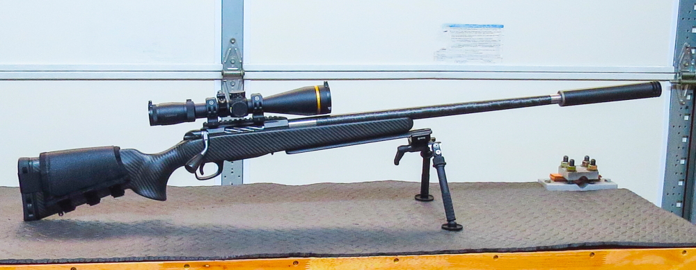

I built my hunting rifle from a 300wm donor using Carbon6 shouldered prefit barrel and Atlasworx dbm in a South Fort Labs stock
