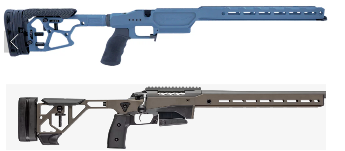

Tikka vs Envy Pro
I did some calculations, looks like the Ace chassis is about 3.5lb, the Envy Pro is 4lb.
The butt looks a bit lighter weight in the Ace, and the forend a little thicker, the plastic mag well might save a bit of weight too.
Maybe the balance isn’t horrible, with a lighter weight scope, a heavy bipod, and a suppressor it might balance ok.
