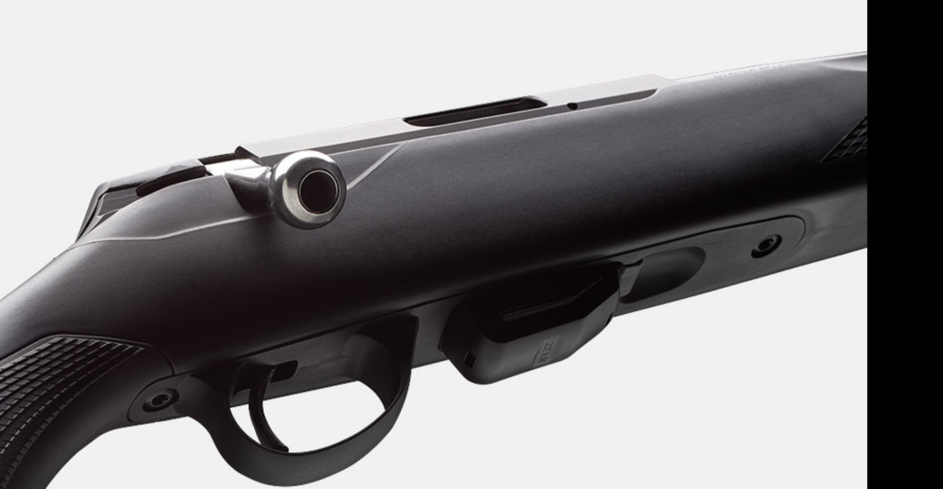

Will be keen to get my hands on a T1x to pull it apart and see. Making the magwell attached to the action would make life easier though. View attachment 6889804
Found where I heard the magwell was attached to the receiver. Tikka's rep covered it in a SHOT show webcast.
"The magazine well actually is already attached into the receiver... Not attached to the trigger group like the t3/t3x. This even makes it more easable(?) to make these additions/modifications for the t1x..."

awesome, thanks for posting that - had not seen it. Looks like they made the smart decision to have the mag well attached to the receiver - just like CZ.
So this means it will work in the KRG Bravo right?
The inlet is a normal Tikka T3/T3x inlet, so yes it will bolt into the Bravo chassis. No one owns a T1x yet, but It'll probably be like the CZ in the KRG xray chassis - the mag well hopefully lines up and it might be a little difficult to locate during use due to the mag opening being much bigger than the magazine.
