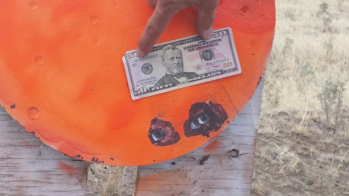

Tikka touts a 1 MOA guarantee out of the box. I am a firm believer that any manufacturer that markets their rifle with this guarantee can only be improved!! Below is a picture with 3 shots at 550 yards with the above mentioned load with BT bullets. Let me remind you that this is a hunting rifle, not a tactical match rifle and I would call that a 3" group on rough guesstimate. I mounted a limb saver recoil pad and for a scope I mounted a Leupold Mark III 4.5-14 with a CDS turret. A lot of hunters choose to SWAG shots and use hold overs for distance shots. I shoot in tactical matches and prefer to dial my dope. Now to the best part...

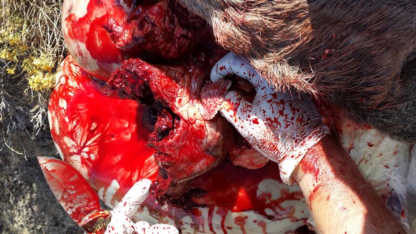

After my 2nd year of putting in for an Oregon Bighorn Sheep tag I was drawn. Naturally a million questions and doubts started going through my mind...like which bullet will be best, the BT v. Accubond. What is the maximum range I am comfortable with taking a shot? etc. I went with the BT because that is the bullet I worked most with. To keep the story short, it was the most amazing hunt I have ever been on. I ranged the sheep at 505 yds and dialed the elevation on my turret. If hold over would have been applied, this would have been a 40" hold over (8 MOA dope call). With a once in a lifetime hunt, why guess with anything? I took the shot on the sheep and below is a picture of the results. I am sorry for the graphic post but pictures paint a better image than words. The picture is what is left of the heart at 505 yards. The lower portion was actually separated by the bullet. Again, this is not posted to be intentionally crude or offend people. I wanted to show the results of what the BT bullet can do on a given size animal.

Thanks all! This ram was taken down near Lakeview, OR (I am from Oregon just working up here in WA). I dont know why the pic is upside down...tried to fix but wont. P7, very true about the comment on the graphic pic. Figured while some people may be here for tactical shooting, others may be offended by hunting animals. I dont cater to politically correct b.s. but didnt want my thread deleted if it did indeed offend anybody.

Losing an animal due to a poorly placed shot goes for any bullet, at any distance. Maybe I am mis-understanding your post but the only way I would try this bullet on a big game animal is up close, relying on energy alone to cause massive organ trauma regardless of the inability of the projectile to penetrate as compared to the accubond. The BT in this case on the "thin" skinned animal, at 505 yds, penetrated through the right shoulder, destroyed the heart, and exited the left shoulder. It has lots of penetration on something like a sheep or deer (as mentioned above) but with tougher game, at that distance, no, it would not likely have penetrated enough to go through both shoulders.
