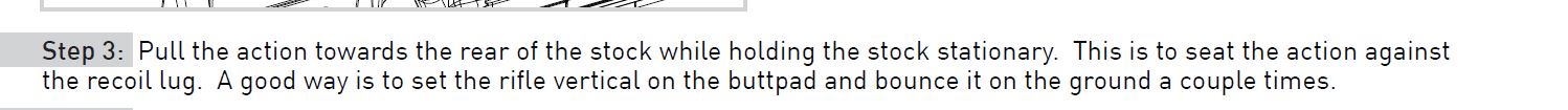

There's a pretty good explanation of this effect on KRG's chassis install instructions that apply every time you put a Tikka BA into any chassis or stock...the methodology is to drop in the BA, hand tighten screws, the grasp the action/rail surface and mag surface in a tight grip, turn rifle muzzle up, and smack the butt of the stock on the ground keeping a firm grip. The recoil lug will then fully seat and you can torque action screws.
Reactions: NicoDiko
That is to make sure the action is tight against the recoil lug, and the recoil lug is tight against the stock, in the direction of recoil. It really sounds to me like OP is having issues getting the recoil lug into the recess on the receiver, which should drop in easily - there’s tons of clearance on the OEM parts. It can be difficult to tell if it is seated all the way.
