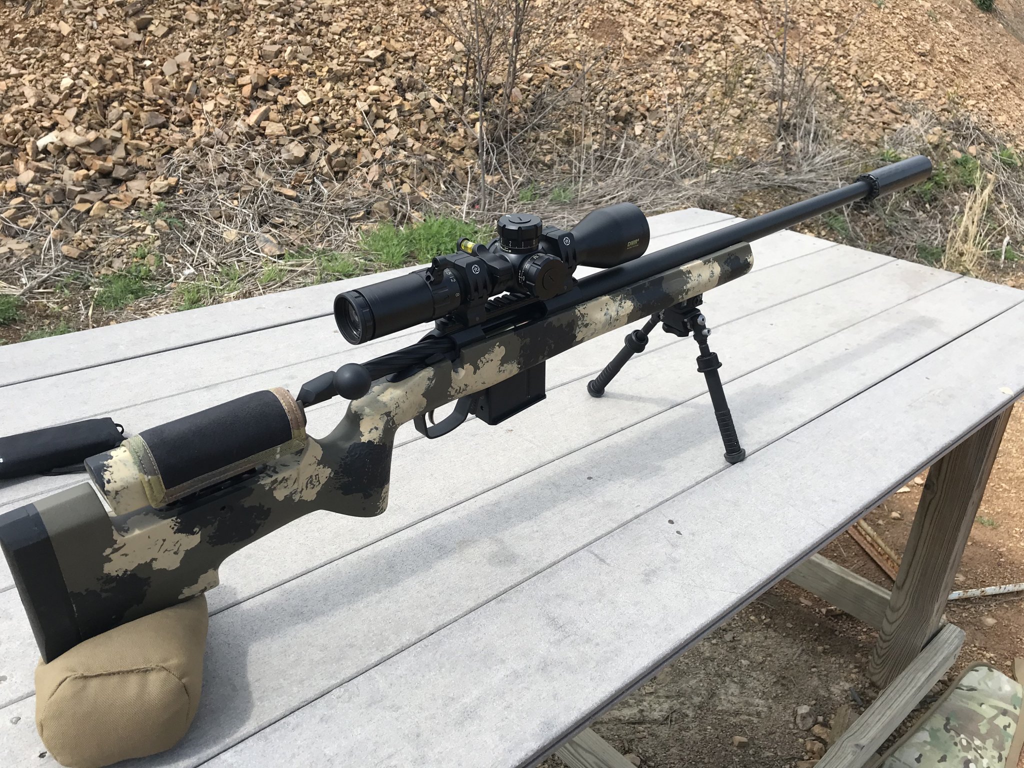

Here is a pic of mine.
T3X, factory trigger, Proof Stainless, Manners T4A.

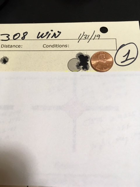

This is a Tikka .308 WIN (20 inch barrel) with nothing done to the rifle only mounted a brake and hand loading 168gr SMK on Hornady brass. Z-5 Swaro hunting scope and I don't consider myself a good shooter. Lucky day! 5 shots.
