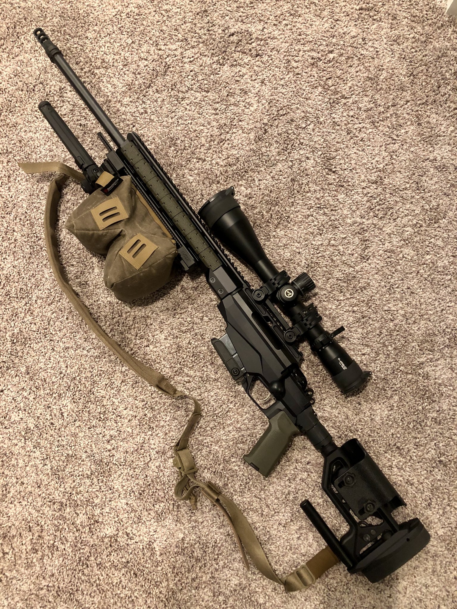

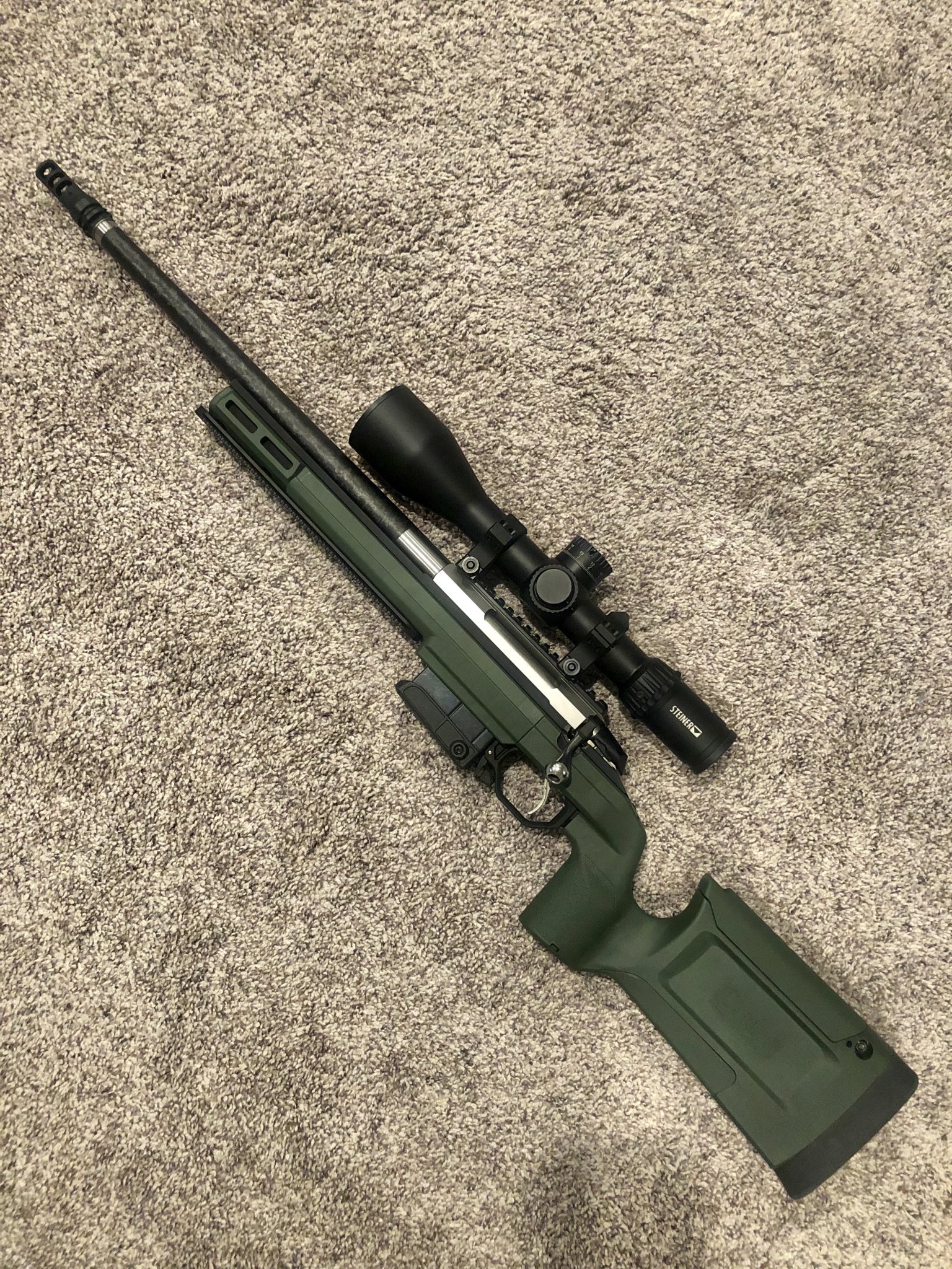

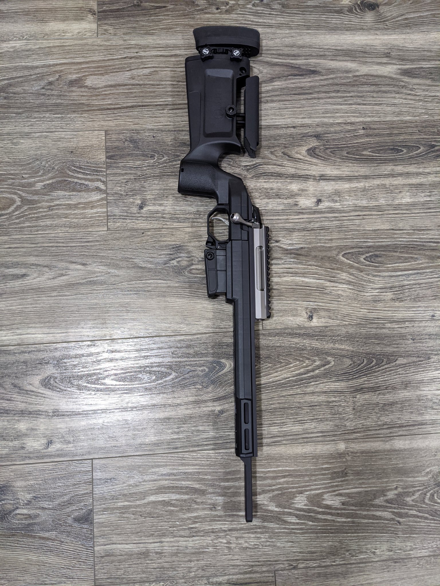

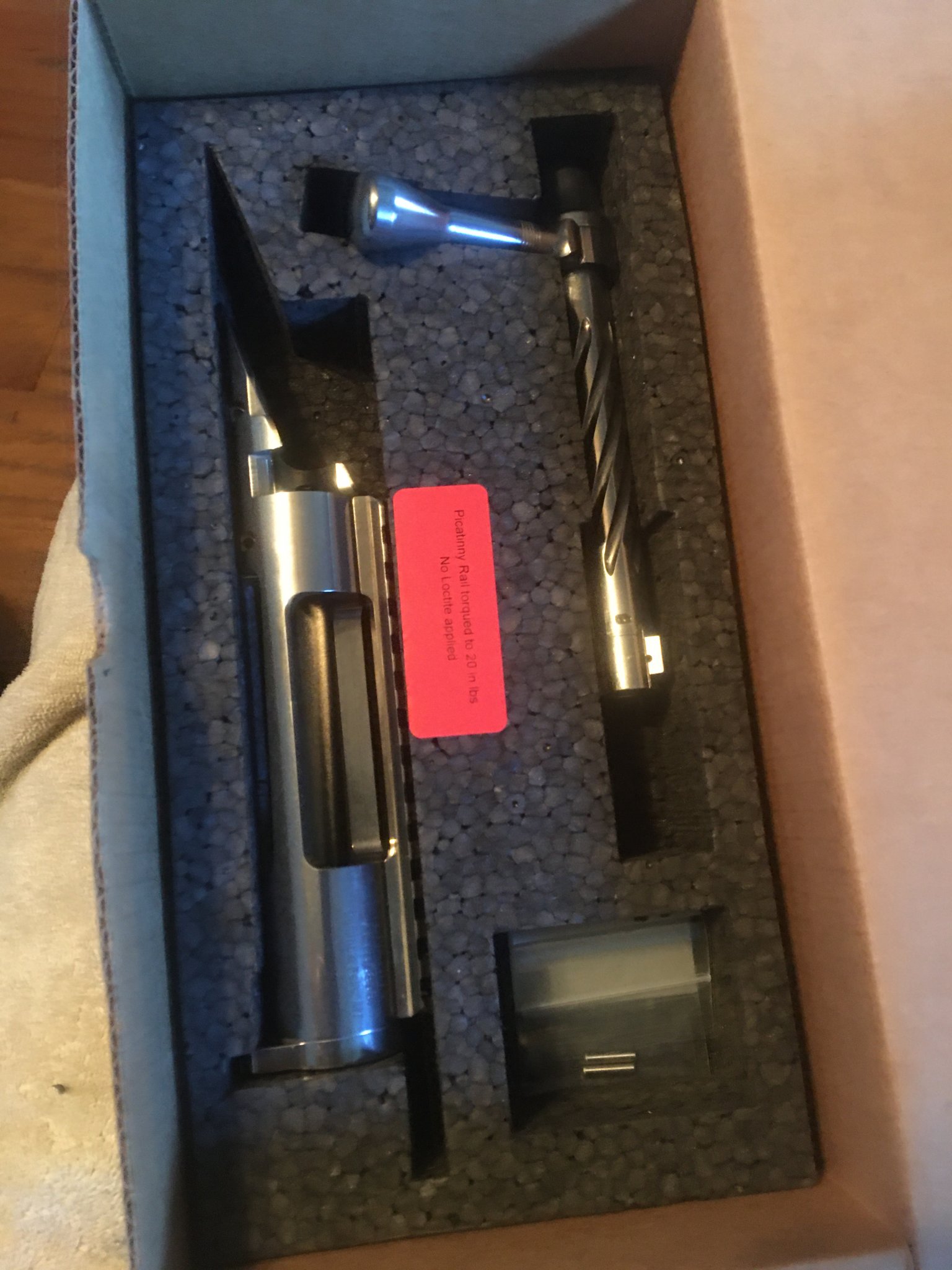

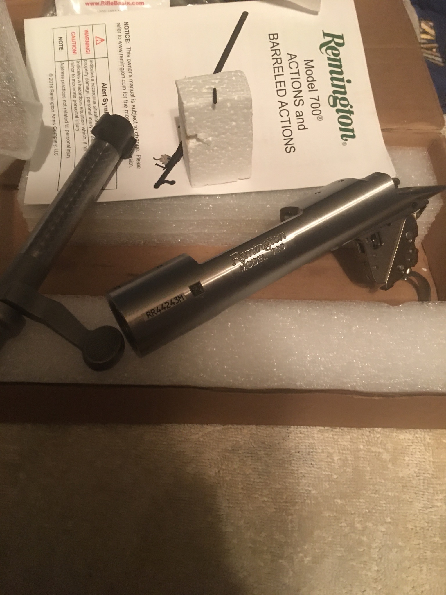

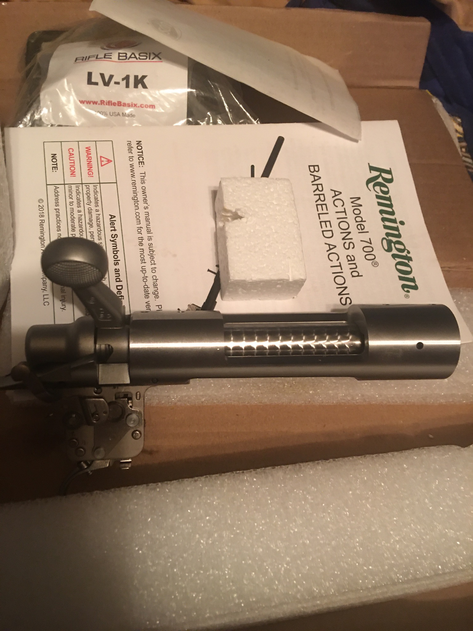

Funny you should ask because I just got another defiance tenacity and they are sweeeeet. I went with it instead of a bighorn origin only because I wanted a shiny stainless rig. The little extra cost over the origin will be saved because I won’t need to pay to have a barrel cerakoted to match my action. If I wanted another black rig I would have gotten an origin. The origin is a better deal in some ways. The tenacity has a integral recoil lug which I prefer over a pinned recoil lug. Just my personal preference because it’s one less part. The machining is awesome and it’s as smooth as glass. I got it from Altus shooting and they have the origin too. Idk if they have a Curtis or not. Any of the ones you mentioned will serve you well. Here’s a few pics of the Defiance Tenacity so you can see how they come. Good luck and happy shooting 👍
Reactions: pistolpeta

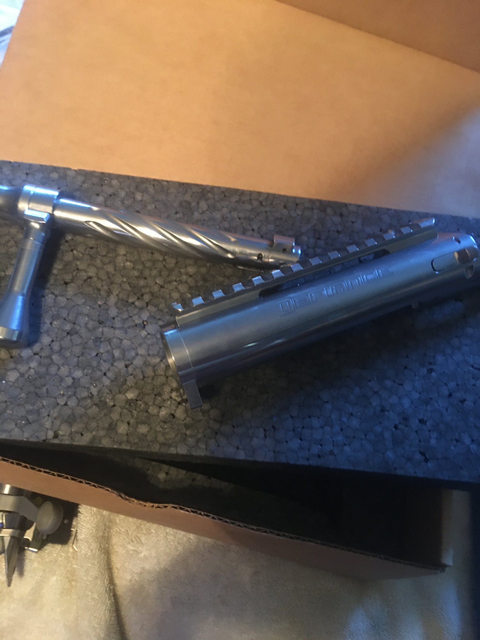

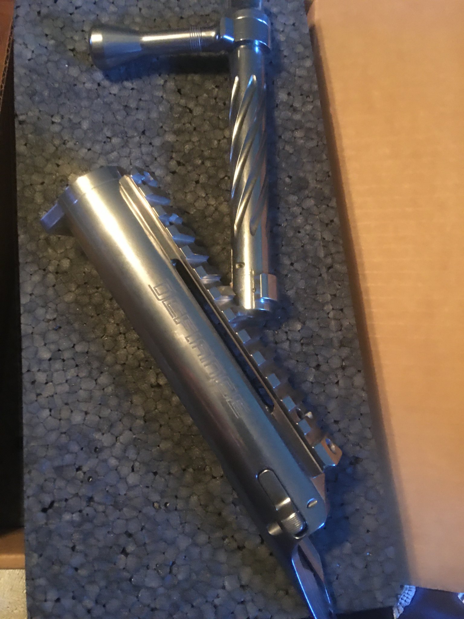

So now Im down to Bighorn (Origin) vs Defiance (Tenacity).
When they say the Origins a savage prefit and the tenacity is a Rem 700, which one has a better after market range of Barrels?
I think they're both 2 lug bolts, (is there a positive to two lug vs three?) from what I've gathered, three lugs may tend to be smoother?
Differences: Origin has a floating/changeable bolt, while the Tenacity has the integrated recoil lug.

A recoil lug can give you problems/headaches if it’s not right. It’s an additional link in the chain and IMO the weakest link. It can cause your barrel to be canted. I’m sure a origin will be fine with the original recoil lug but subsequent lugs may give you a pain in the ass. If you aren’t going to use different bolt heads then the tenacity would be my choice. They’re good and lots of good stuff for the Remington footprint.

I'll attach a pic of my latest Tikka here since that relates to the original thread topic. Still waiting on a Sterk handle, and barrel (I'm undecided on caliber at the moment)
Reactions: jcmullis2
That’s a good looking rifle you have. Tikka makes a fine rifle.
