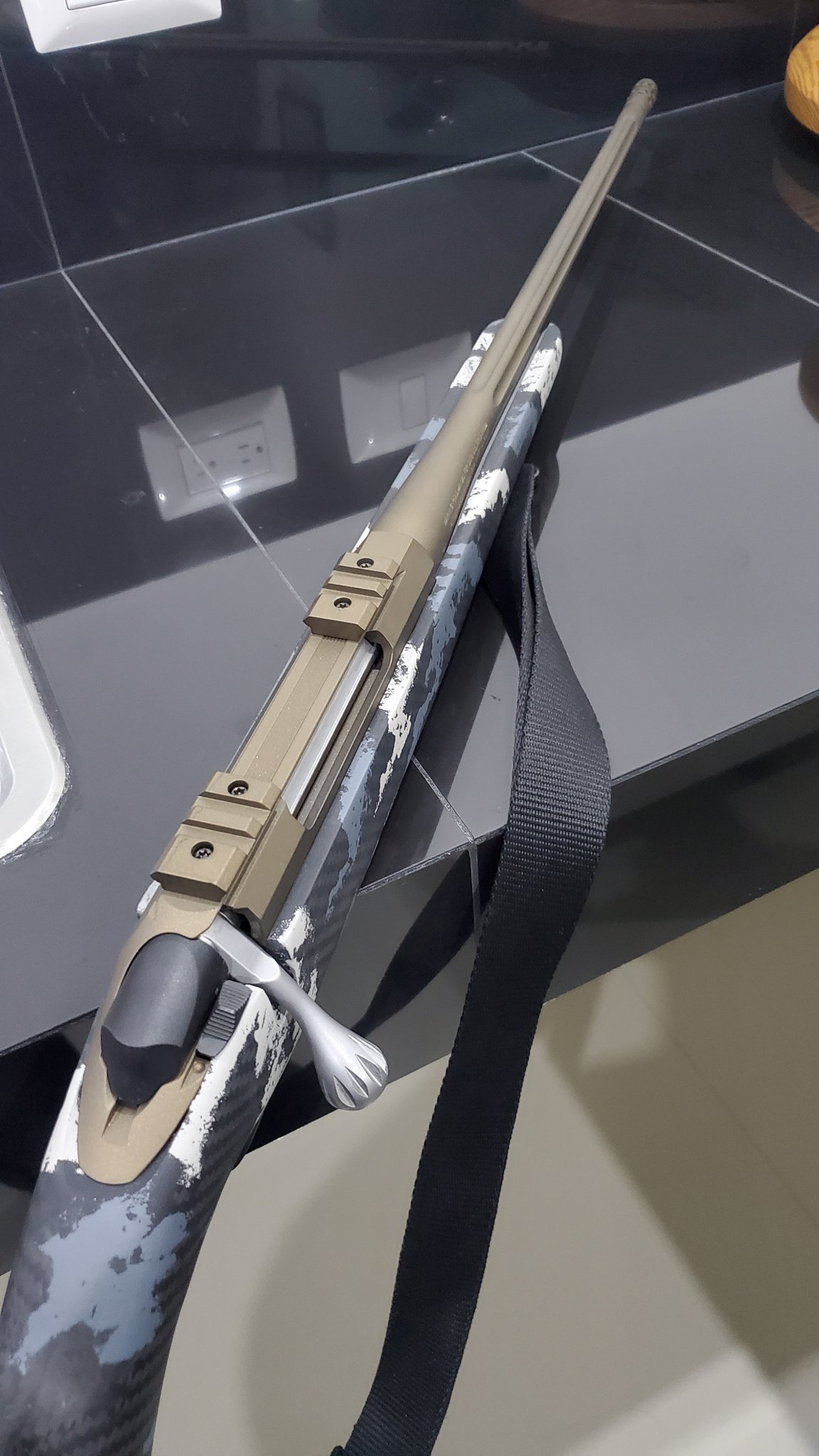

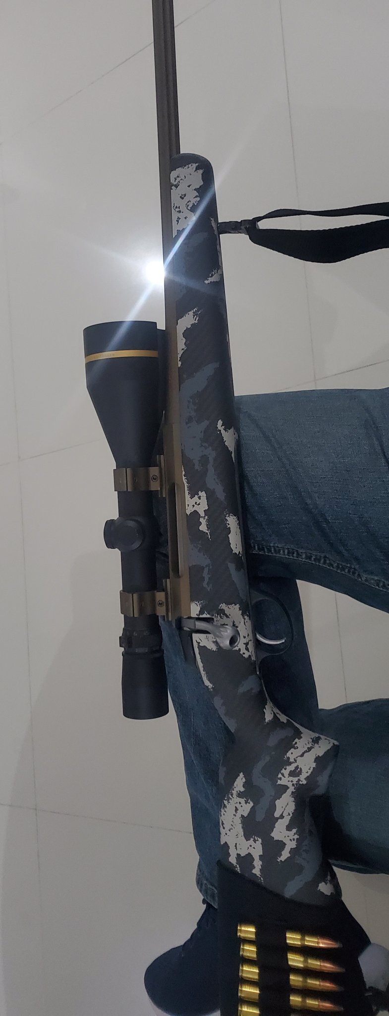

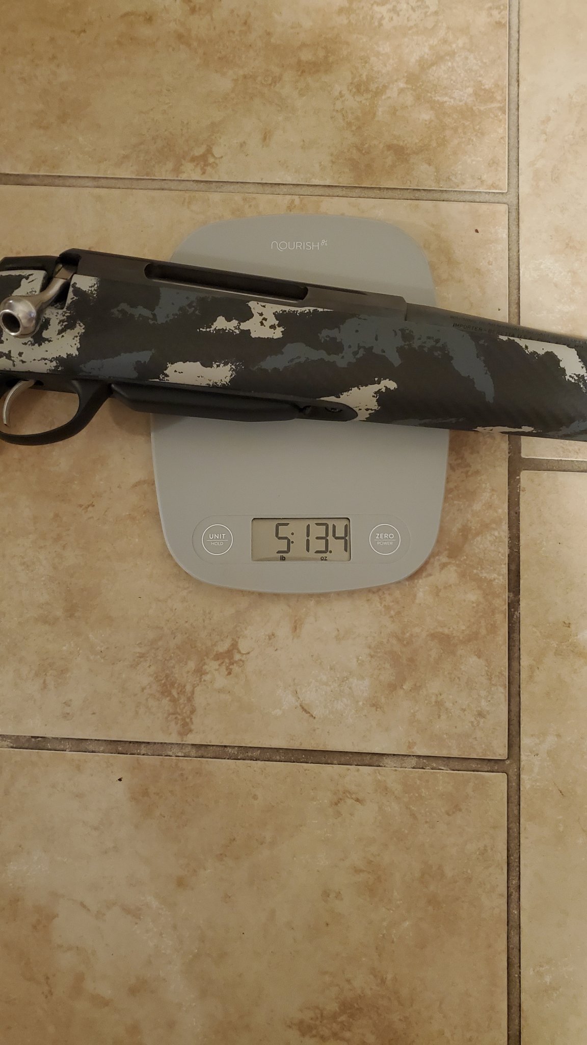

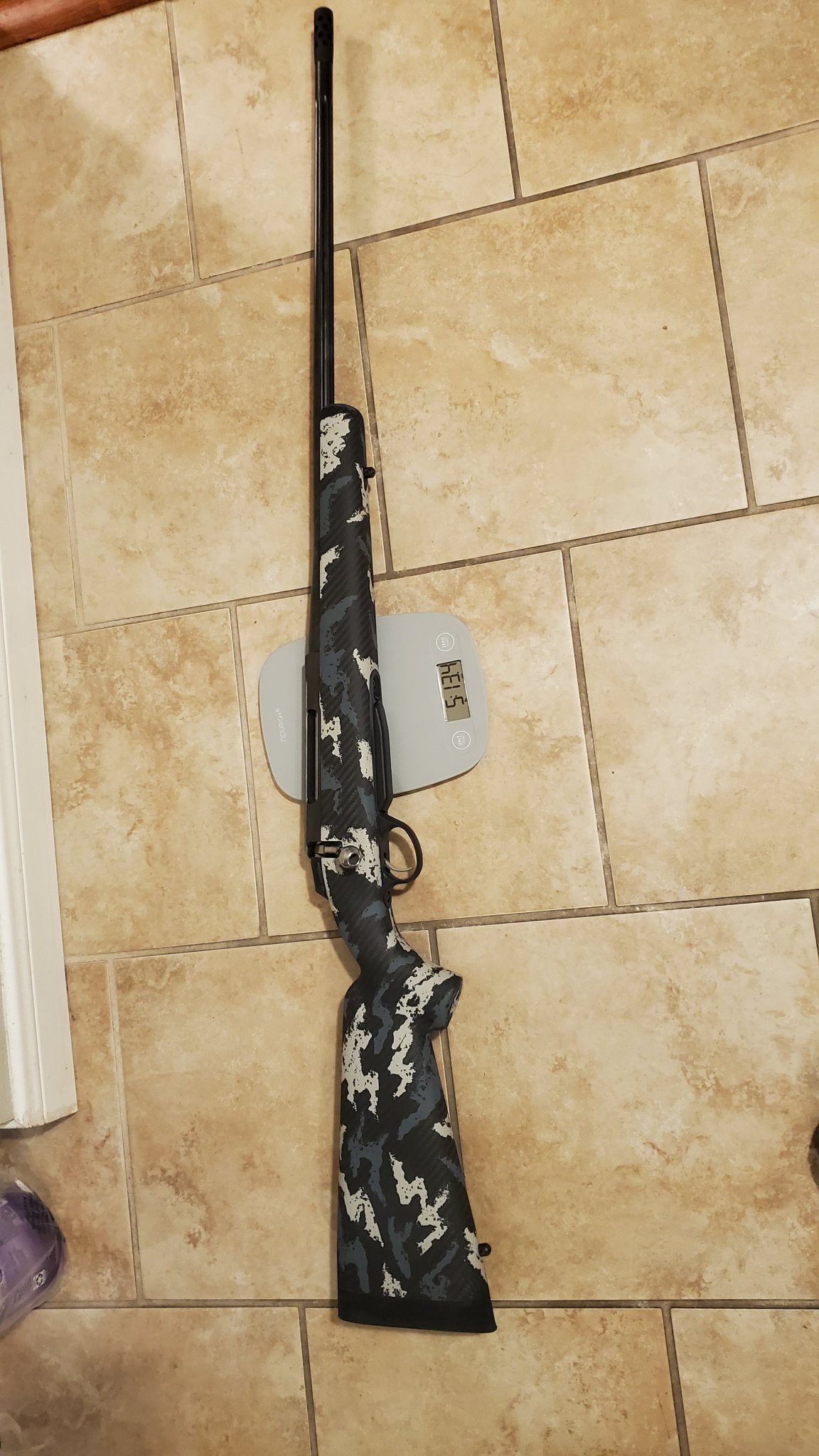

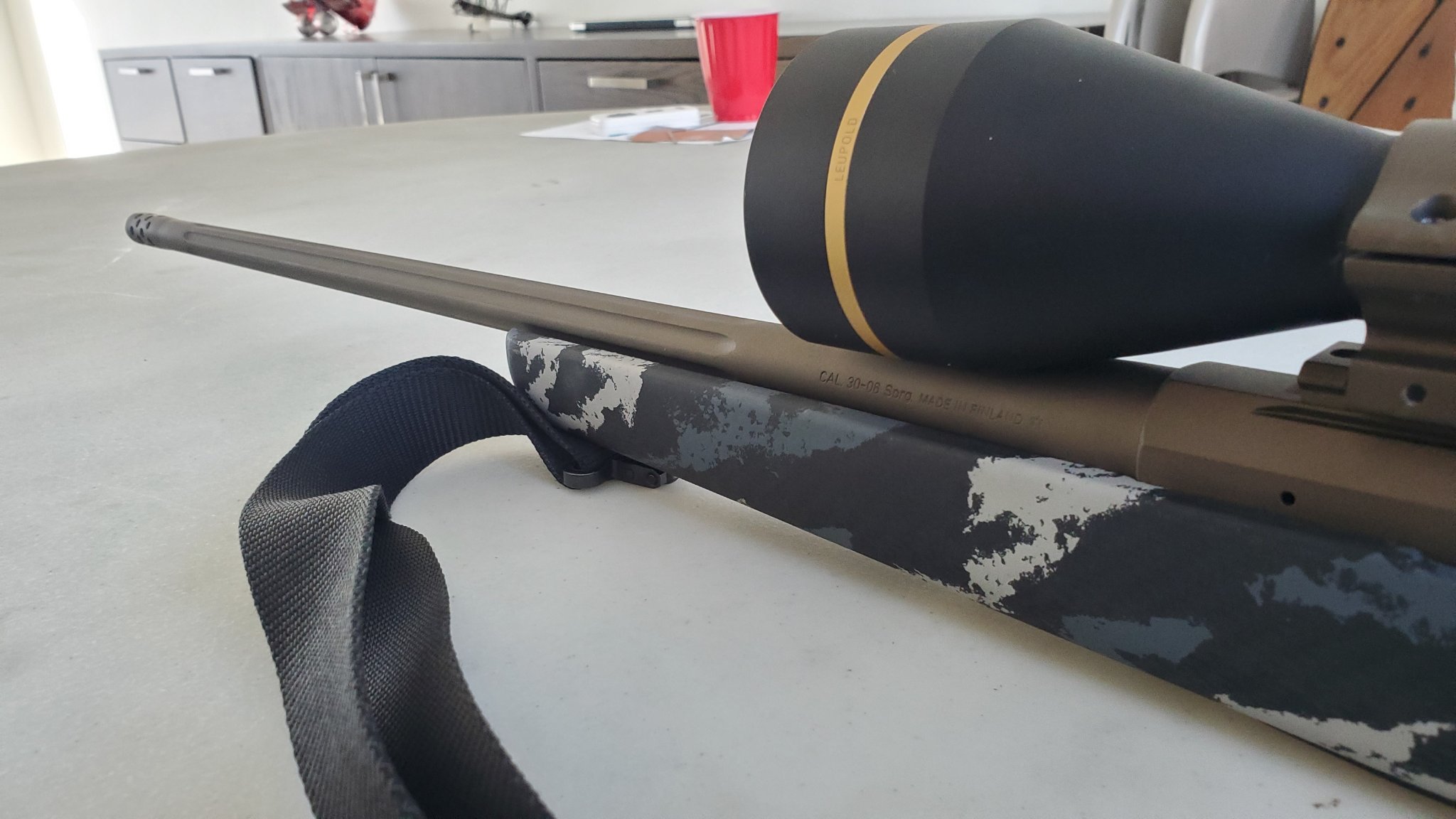

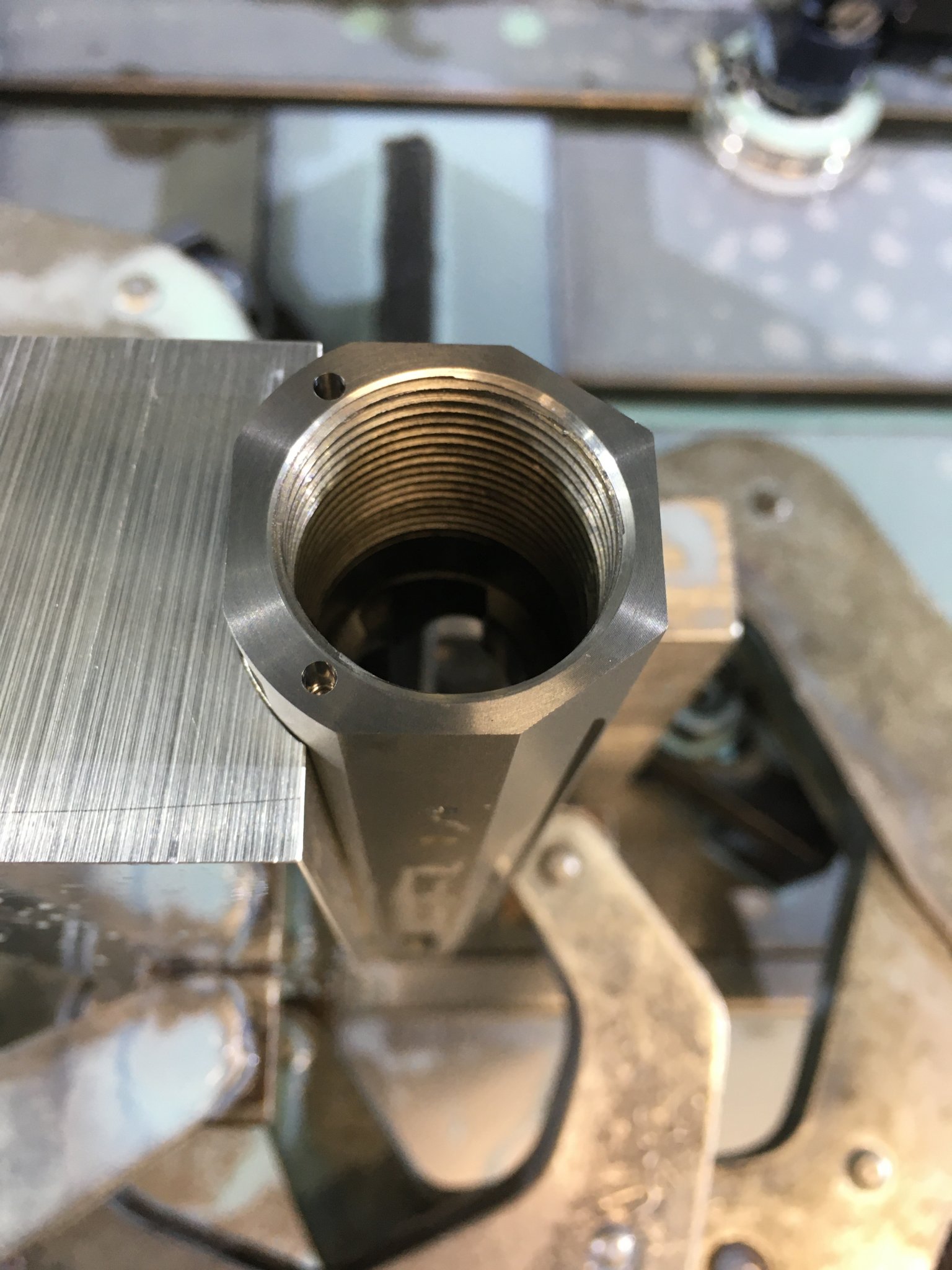

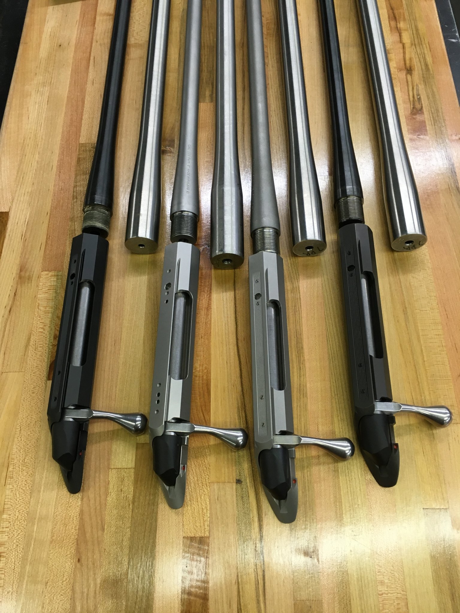

OP, Tikka is worth the build. For a factory offering, they are impressive for their QC and features (extractor, bolt release, adjustable trigger, action accepts LA and SA bolts, and some might even argue for their integrated rail) . Here are a few current build projects, some of which will run switch lugs for variously chambered barrels. GL
