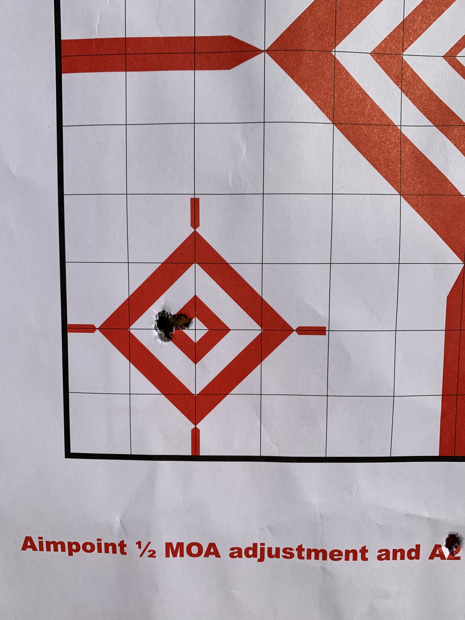

If I get it rebarreled will it shoot like this?
Blued vs SS shouldn’t yield a difference in accuracy. Some blued may be more accurate than some SS and vice versa. Cant guarantee anything with a new barrel but if you go with a quality barrel it should yield .5 moa no problem.
