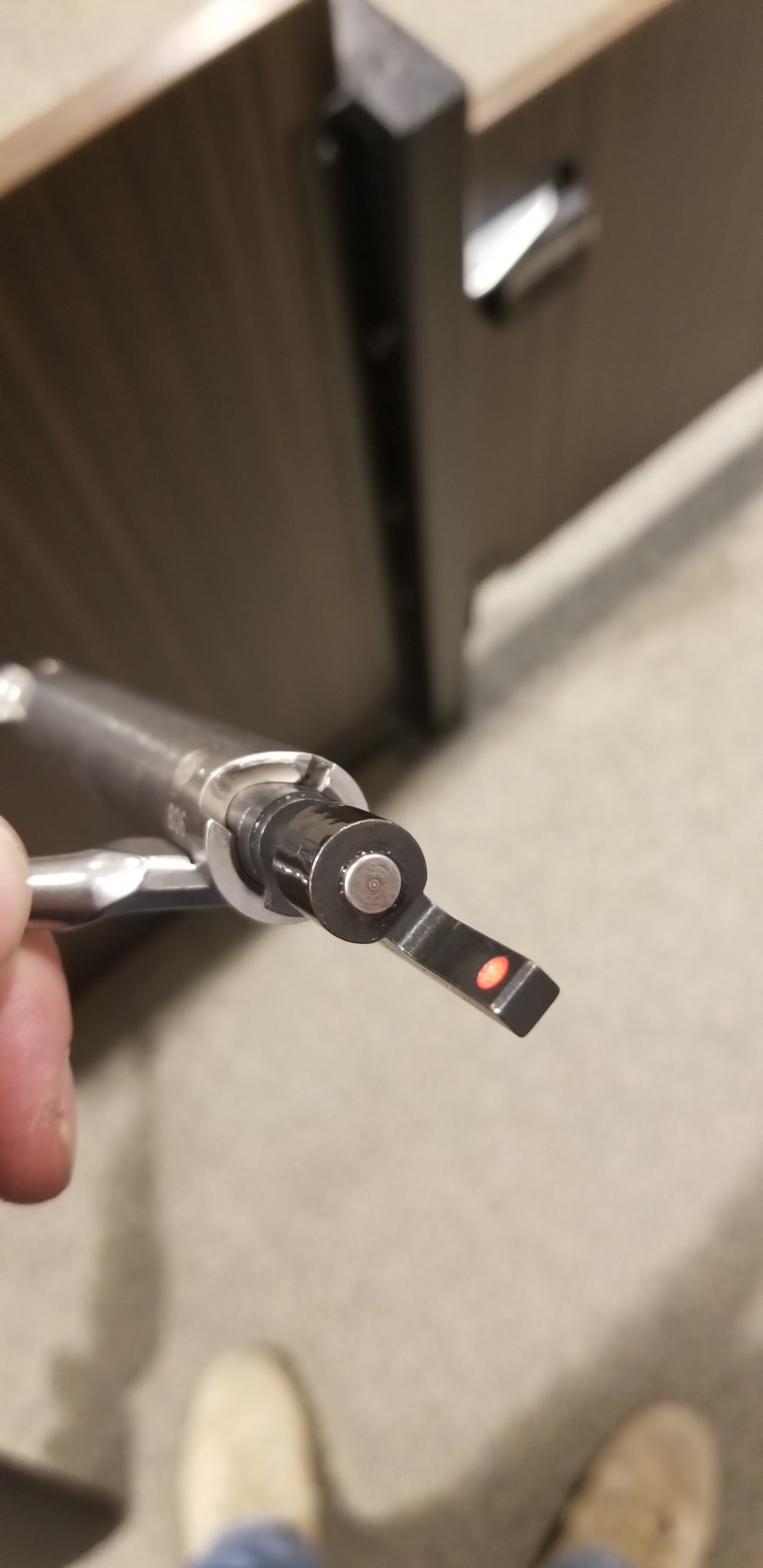

Not at all man. We have them at work and I'll check a random one really quick wait one*
Yeah no this one is normal

If you haven't already sent it in, you could just try to grease/lube the angled/curved piece of the bolt that is near your thumb in the picture. I cleaned my bolt out when I first got it and got your symptoms and realized that I had removed all the lube.
I know that it looks like yours has some lube and the metal shavings are concerning and you likely do have an actual problem, but it can't hurt to try it before dealing with the hassle of sending it off.

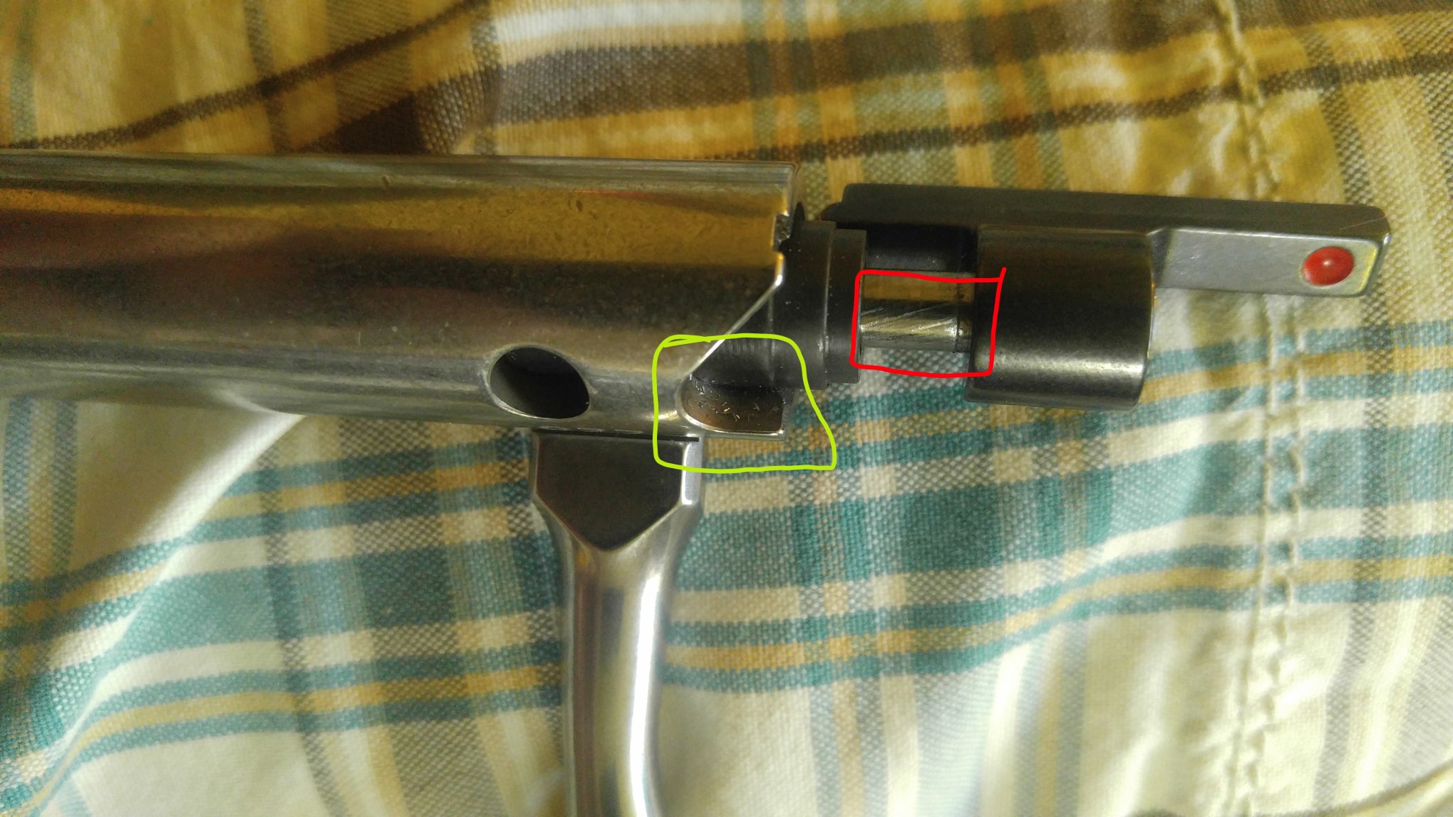

Happened to come across this thread while trying to find information on this exact problem. Thought I'd share my story..
I bought my t3 last year and it has been sitting in its box since (didn't have the money for a scope, etc.). Finally got enough spare change to start building it up. I replaced the bolt shroud and I wasn't happy with the fitment so I kept fiddling with it and the stock plastic one to compare the two. After cycling my bolt approximately 30 times I notice that my bolt got increasingly difficult to open when cocking the bolt. I took the bolt shroud off and found metal shavings under it (highlighted in yellow), along with scratches on my firing pin (highlighted in red). I cleaned up some of the metal shavings to see if there was improvement in the force required to open the bolt; and there was not. The only thing that happened was more shavings appeared.
I'm going to be starting the apparently long process of dealing with Tikka/Beretta CS. Does anyone have any contacts I could reach out to in order to make the process go any faster? I'd really hate to have to send in my whole gun now that I finally can build it!

Had an issue recently and talked with their head gunsmith on the phone. Long story short - I tried to fix something minor and ended up creating a major problem, and even the original problem was a configuration issue and not a problem with the gun itself. But he got it all taken care of at no charge, and I had my bolt back within 2 weeks of having dropped it in the mail. So it couldn't have spent more than 3-4 days at customer service. I honestly couldn't have been more impressed. Gun runs great and still just as accurate after the fix as it was before. I shot a local informal match a couple weeks ago and finished really high.
PM me if you want the guy's name. I don't want to post it on here and have everybody and their mom mailing stuff to this one gunsmith at Tikka CS.
