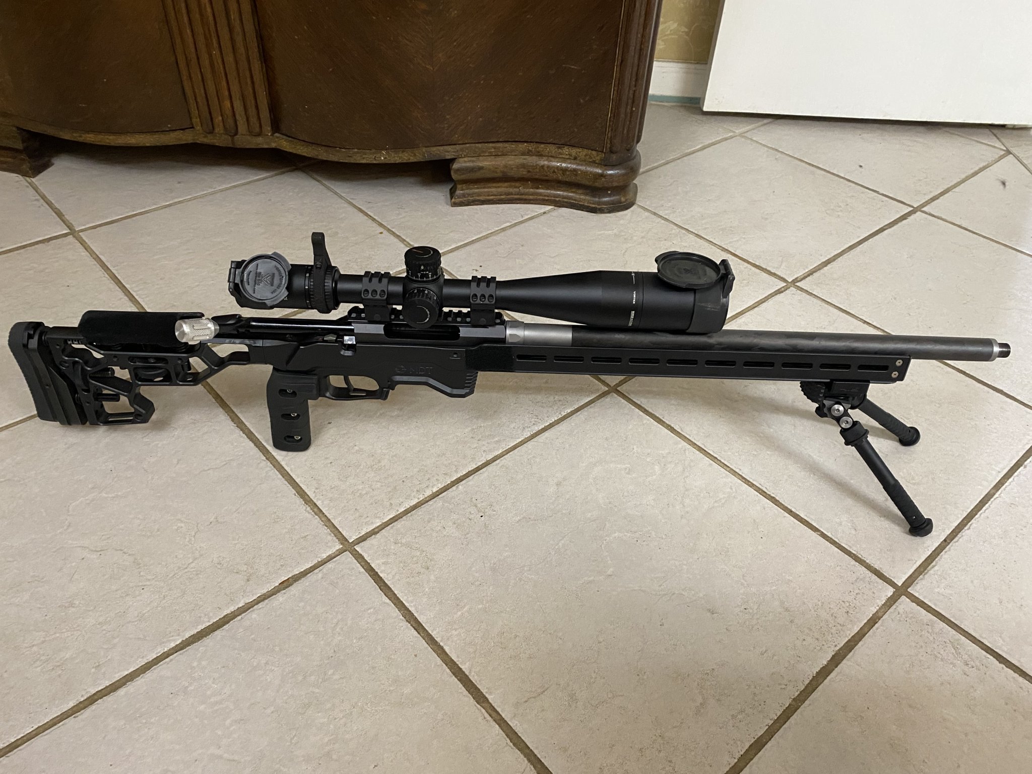

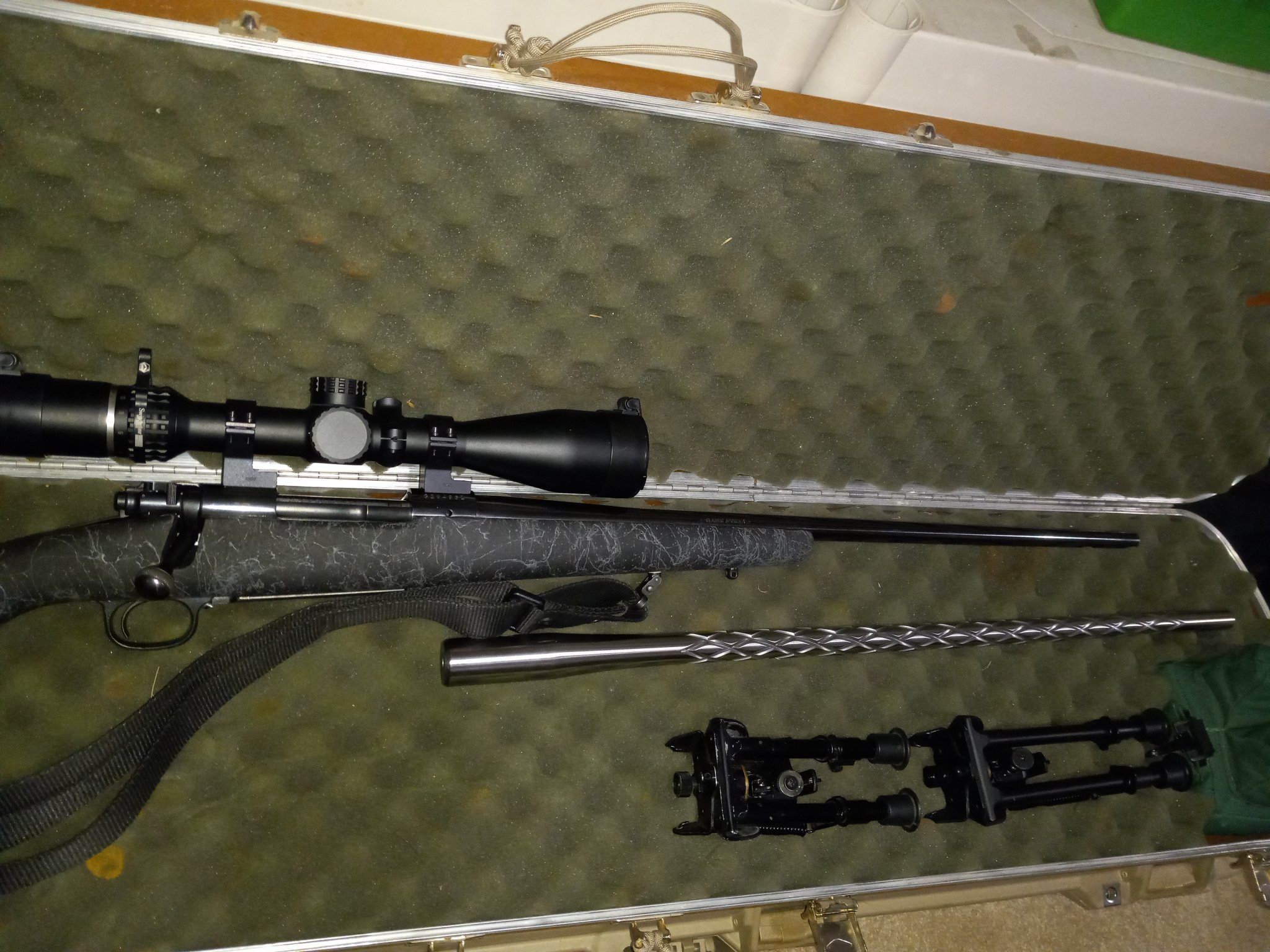

    SAC built 284Win
    Tikka long action
    Not mine unfortunately. First page of the Tikka build thread. I've been in love with this rifle for years!

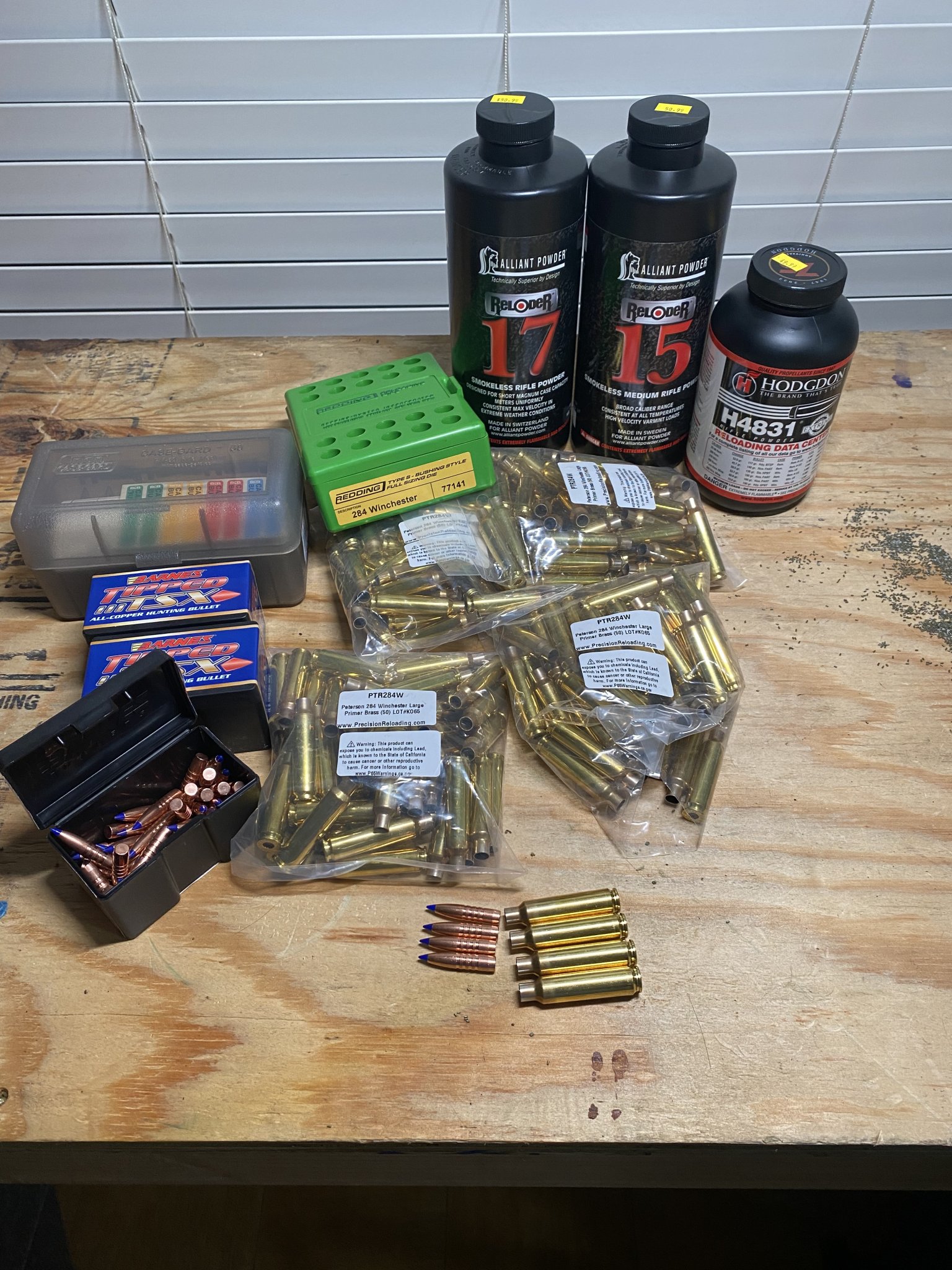

    I bought Peterson Brass, Barnes 150g TTSX bullets, Redding Type S Full Length Sizing Die, Bushings.
    I scored a pound of RL 17 and a pound of H 4381 at the same LGS that I scored an 8 pound jug of Accurate 2520 at earlier in the week.
    There are no Forster micrometer seating dies to be found right now, so I'll be searching for that until the the barrel gets here... In 13 to 16 weeks...

    Reloading stuff is showing up.
    The bullets, brass and sizing die are here.
    I should have the long bolt stop, internal action wrench, barrel nut & headspace gauge next week.
    Then, the barrel and the Forster seating die…

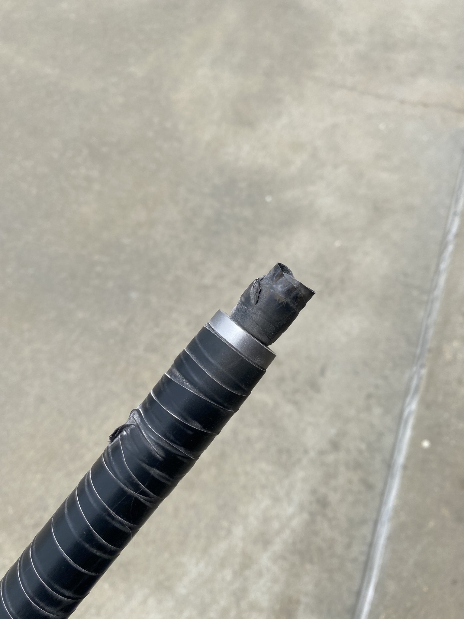

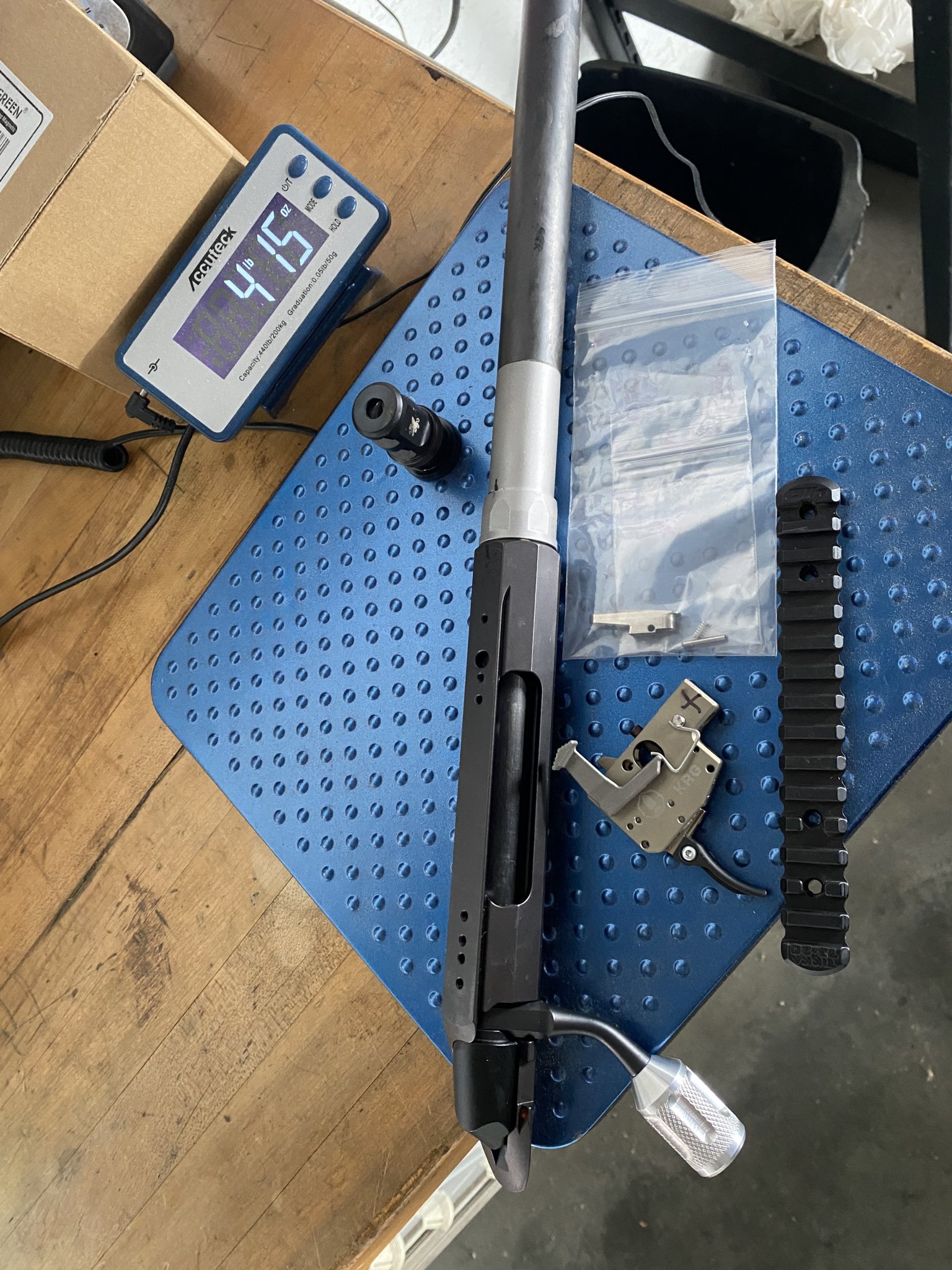

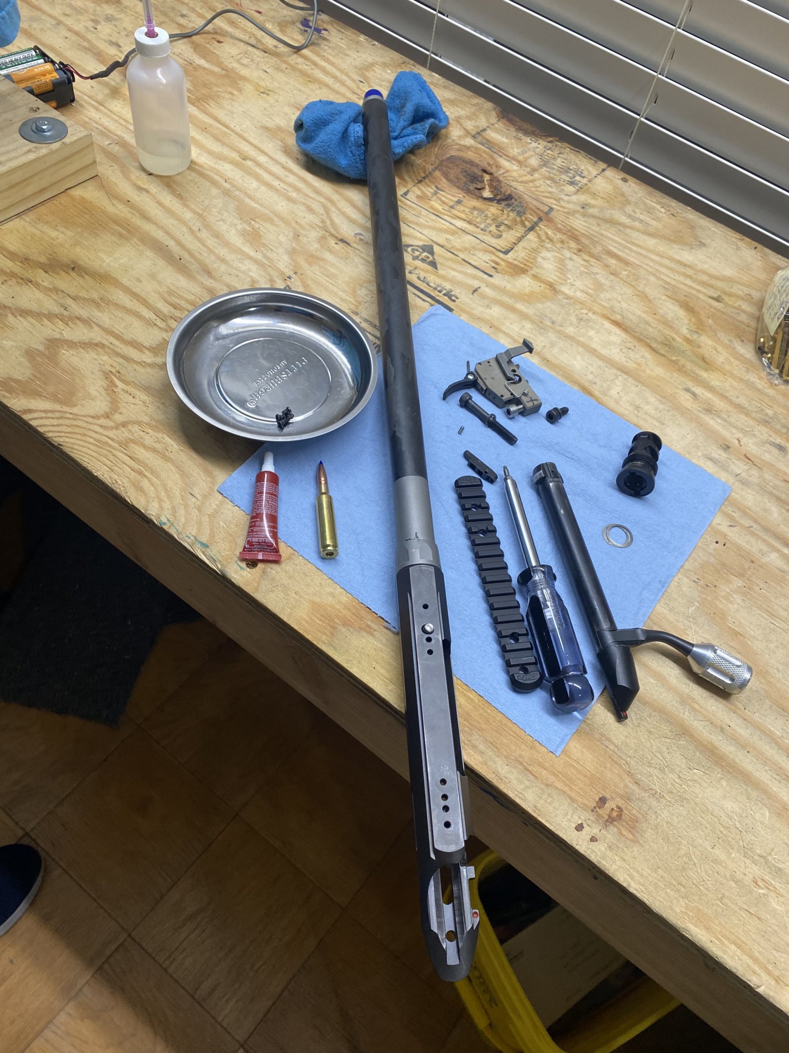

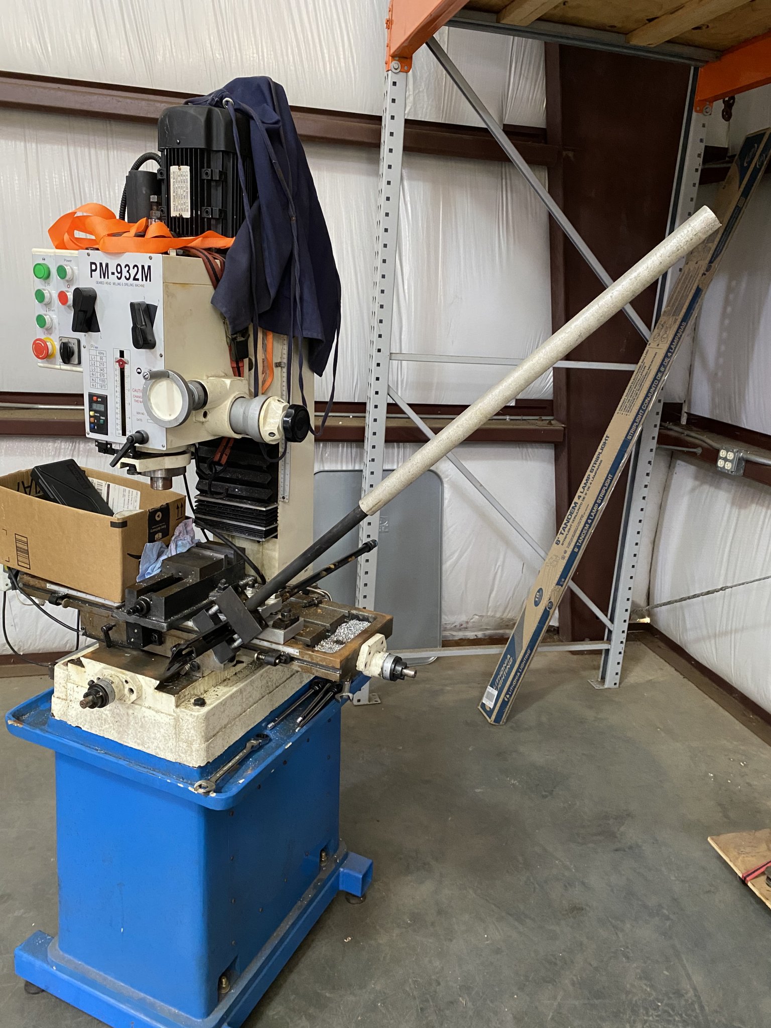

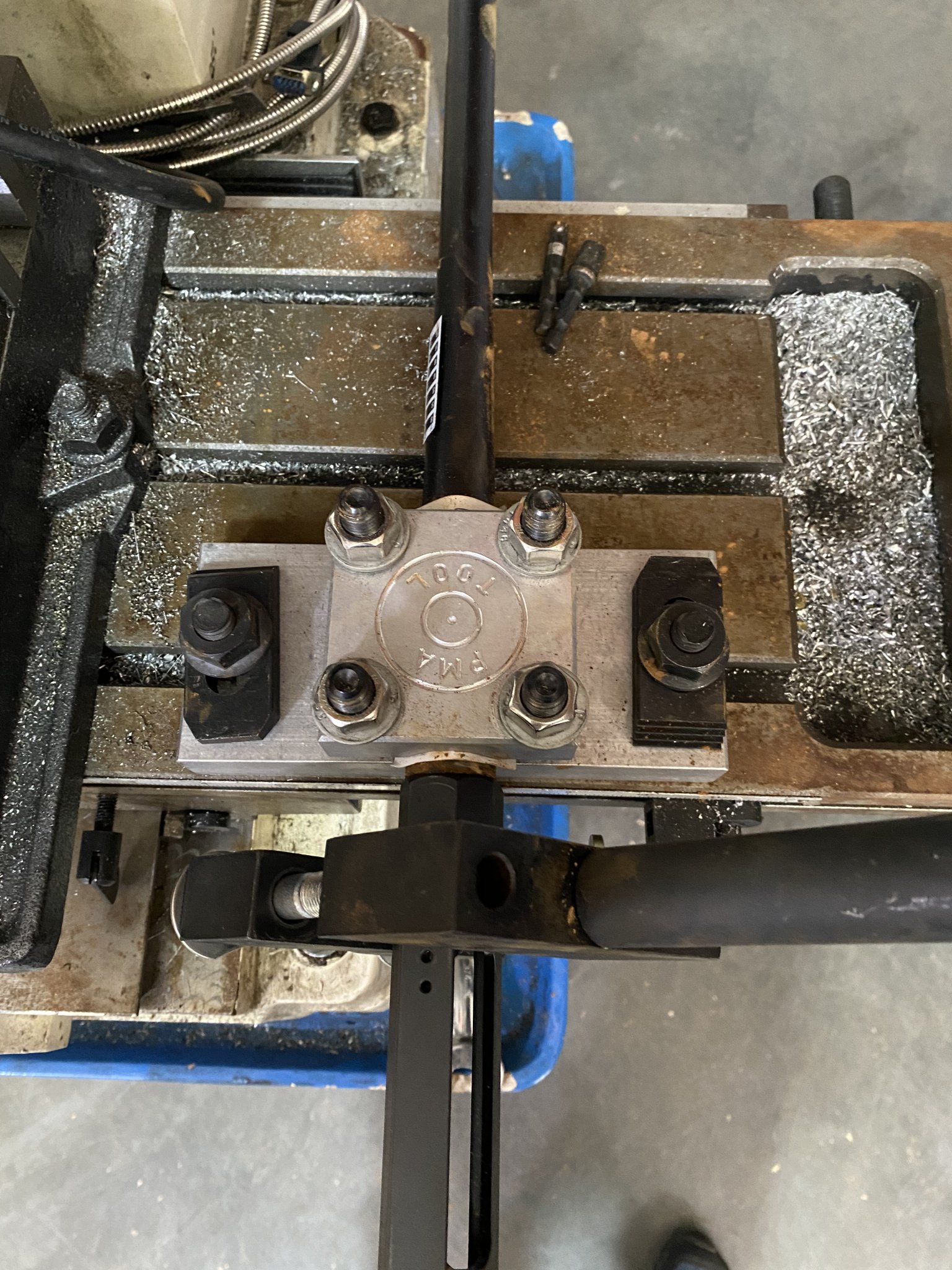

    So the seating die got here last week and the barrel arrived to day - 1 Month and 1 Day after ordering. No complaints about that
    I spent a little on Saturday tearing down the CTR - Optic, rail, trigger, bolt stop etc. and started the Kroil in the threads.
    Took it to the shop today, bolted the barrel vice onto the table on my milling machine and prepped the barrel with powdered rosin and a couple of business cards in the vice.
    Got the action wrench on the action and tightened the bolts just a bump past finger tight.
    First pull on the handle was a no-go.
    2' of cheater pipe went on the end of the action wrench and a little grunt and off she came. Not as bad as my T3 Lite in .223 but I was fighting to get the barrel clamped tight enough on that skinny tapered barrel.

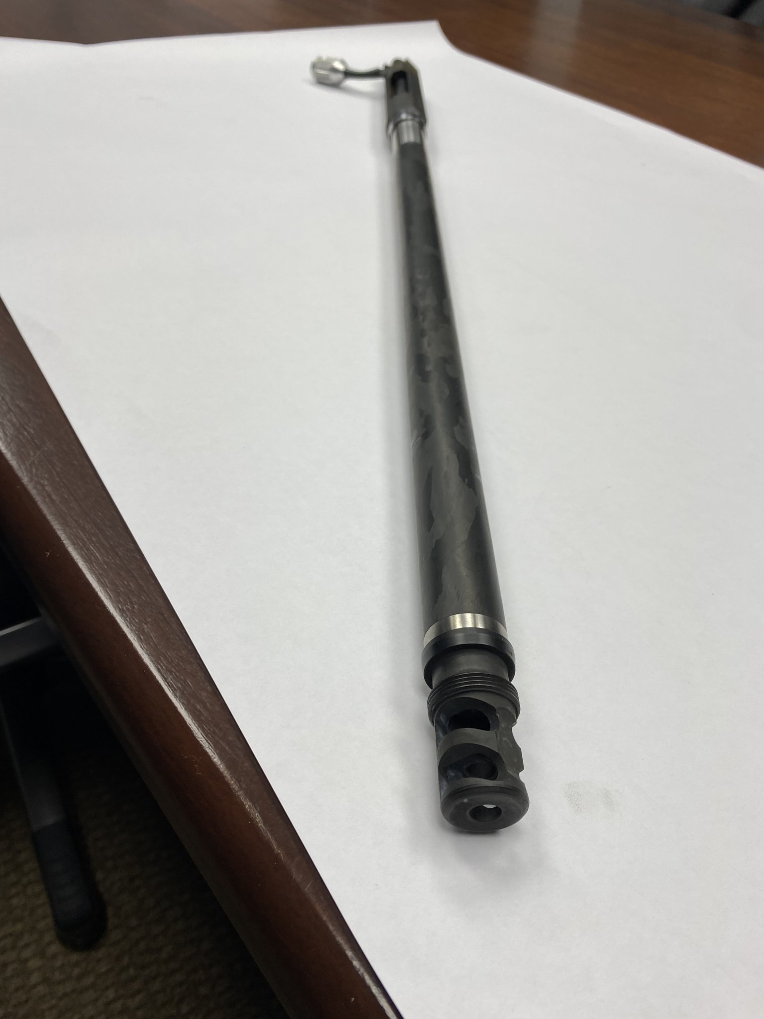

    I cleaned the bore and ran a bore scope from end to end. no glaring issues, just needs to be screwed together and start load development.
    I'll toss the action and the muzzle brakes in the ultrasonic cleaner tomorrow to get them Clean- Clean and then get to work assembling the barrel to the action, setting headspace, etc.

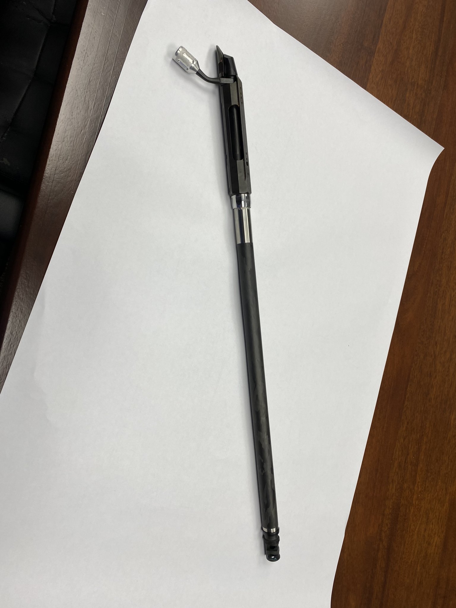

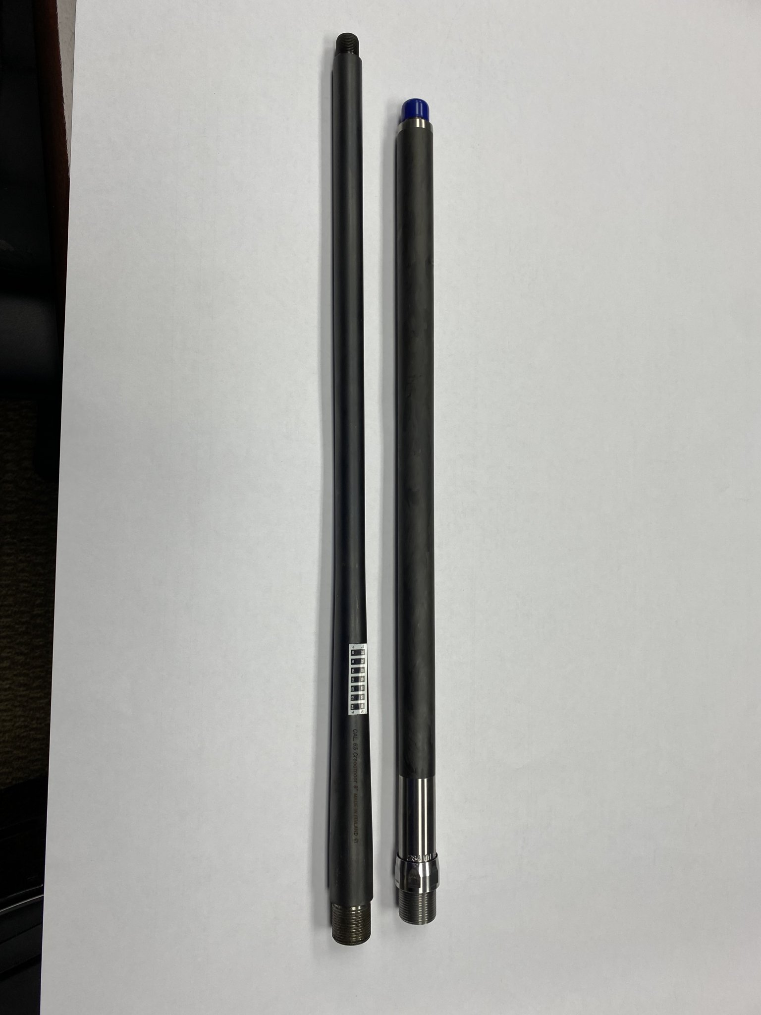

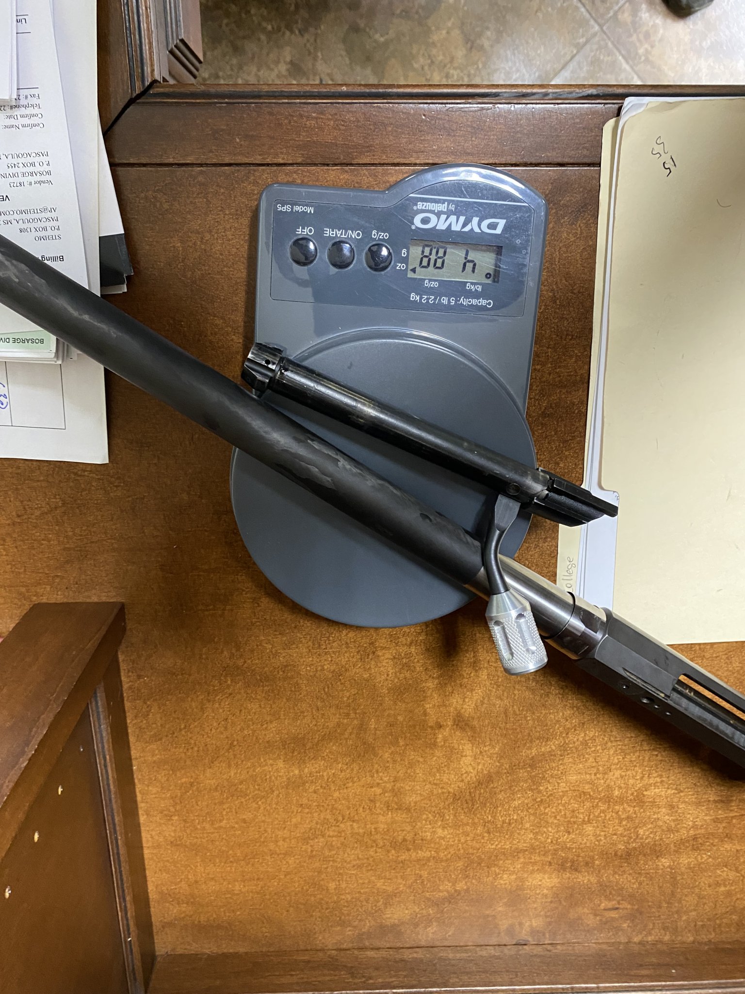

    The new CF wrapped barrel is 2 lbs. 9 oz.
    The OEM CTR 24" Carbon Steel Barrel is 3lbs. 7 oz. 14 oz. weight savings there.
    The barreled action should be sub 5 lbs. with a trigger, etc.

    OK, Progress report:
    Masked the barrel and gave it a trip thru the glass bead blast cabinet to knock the shiny off of the exposed metal.
    Cleaned the action and put the barrel on, adjusted head space and locktighted the barrel nut in position to make it as "Switchbarrel" as possible.

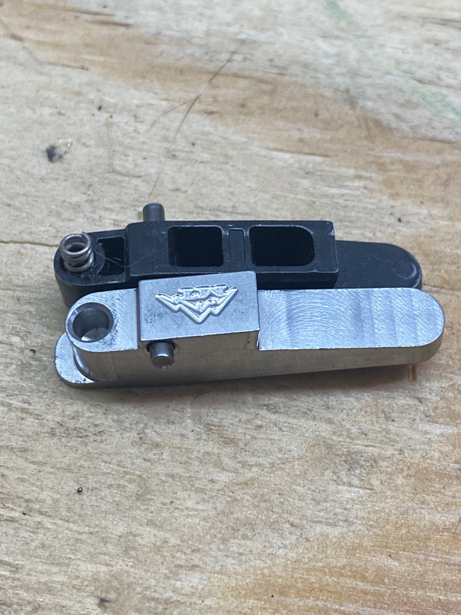

    Put the Area 419 20MOA rail on, the KRG Midas trigger and the Mountain Tactical bolt stop in the action and put it in the ACC Chassis for barrel break in and accuracy testing / load development.
    Post Bead Blast
    Sub 5 Lbs. Barreled action
    All coming together

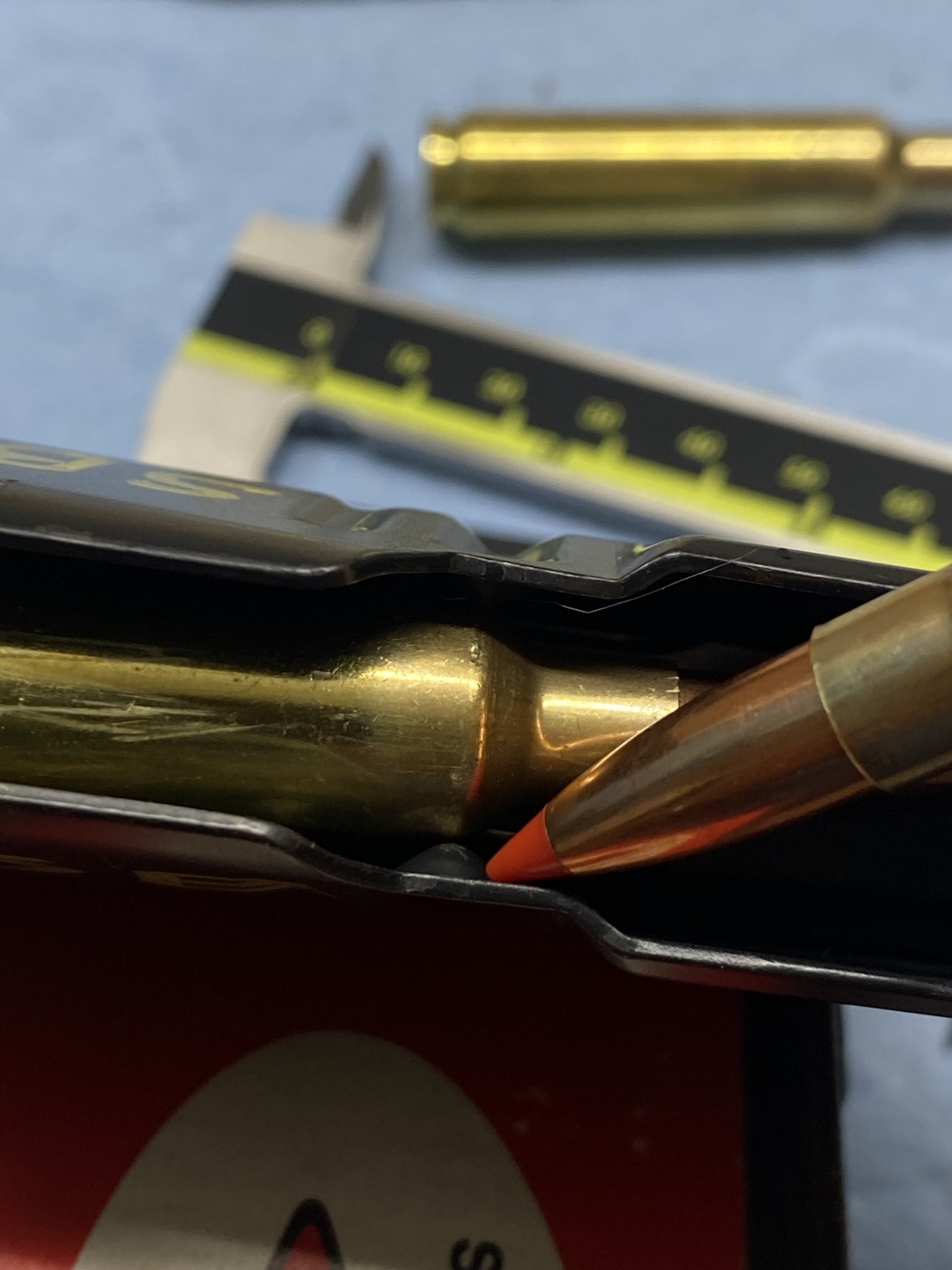

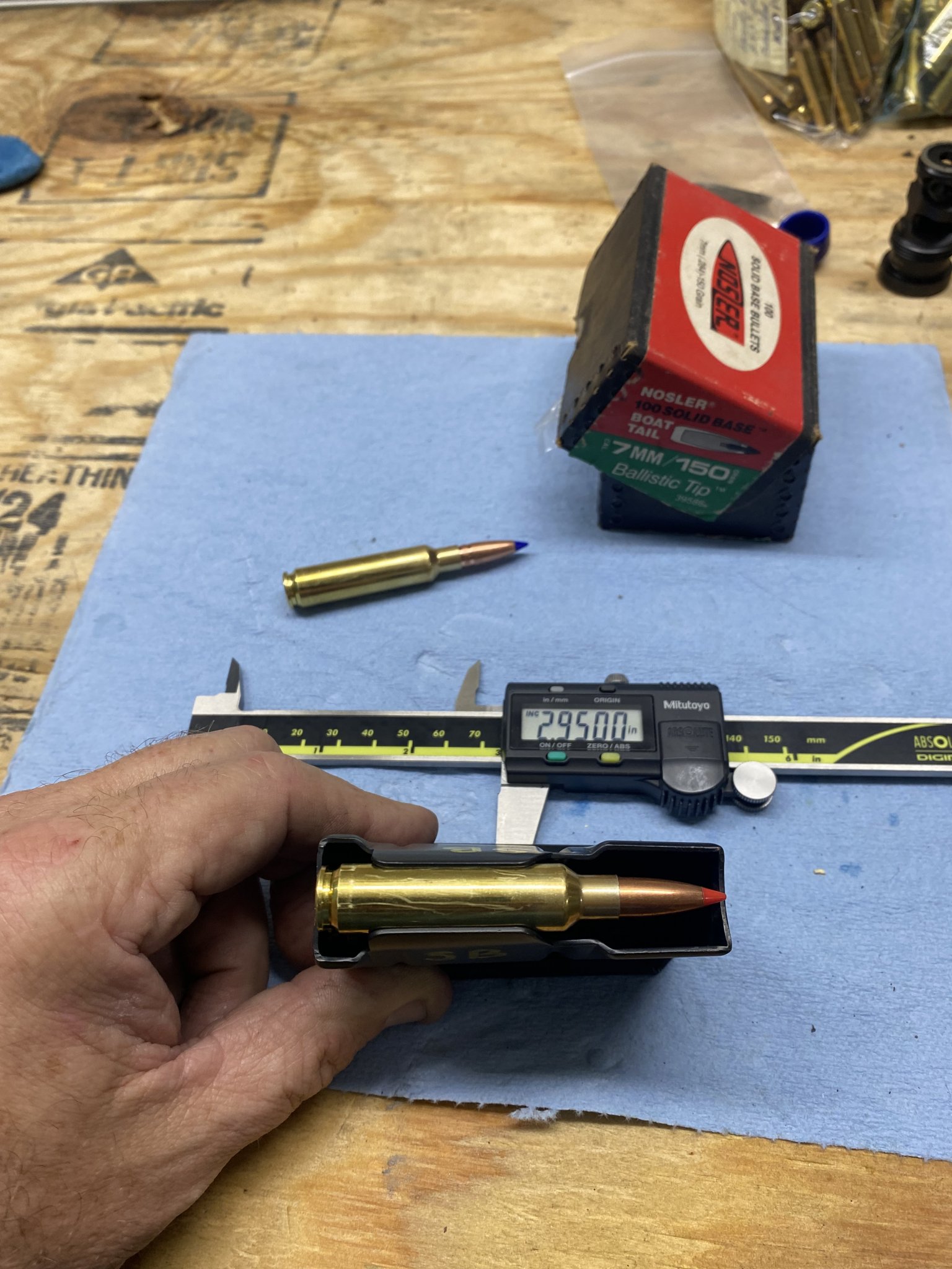

    5 Round MDT "Non Binder Plate" Magazines with dummy rounds loaded to 2.950" Fed and functioned perfectly.
    I ran into an issue with the 10 Round MDT "Non Binder Plate" mags - There is a stiffening rib that interferes with the shoulder on the .284 case.
    If I was worried about 10 round magazines, a little but of grinding would clean up that rib and let the case pass thru unimpeded.
    Not a worry on a Creedmoor or .308 based cartridge, as that rib is in an area that there is no case shoulder in with those rounds. We're outside the normal operating parameters, so no complaints - just putting the info out there for anyone that might need it @MDT_OFFICIAL @MDT_Josh - I tagged you guys in as an FYI is all.

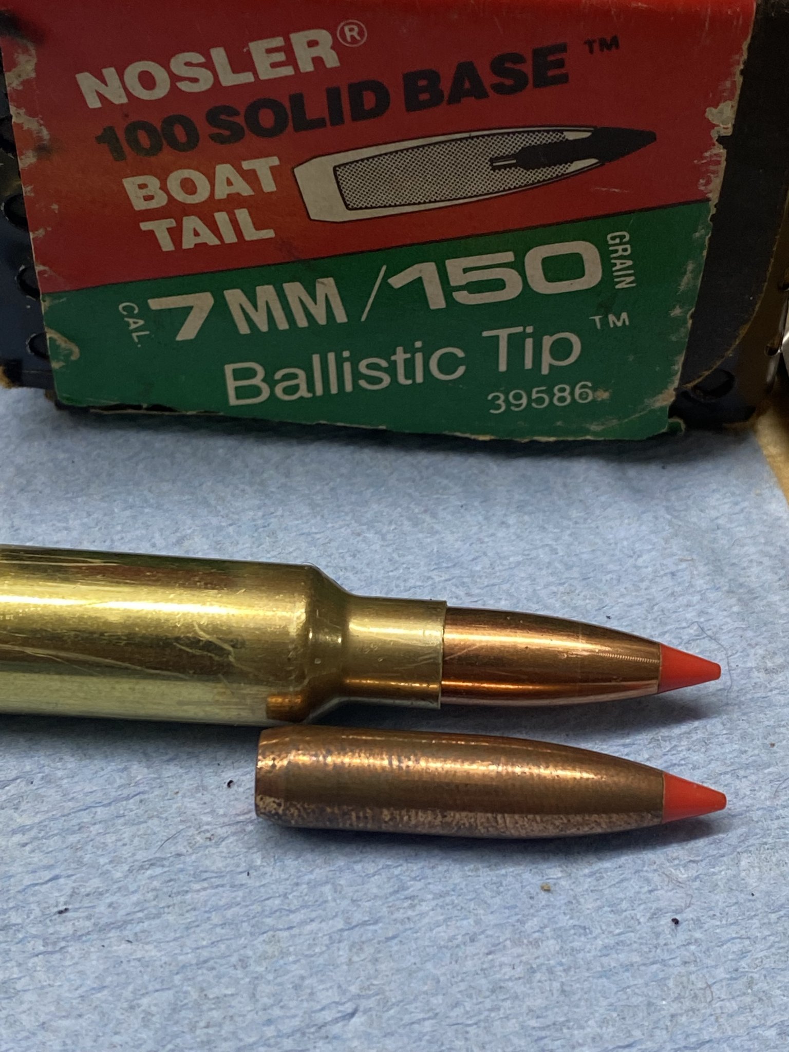

    Looks like more COAL will be a good thing. These are some old 150 Nosler Ballistic Tips and the bullet is definitely taking up powder volume below the neck to shoulder junction.
    Now to get to loading and shooting.
