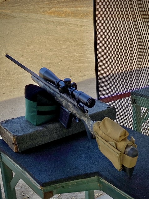

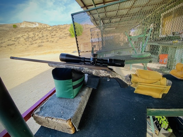

Just got that exact rifle Tikka D-18 in 308, First day at the range yesterday. Really like it.
I was shooting an unbreaked 308 last weekend in a prs match and it had a lot more muzzle rise and recoil

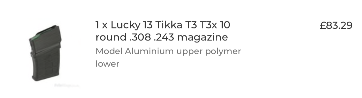

What magazine is that?
ordered it from rifle mags UK
I think the brand is Lucky 13 - from Australia
10 rounds of 308 - expensive but wanted it for range days and matches

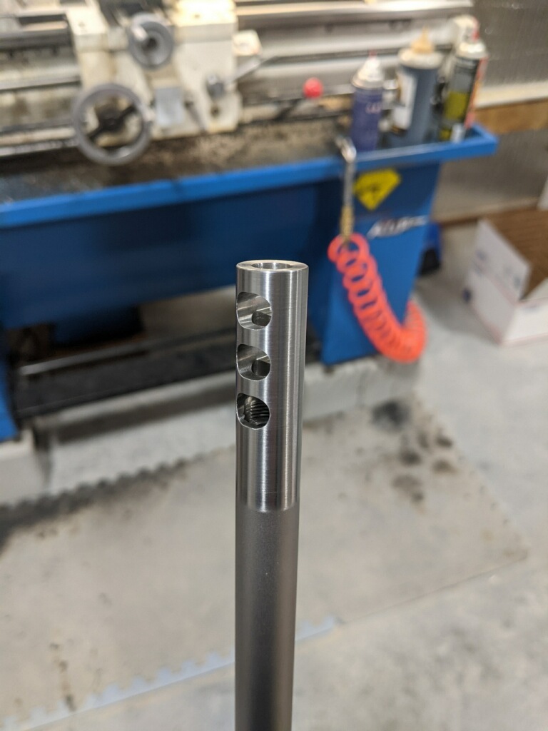

I had my 6.5 lite cut to 18” and threaded 1/2x28. Had an adapter made by the same smith up to 5/8x24.
it’s a handy and deadly little bitch that my kids have adopted.
I am working on another for myself in 308 and 16”. Will go 9/16x24 on this one unless we can squeeze 5/8x24 and still get enough shoulder to seat the can.
