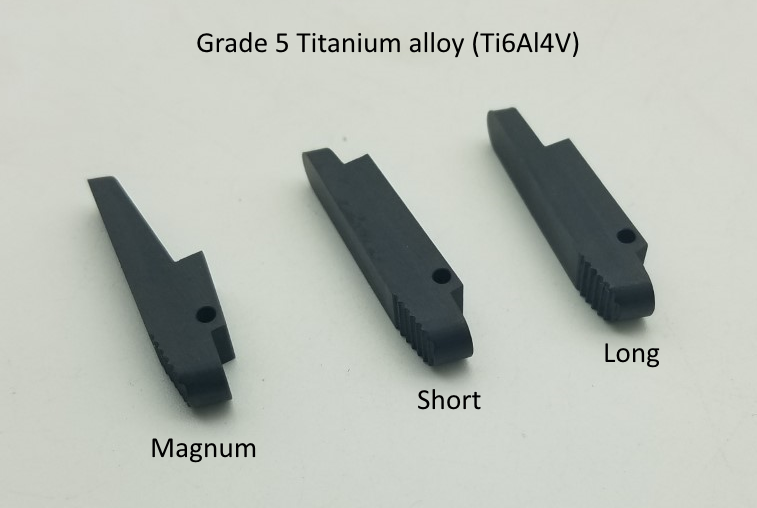

Sorry, I just skimmed your first post while my kids were being, uh, kids. I don’t have firsthand experience with this, just what I’ve read about. But… Tikka actions are the same size, the only difference is the length of the bolt stop(and bolt face diameter, obviously). If you can find a lefty magnum anything you should be able to rebarrel to 6.5 prc. If the actions and bolts are the same length and they only change the bolt stop I don’t imagine the extractor/bottom metal(magazines may be different), or other various small bits would be that specific. But if anyone has better firsthand knowledge of this, definitely listen to them

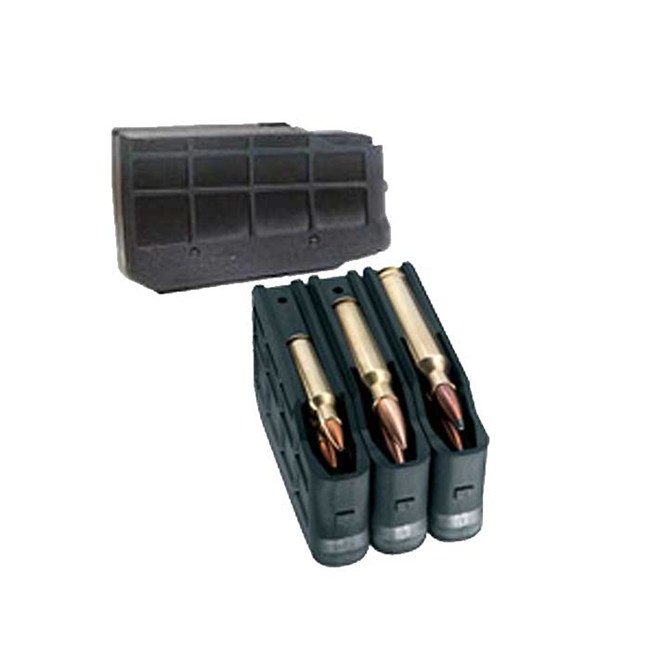

Tikka stocks for factory mags is the same. It’s the mags that change to accommodate the different sizes and not the action. So any tikka with a 300 mag bolt can be made to shoot a 6.5prc just fine.
(Not certain if that still applies to aftermarket aics mags and stocks, I doubt it as aics mags come in different actual lengths)
And the bolt stop is what changes to keep it from going alllll the way back with a 223 when it’s not necessary.

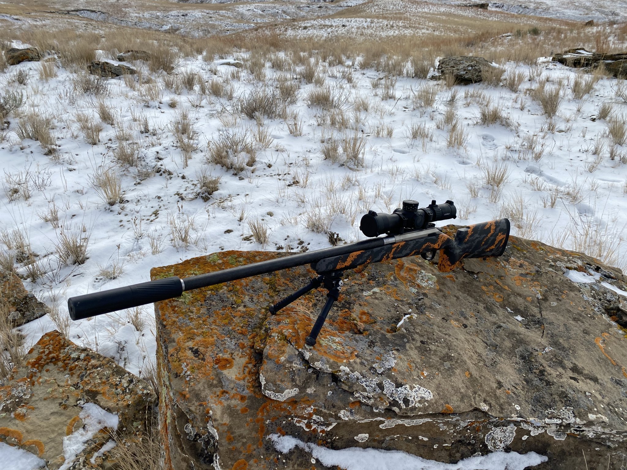

I bought a T3X Lite stainless from a pawn shop in Sheridan WY for $350, screwed on a Proof prefit 6.5PRC barrel using a PVA action wrench, and it’s awesome. I kept the LA bolt stop and mags, it’s worked fine.

thanks, sounds easy peasy!? what caliber was the tikka? what stock did you drop it into? thanks again.

The wsm models have a really short magazine and the bolt stop would need replaced or modified.
I used a tikka that started off as a 7 RM for my 6.5 saum build, the factory magazine was a little tight but the prc isn't as fat so fit will be perfect.
300WM from the factory. I used an AG Alpine Hunter.

wow that looks nice! i'm not seeing tikka options for the alpine hunter, can you say what action and bottom metal inlet options you selected? are you using the "stock" tikka mags and bottom metal? thanks again.

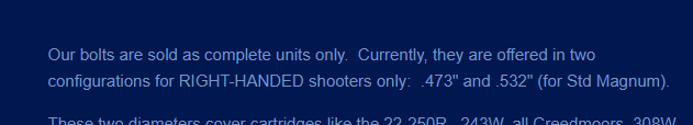

You can look at LRI as they are making some nice Tikka Bolts these days, though not sure about for you wrong handed shooters......
Says right only :(
You have to call in, talk to Pam. The only stock they offer (other than OEM stocks for Mesa and some others) is the Alpine Hunter unless something has changed. The only inlet they offer is for factory DBM. I did eventually get Mountain Tactical BM from the PX here but the factory part worked fine.
thanks for that info, i did see they do tikka after some digging around. what made you pick AG over others such as Mesa, AG does look to be a 1/2 pound heavier.
I could spec my own LOP, color, and sling/bipod mounting. AG makes Mesa’s stock, but I didn’t want the Monte Carlo style rear end.
