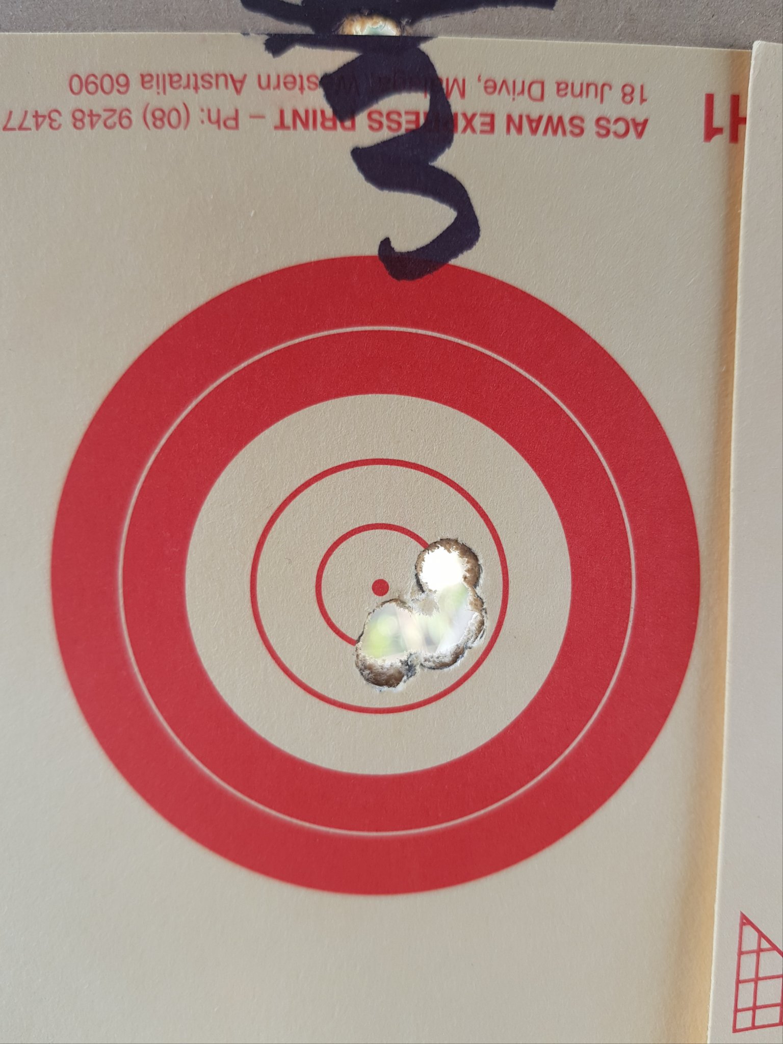

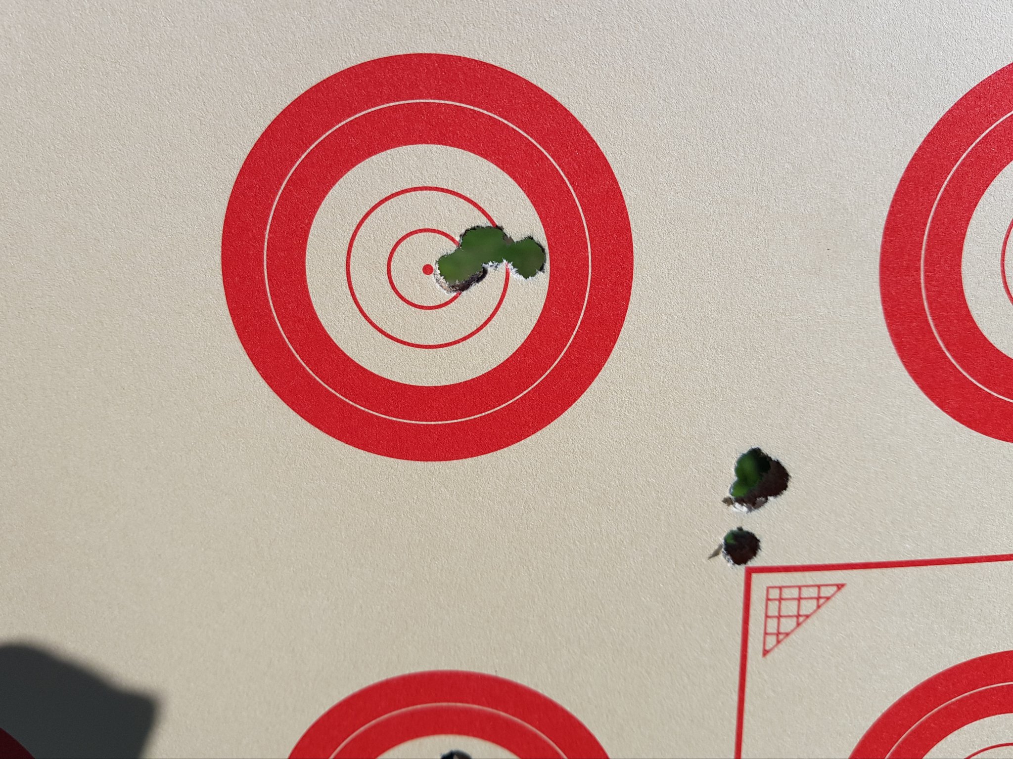

I've found that to be the case comparing my factory tikka 20" ctr in 6.5 creedmoor vs my AI AT with an aftermarket lothar walther 6.5x47 barrel. After load development with the creed i averaged .4 moa.
With the AI 6.5X47 i was already at .4 moa with a generic fireforming load. Both shooting lapua 123 scenar. Have yet do do load dev on the x47 barrel but it will only improve from there.
Having said this, the factory tikka ctr is no slouch. Question is weather you can shoot as well as the rifle.
Not a completely apples to apples comparison with factory vs custom barrel but it's quite similar situation to what your considering.
Generic fireforming 6.5x47 loads (2 group of 5) vs 5 round tikka ctr after load dev. Both shot at 100m

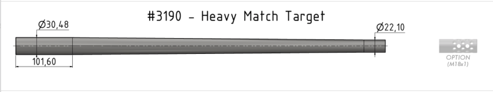

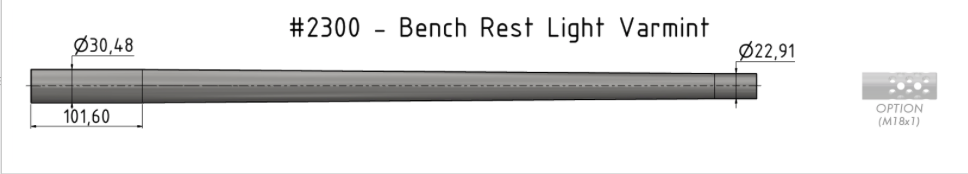

Now for the barrel, if I look at the Lothar Walther configurator I'm probably going with a 26" 1/8 twist. Two contours seem to match my needs: "Heavy Match Target" or "Bench Rest Light Varmint" which have a muzzle brake option and seem to be pretty much similar except the slight difference in taper.
