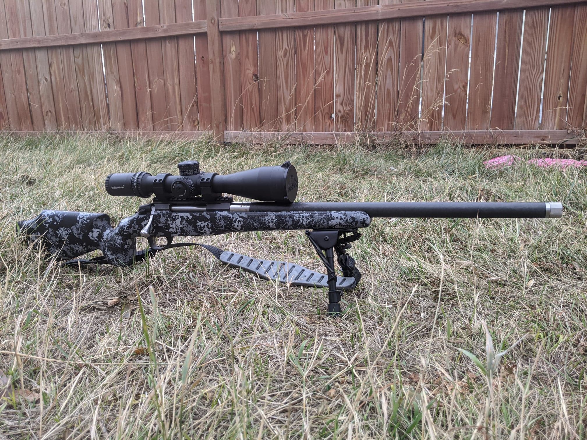

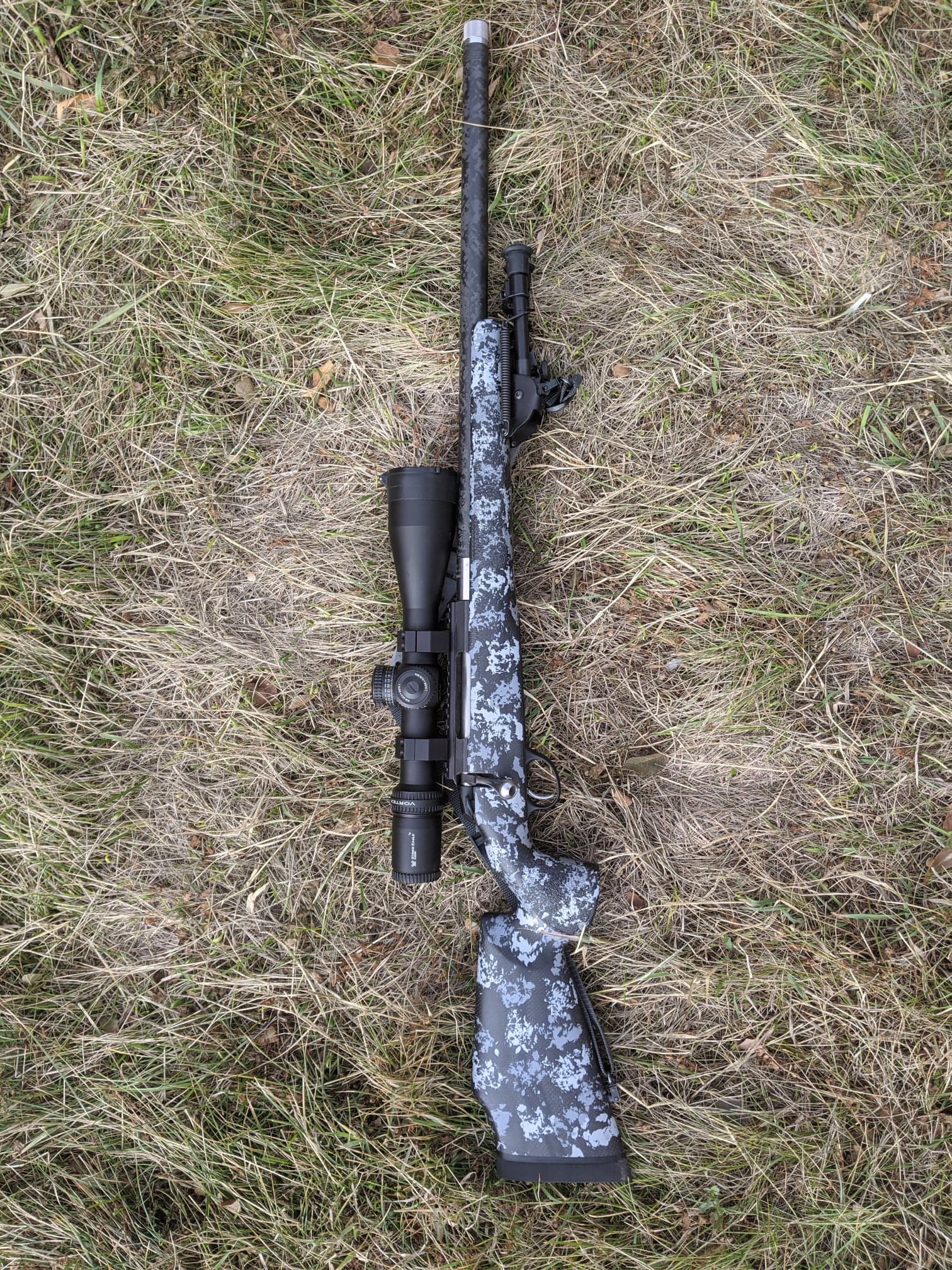

Thanks for the replies gentlemen. Sorry it took me awhile to respond back. I ended up ordering a 22" proof research carbon fiber for 6.5 creedmoor. As for removing the barrel, I have a few ideas, hopefully one will work. Once I get my parts I'll post the process and results for anyone interested in doing it themselves.

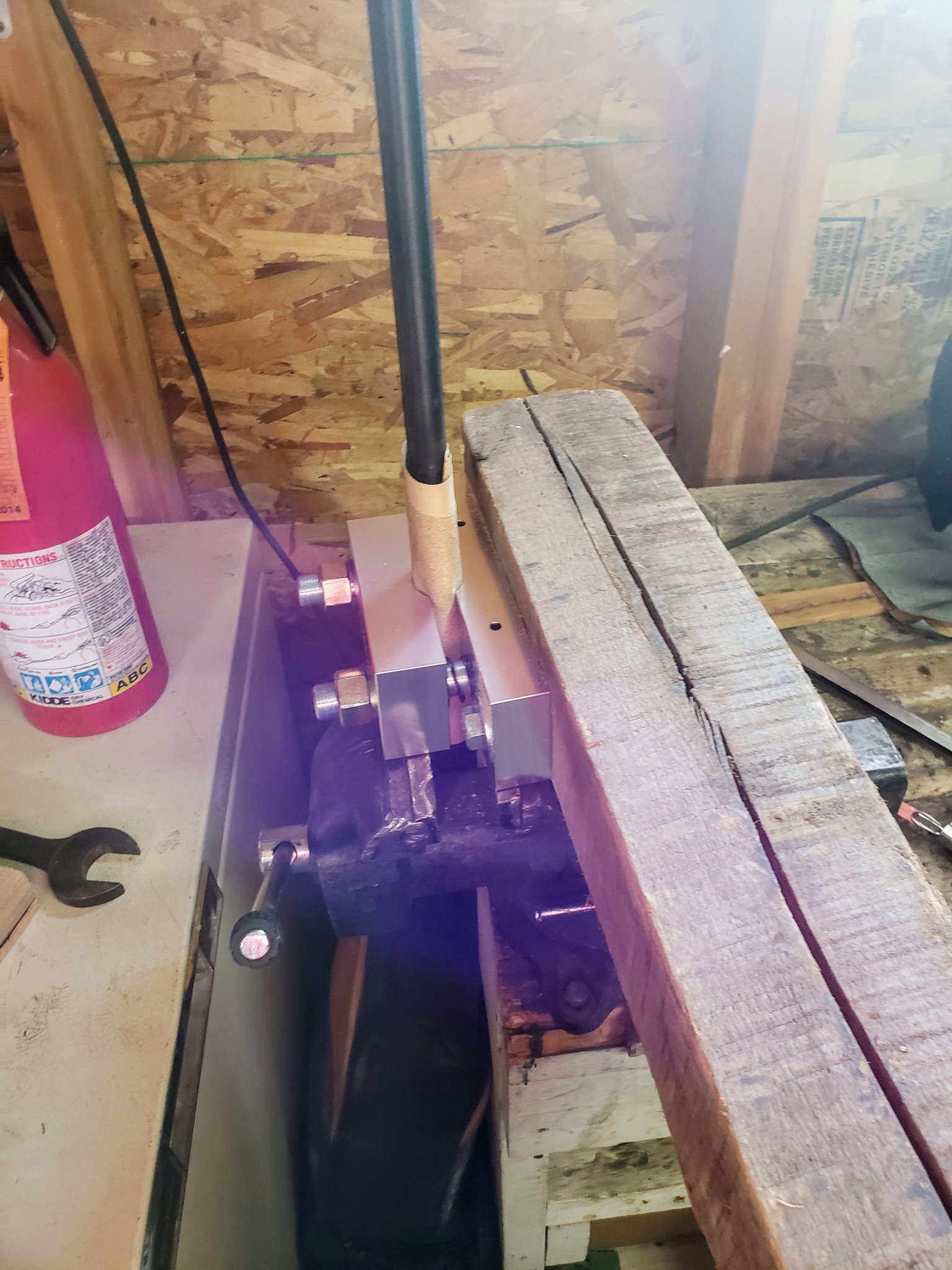

For whoever's interested in this. I yanked the barrel yesterday. I had no desire to save the barrel so I put in a relief cut with a hacksaw, cranked the vise tight, and a good yank popped it right off.
Mind if I ask what barrel vise that is?
I'm in the same boat, have a carbon barrel coming for my Tikka 6.5 Creed, but it's a carbonsix. I may want to give a try saving the factory barrel, but am certainly not going to sweat it if it comes down to it.
It's a bald eagle barrel vise from grizzley industrial. https://www.grizzly.com/products/Bald-Eagle-Precision-CNC-Machined-Barrel-Vise/BE1127
It seemed like a cheaper option that would meet my needs. I also looked at the viper bench vise and brownells barrel vise, which both seem to have great reviews. However, since I was already determined to sacrifice the barrel I chose to buy little cheaper vise. To be honest it worked great, I didn't have any trouble with slipping when I cranked down, either taking the old barrel off for putting the new one on.
When I removed the barrel I put it in a bench vise with the reciever slightly below the jaws, i took a hacksaw (no lathe 😔) and I put a 1/16th inch relief cut the whole way around. I put the barrel vise on a 4x4 strapped it to the barrel, and used it like a 3 foot long wrench. It popped free with only a little bit of pressure.
